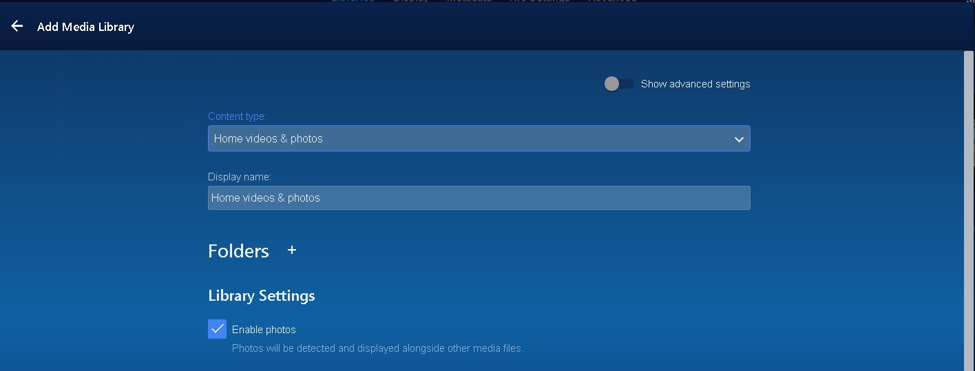

Happy2Play 9803 Posted October 13, 2018 Posted October 13, 2018 I believe there was a change to this awhile ago and you have to enable Photos in Home Videos and Photos.

Luke 42213 Posted October 13, 2018 Posted October 13, 2018 You should use the home videos content type.

happpyg 20 Posted October 13, 2018 Author Posted October 13, 2018 Hi Guys, I just did the same test with a Library set to Home Videos & Photos and it still does the same thing, am I missing something? Thanks
Luke 42213 Posted October 13, 2018 Posted October 13, 2018 Please try again with the next release of Emby Server. Thanks.
