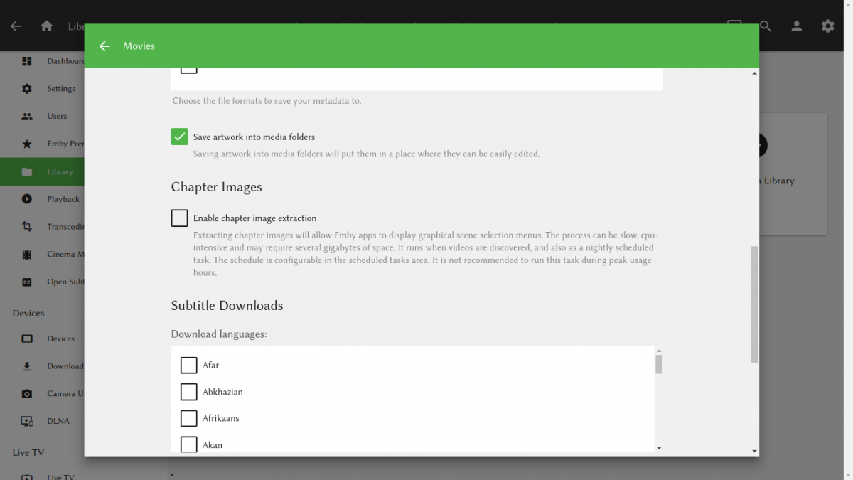

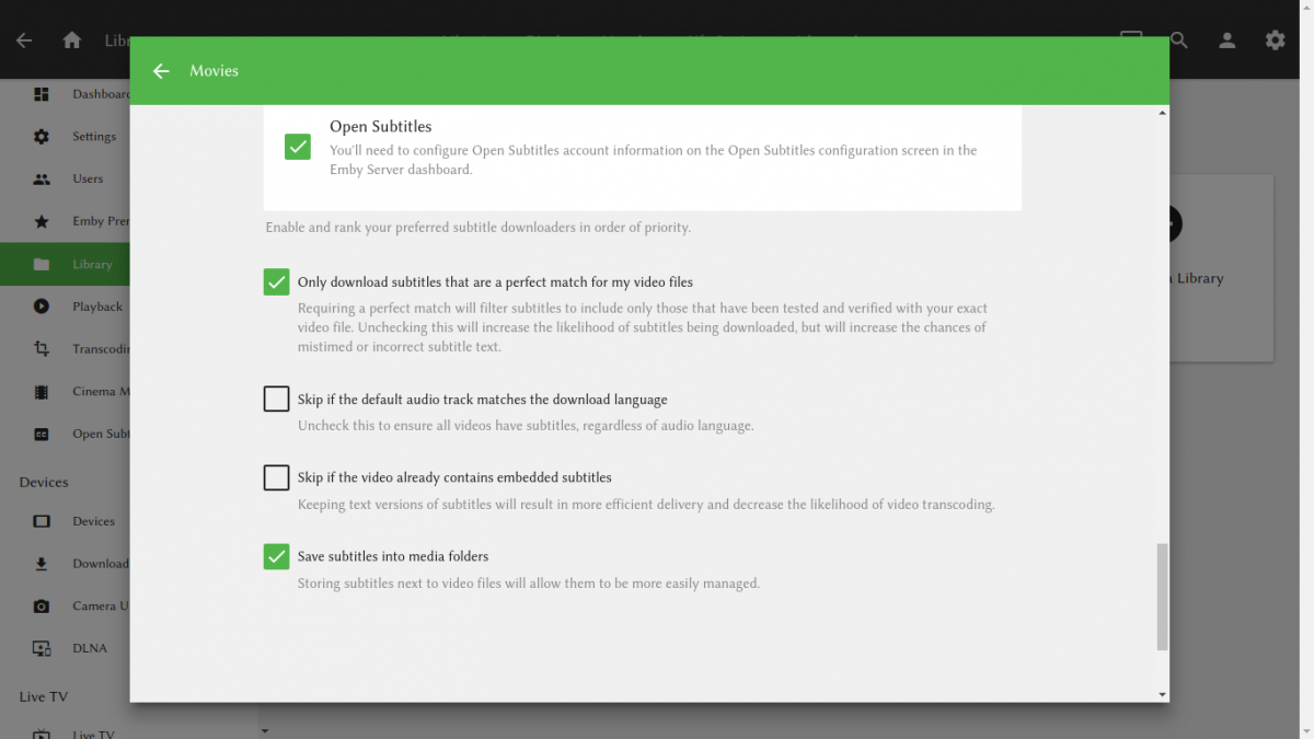

danilodiorio 0 Posted October 12, 2018 Posted October 12, 2018 Hello guys, Just changed to arch linux and installed emby-server from pacman. But I having a problem, even with the configuration set correct I think. The subtiltles are being saved on /var/lib What should I do, so my subtiltes got stored with my videos?
Luke 42246 Posted October 12, 2018 Posted October 12, 2018 Make sure the server has write access to your media folders. If it does not then it will be saved to the server's data folder. Thanks.
