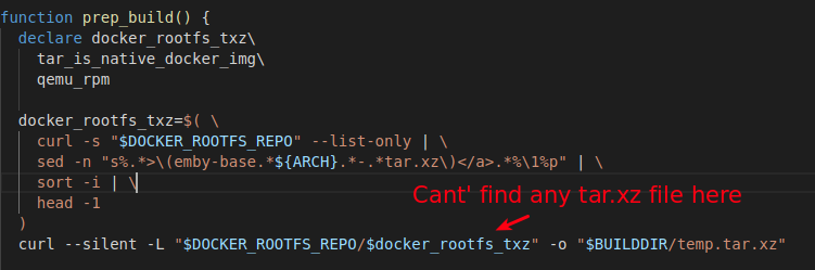

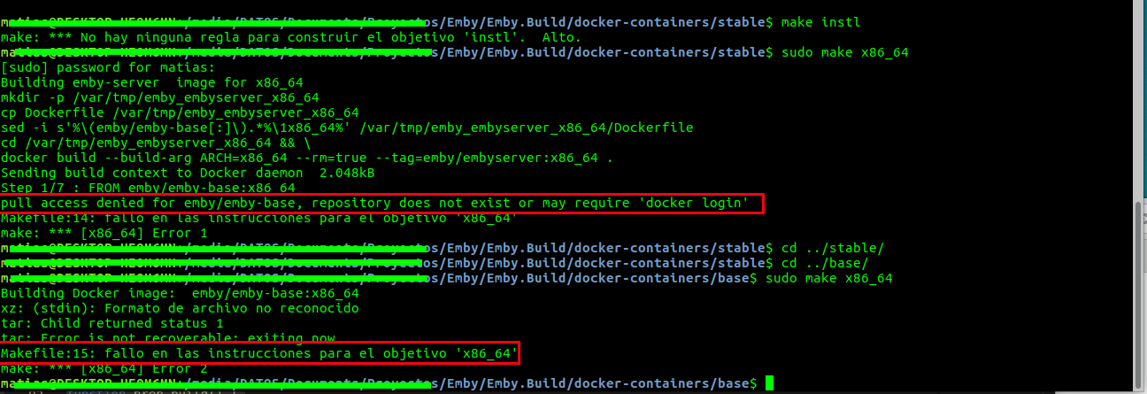

alejmatias 0 Posted October 12, 2018 Posted October 12, 2018 Hi to all First of all excuse my english. I'm trying to install Emby from github following instrucions in https://github.com/MediaBrowser/Emby.Build But when I run "make instl" console throws "no rule to make target" message. Found out "instl" is in another folder, but I'm not sure how to run it. Found "instl" in another folder, but I'm not sure how to run it. Thats my first problem. Second problem turns up when trying to skip the first one failing to buold an emby-base image. Opened "Makefile" in the "stable" flder to understund what it does. So I run "make x86_64" command and asks me for some other images - emby/qemu-register - emby/emby-base I was albe to build emby/qemu-register image, but failed with emby-base. To build emby-base IMage I did: sudo make #cd ./Emby/Emby.Build/docker-containers/base#make x86_64 It throws an error with a compressed file but found that the build.sh script in utils folder can't download a file from http://download.opensuse.org/repositories/home:/emby:/docker/images/ on the pre_build function Thanks in advance for any help
