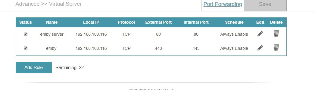

Carlo 4561 Posted October 10, 2018 Posted October 10, 2018 Are you sure you are setting up port forwarding in your router? Routers will almost always allow you to setup multiple different forwards to different IPs. Can you give us a screen shot of the router setup where you are setting these Emby port forwards?
Carlo 4561 Posted October 10, 2018 Posted October 10, 2018 That does not look like the correct place to set forwarding as it's not even asking for the correct information. What router brand is it?
Carlo 4561 Posted October 10, 2018 Posted October 10, 2018 Ahh, dlink, ok. That does look ok. Assuming your external IP is 100.100.100.100 With your current setup what happens when you open http://100.100.100.100 from a browser inside your network? Obviously use your real external IP address here.
Carlo 4561 Posted October 10, 2018 Posted October 10, 2018 https://www.manualslib.com/manual/1184667/D-Link-Dir-879.html?page=87#manual dlink might be a tad different. Checkout the link above. This uses the virtual server tab instead of port forwarding. This setting allows you to set both the external and the internal ports. Remove the port forwards and try setting both 80 and 443 or the defaults of 8096 and 8920 back up (adjust emby Advanced menu to match). Does this work?
jstewart72 1 Posted October 10, 2018 Author Posted October 10, 2018 you mean the real ip? the one that would be on the wan access
jstewart72 1 Posted October 10, 2018 Author Posted October 10, 2018 already have the virtual set up as well
Carlo 4561 Posted October 10, 2018 Posted October 10, 2018 (edited) You don't want both setup. Remove the port forwarding and only use the virtual server as a test. If this is working then from inside your network you should be able to open a browser on a computer type http://modemIP and it will open your Emby assuming you are using port 80. http://modemIP should work the same as http://192.168.100.116 for you if the forwarding is working correctly. If not there is something else that needs checking. Do you see now why I said TeamViewer would be the easier way? Any chance you would be up for that? modemIP in that context is your real Internet IP address. Carlo Edited October 10, 2018 by cayars
