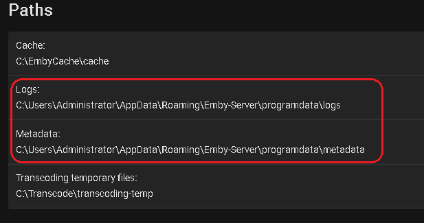

Carlo 4561 Posted July 27, 2020 Posted July 27, 2020 OK, now in Web admin on the dashboard menu choice scroll down to the bottom of the page. You'll see a few paths listed one of which is logs and one is metadata. On windows it will look similar to this: What we want is the path the the programdata folder so for me C:\Users\Administrator\AppData\Roaming\Emby-Server\programdata\ Now for me when I navigate to that location I have a folder called plugins it is this folder plugins that you would copy the DLL to then restart Emby Server. Try and follow that logic for Docker and let's see how close a match this is.
superloopy 1 Posted July 27, 2020 Posted July 27, 2020 Followed, thanks!Sent from my CLT-L09 using Tapatalk
