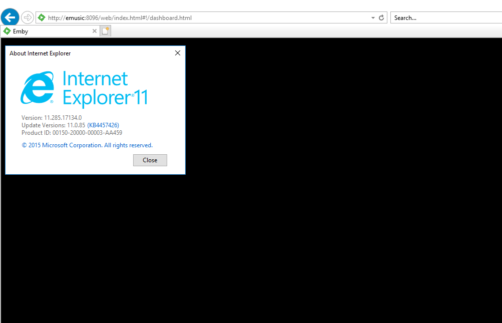

Happy2Play 9840 Posted October 10, 2018 Posted October 10, 2018 (edited) @@Luke I get the same thing when using hostname:8096 (win10 v1709, new IE then listed above), but if you use lanip:8096 it works. No issues on WHS2011 with IE (older version than listed above). @@YondaimeCBWhat OS are you having issues with IE 11, most of my Windows 10 machines no longer have IE on them? Edited October 10, 2018 by Happy2Play

Solution Happy2Play 9840 Posted October 11, 2018 Solution Posted October 11, 2018 (edited) Actually it look like it is do to Compatibility View. Once I unchecked "Display intranet site in Compatibility View" Emby loaded without issue Console showed this http://server:8096/ is running in Compatibility View because 'Display intranet sites in Compatibility View' is checked. This test was on Window 10. Edited October 11, 2018 by Happy2Play 1

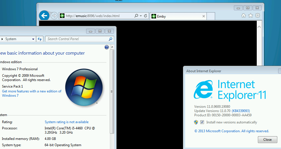

Happy2Play 9840 Posted October 11, 2018 Posted October 11, 2018 @@Luke Don't know if it means anything but this is the error with compatibility view enabled. Tested on Windows 7 also and Emby loads once setting is unchecked.
