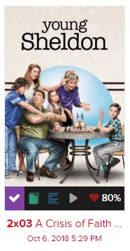

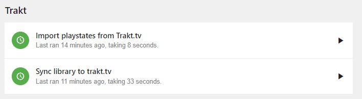

Bazzu85 22 Posted October 7, 2018 Posted October 7, 2018 (edited) Hi, as in screenshot I have a episode watched but not collected on trakt.. running the scheduled tasks not working.. ideas? I attach a log.. Log 20181007.txt Edited October 7, 2018 by Bazzu85
Bazzu85 22 Posted October 7, 2018 Author Posted October 7, 2018 update: I added a movie and runned the tasks.. on trakt results as collected with date and time of collection.. the episode posted above are in collection tab, now (after a while) with collected on but without date/time..

Bazzu85 22 Posted October 9, 2018 Author Posted October 9, 2018 ITIS galileo is a movie not present on tvdb and trakt so i know there isn't found and collected . I think there was problem on trakt side because young sheldon episode 2x3 now is showed as collected but without date and time.. Is not a big issue because the next media added to emby server is correctly marked as collected on trakt..

Bazzu85 22 Posted October 9, 2018 Author Posted October 9, 2018 Maybe no issue on the trakt side, but it could be an issue in your metadata if it is missing information that is needed to identify it. the metadata for the episode were correct.. There were some issues on Trakt's side on 7th October ( http://status.trakt.tv/ ) The fact it's marked as collected but without date and time is strange, I didn't think that was possible. If it's an issue now or in the future, just send the debug log and I'll have a look. I watched now and the episode is marked as collected with date and time.. maybe because the trakt issues, showing me some wrong information about the episode.. the strange think was that the episode was in the "collection" section on trakt, but without the "collected" flag on.. but for close the argoment, the problem now is NOT present.. thx both for watching on my problem..
