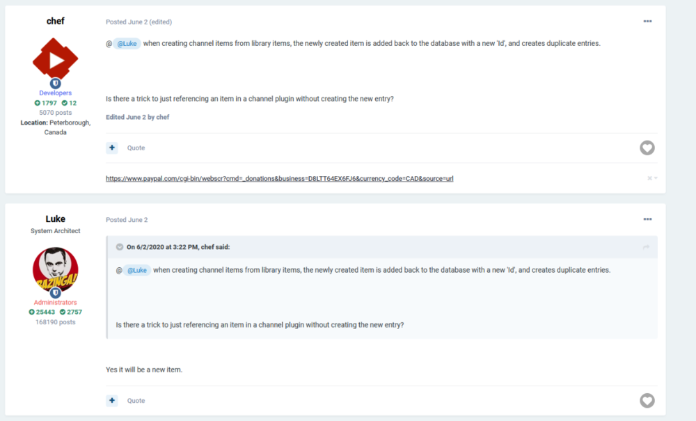

chef 3811 Posted December 7, 2020 Posted December 7, 2020 this was the issue I came across. I couldn't figure out how to point to an item in the database in my channel, I had to create the item in my channel, which would create a new entry and a duplicate item.
Carlo 4561 Posted December 7, 2020 Posted December 7, 2020 Yea, you shouldn't have to do that as it causes dupes in the DB. I get the fact there might not have been an alternative however. @chef By any chance did you try a type other than 8 for the new records? I'm sure you never gave it a thought since other than this plugin what you did would work well. I can't really comment other than working with the DB as I haven't done any Emby plugin dev (yet) but this would be the root of this problem. The automatic group plugin is doing things correctly grouping them if they are marked as movies (type=8). Possible "hack" that could work between the two plugins. You could try doing a DB update for the channels that are type 9 and mark them virtual and see if the channel still works. If so grouping could eliminate the virtual entries from grouping.
