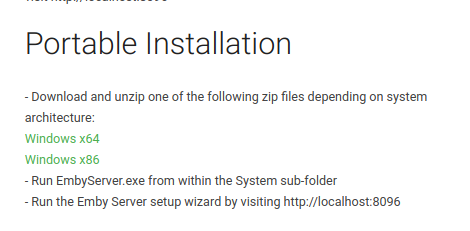

EODCrafter 181 Posted October 4, 2018 Posted October 4, 2018 Hey Guys....On the Download Page Luke has provided the Portable Version....That's what you Need.
Happy2Play 9805 Posted October 4, 2018 Posted October 4, 2018 Hey Guys....On the Download Page Luke has provided the Portable Version....That's what you Need. Portable really applies to Custom install location not movable. There are some changes that have been implemented with but if you are moving to a new location there can be path issues in the database. If no paths change, there shouldn't be any issues with coping folders from one to the other. But Ideally the plugin is the best method as you are building a new database and restoring users and userdata along with previous configuration.
Luke 42213 Posted October 5, 2018 Posted October 5, 2018 There are some changes that have been implemented with but if you are moving to a new location there can be path issues in the database. Depends on how old the installation is. A fresh install of 3.6 can be moved around as much as you like.
