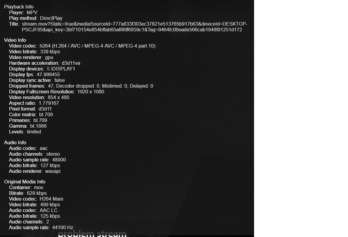

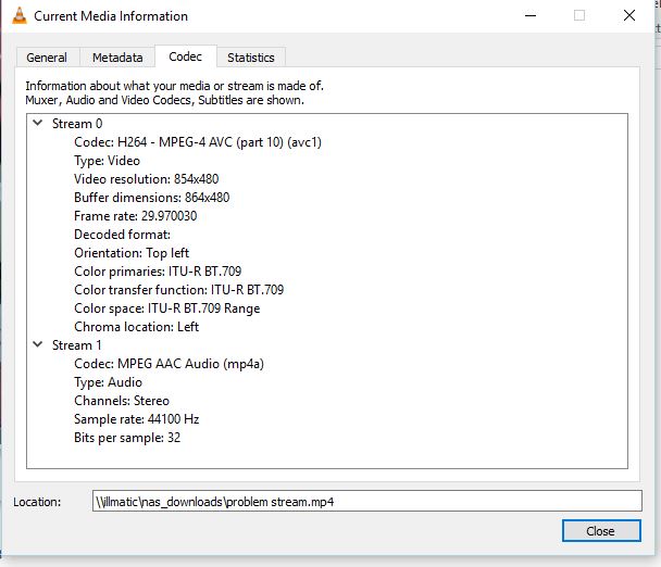

nmkaufman 51 Posted September 29, 2018 Posted September 29, 2018 (edited) So I'll preface this by saying I had this same problem with my original installation, and it was fixed by something having to do with only binding to a particular address or network adapter. My server has two ethernet cards (one physical, one virtual (VPN),) and it had something to do with that. Doesn't seem to be the case, this time, but the symptoms are identical (same files, even.) I'm having trouble streaming seemingly random video files across my home network (across the internet, too.) The videos play fine in the web-interface but stutter (not dropped frames, full-tilt start/stop unwatchable) in Emby for Kodi, Emby Theater (Windows) and the Android app. If i download / sync the same file to the android app first, it plays fine. The video plays fine in VLC across the same network. I've tried disconnecting from my VPN, disabling the 2nd (virtual) network adapter, disabling my antivirus, disabling my firewall. No change at all. I have both codec information and a debugging log from my trying to play a culprit file. I'll start with the codec information first, and if someone wants the log let me know. I forgot to mention, when the files play fine in the web interface, they're still direct stream. No transcoding is happening. If I force transcode in ET / Kodi / Android it plays fine. Edited September 29, 2018 by nmkaufman
nmkaufman 51 Posted September 29, 2018 Author Posted September 29, 2018 (edited) More complete metadata from Emby Theater. Edited September 29, 2018 by nmkaufman

Happy2Play 9802 Posted September 30, 2018 Posted September 30, 2018 Where the screenshots in post 1 and 2 from the same media file? Maybe a frame rate issue.
nmkaufman 51 Posted September 30, 2018 Author Posted September 30, 2018 Yeah my laptop display is 48hz, but the stuttering persists when I have my external monitor attached, and also on my phone. I'll try swapping routers tomorrow, and installing emby theater on my desktop computer, which is on the wired network.
Happy2Play 9802 Posted September 30, 2018 Posted September 30, 2018 Is there a difference in the media info from items that work and don't work?
