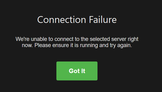

Trelane 38 Posted September 28, 2018 Posted September 28, 2018 Hi, I am running into an issue with Emby Theater (both Desktop and UWP versions). After I add a remote server to my connection list (a server not on the local network), I am only able to connect to it one time. Subsequent attempts to connect using the now saved connection entry fail with "Connection Failure". If I then delete the saved connection, and re-add it, it again works on the intial connection attempt without problem. However any attempt to connect using this again , continues to fail. This only appears to affect Emby Theater, as I have tested this against the FireTV , Roku, and Android versions, all of which work perfectly. One thing to note, I am using a Dynamic DNS entry to connect to the remote server, although this had worked fine in the past and works on every other platform's app I have tested. Also, any local server populates in Emby Theater perfectly, and works on subsequent attempts without issue. Is this a known issue? Anyone else seeing this problem? Thanks

Trelane 38 Posted September 29, 2018 Author Posted September 29, 2018 (edited) Just tested it now to be sure.. Same issue when adding server via IP address. Also tested this against 2 different remote servers, same results. Edited September 29, 2018 by SeanM

Trelane 38 Posted September 29, 2018 Author Posted September 29, 2018 (edited) All connections work perfectly to the server (browser connection, apps, etc). This issue only occurs with Emby Theater, only after its a saved connection, and only if its a remote direct connection. Edited September 29, 2018 by SeanM

Trelane 38 Posted September 29, 2018 Author Posted September 29, 2018 (edited) Yes. If I browse to the remote server via web browser, copy the remote address IP as reported from the dashboard, go to Emby Theatre, add server, paste in remote address, it connects immediately. If I then logout in emby theater which takes me to the saved server list, choose it again, it fails unless I delete it and re-add it again.. This is reproducible every time. Edited September 29, 2018 by SeanM

Trelane 38 Posted October 6, 2018 Author Posted October 6, 2018 (edited) Can you reproduce this with the web version in your chrome browser, http://tv.emby.media ? Thanks. Hi Luke.. Just tried it.. Same symptoms. Initially adding the server and connecting works great. As soon as I logout, attempt to connect again using the saved/cached listing it fails. Deleting the entry and re-adding it works again, rinse , repeat. Edited October 6, 2018 by SeanM
