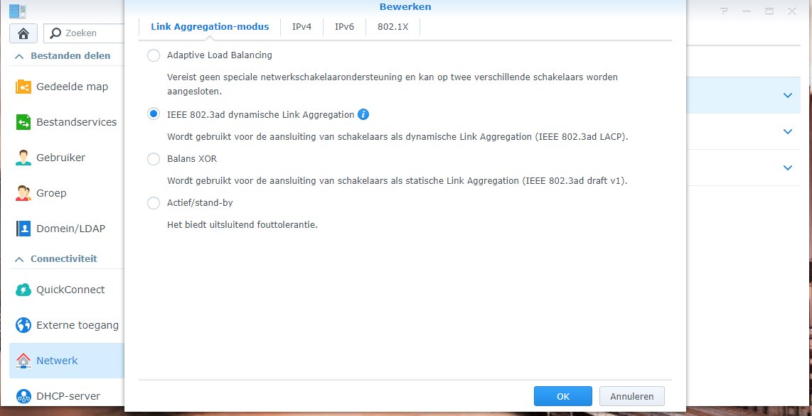

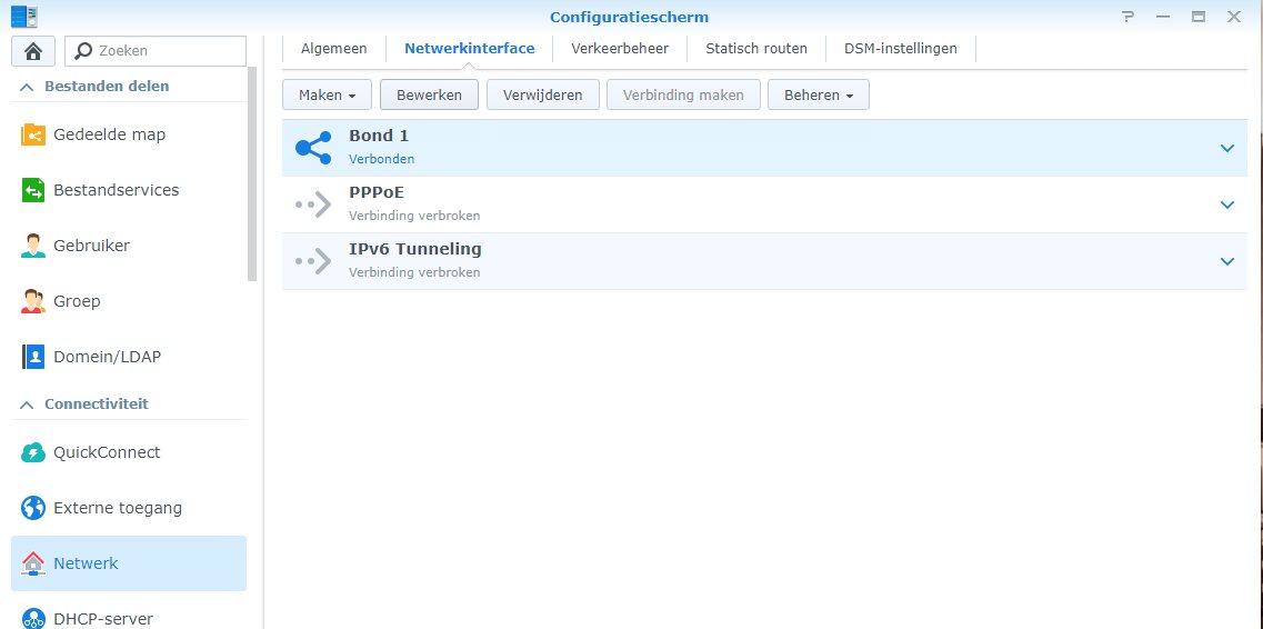

solabc16 379 Posted October 8, 2018 Posted October 8, 2018 Hello @@heula That's interesting, as it still appears to be a problem here. The service is trying to use IPv6 for connectivity and it's failing, which ultimately seems to be bringing down the network stack. From what I've traced through so far, this is the cause of the problems you're seeing. Just to confirm, you've disabled it on all in use interfaces here: DSM -> Control Panel -> Network -> Network Interface -> [id] -> Edit -> IPv6 -> IPv6 Setup -> Off Best - James
heula 192 Posted October 8, 2018 Author Posted October 8, 2018 (edited) That is weird but it is really off. see the images. Edited October 8, 2018 by heula

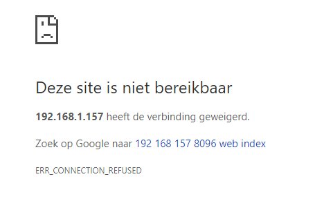

heula 192 Posted October 14, 2018 Author Posted October 14, 2018 Unfortunately today the issue came back. The server was running on my NAS but the dashboard could not be loaded and also in Kodi the "Unable to connect with Emby" message instead of the welcome message. embyserver.txt kodi.log
