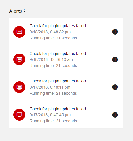

apache07x 1 Posted September 18, 2018 Author Posted September 18, 2018 @@Luke no success yet. Plugins page will just not populate for me. I've tried it on 2 PC's and my phone and all I get is a circle chasing itself. When I click on the exclamation point in the alert this is what I get: in <9f46da0973534d9c8737c50aeebf5ecb>:0 at System.Runtime.CompilerServices.TaskAwaiter.HandleNonSuccessAndDebuggerNotification (System.Threading.Tasks.Task task) [0x00028] in <9f46da0973534d9c8737c50aeebf5ecb>:0 at System.Runtime.CompilerServices.TaskAwaiter.ValidateEnd (System.Threading.Tasks.Task task) [0x00008] in <9f46da0973534d9c8737c50aeebf5ecb>:0 at System.Runtime.CompilerServices.ConfiguredTaskAwaitable`1+ConfiguredTaskAwaiter[TResult].GetResult () [0x00000] in <9f46da0973534d9c8737c50aeebf5ecb>:0 at Emby.Server.Implementations.Updates.InstallationManager+d__48.MoveNext () [0x000c0] in :0 --- End of stack trace from previous location where exception was thrown --- at System.Runtime.ExceptionServices.ExceptionDispatchInfo.Throw () [0x0000c] in <9f46da0973534d9c8737c50aeebf5ecb>:0 at System.Runtime.CompilerServices.TaskAwaiter.ThrowForNonSuccess (System.Threading.Tasks.Task task) [0x0003e] in <9f46da0973534d9c8737c50aeebf5ecb>:0 at System.Runtime.CompilerServices.TaskAwaiter.HandleNonSuccessAndDebuggerNotification (System.Threading.Tasks.Task task) [0x00028] in <9f46da0973534d9c8737c50aeebf5ecb>:0 at System.Runtime.CompilerServices.TaskAwaiter.ValidateEnd (System.Threading.Tasks.Task task) [0x00008] in <9f46da0973534d9c8737c50aeebf5ecb>:0 at System.Runtime.CompilerServices.ConfiguredTaskAwaitable`1+ConfiguredTaskAwaiter[TResult].GetResult () [0x00000] in <9f46da0973534d9c8737c50aeebf5ecb>:0 at Emby.Server.Implementations.Updates.InstallationManager+d__57.MoveNext () [0x000a5] in :0 --- End of stack trace from previous location where exception was thrown --- at System.Runtime.ExceptionServices.ExceptionDispatchInfo.Throw () [0x0000c] in <9f46da0973534d9c8737c50aeebf5ecb>:0 at System.Runtime.CompilerServices.TaskAwaiter.ThrowForNonSuccess (System.Threading.Tasks.Task task) [0x0003e] in <9f46da0973534d9c8737c50aeebf5ecb>:0 at System.Runtime.CompilerServices.TaskAwaiter.HandleNonSuccessAndDebuggerNotification (System.Threading.Tasks.Task task) [0x00028] in <9f46da0973534d9c8737c50aeebf5ecb>:0 at System.Runtime.CompilerServices.TaskAwaiter.ValidateEnd (System.Threading.Tasks.Task task) [0x00008] in <9f46da0973534d9c8737c50aeebf5ecb>:0

ebr 16310 Posted September 19, 2018 Posted September 19, 2018 Please do attach the log but this is almost certainly some sort of local network configuration problem where something is blocking access to our domain (mb3admin.com).

ebr 16310 Posted September 19, 2018 Posted September 19, 2018 As I suspected - looks like network configuration. In fact, it looks like ALL outbound requests are failing to all sites. You need to be sure the application has access to the internet.
apache07x 1 Posted September 19, 2018 Author Posted September 19, 2018 Thanks @@ebr Could that be the router causing that? I probably need to set it up to port forward don't I? Side note I have lan1 going through the router and lan2 going directly to the modem. Might that be a problem too? My thinking in doing that was if the router fails or does something funny I'd have a straight line to the modem. But not sure it actually works like that.
Luke 42213 Posted September 19, 2018 Posted September 19, 2018 It could be a problem, yes. You may also have some kind of security software or firewall that is blocking all communications.
apache07x 1 Posted September 19, 2018 Author Posted September 19, 2018 Ah I do have an antivirus native on the server no firewall that I know of. Could the antivirus cause that?
apache07x 1 Posted September 19, 2018 Author Posted September 19, 2018 Okay I'll start with seeing if there's a way to allow emby to pass through it. If not I will uninstall it. Then if that doesn't help I put a port forward into the router for the nas and emby. I'll let you know if any of it works thanks
Luke 42213 Posted September 19, 2018 Posted September 19, 2018 Port forwarding won't help in this case because that's something you use for inbound communications. What you're having trouble with is outbound.
apache07x 1 Posted September 19, 2018 Author Posted September 19, 2018 (edited) Still not populating the plug ins. I took anti-virus off, switched ports on the LAN lines, unhooked 1 LAN line and port fowarded the NAS and made it static just in case it was changing IP addresses and still nothing. Does seem to be streaming TV now. I believe one of the channels was causing the problem there as it just started doing that once I put all of the channels I wanted on it. So I'll just keep removing channels or start over although I hate to mapping the TV Guide is a pita. Is there a way to do a backup on the guide? But I don't know why it won't connect for the plug ins. Edited September 19, 2018 by apache07x
