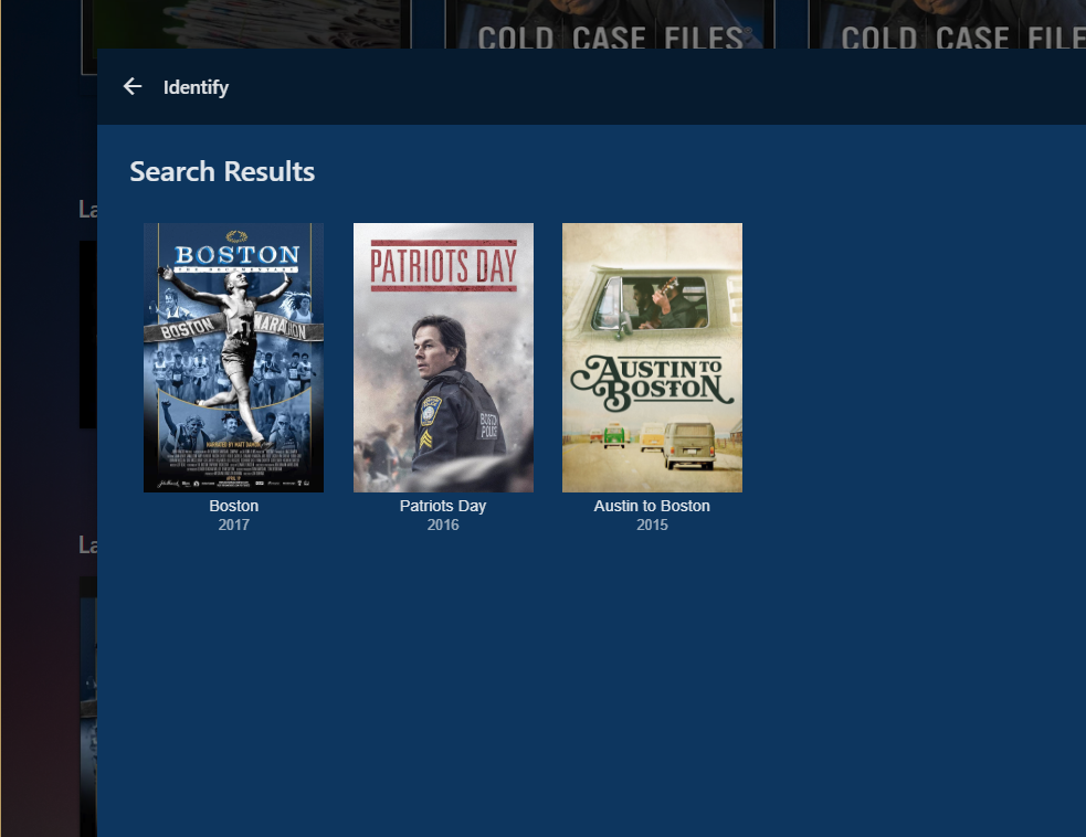

Guest Normal Posted September 12, 2018 Posted September 12, 2018 (edited) I have a movie called Boston from 2016. When scanning my library, emby loads meta data from the internet for a movie called Boston from 2017 instead of the data for my movie from 2016. So I thought maybe Emby can indentify my movie correctly when I put in the meta-data YEAR inside the mkv file itself. And there the only question is: does Emby read this meta data inside the mkv file for loading additional meta data from the internet? It's not a problem what I want to report. I just want to know if emby does the thing asked above. Edited September 12, 2018 by Normal

Guest Normal Posted September 12, 2018 Posted September 12, 2018 (edited) My meta data is correct since long time. This is not the problem. But I thought I ask if Emby reads meta data from the file, just to know. Yes. I tried the Identify feature. "Boston" and "Boston (2016)" gives the wrong (first) result. When I put in the year in the input box it's correct. But, as I said, this is absolute not the problem! I just wanted to know ... let's say I put in "2016" as "Year" in the mkv file for Boston now. Would Emby find the correct result auotmatically? Edited September 12, 2018 by Normal

Guest Normal Posted September 12, 2018 Posted September 12, 2018 If you read from the file name, it's not working. See my screenshot above. "Patriots Day" is called "Boston" where I live. I tried "Boston" and "Boston (2016)". The second one should, if you read from the file name, load up "Patriots Day" but it isn't.
ebr 16310 Posted September 12, 2018 Posted September 12, 2018 Sorry, that is not the primary name listed by the providers we are using and they determine the order of results. If you rename your movie to "Patriot's Day" it will find it as the first one. Or, you can just select it from that identify list.

ebr 16310 Posted September 12, 2018 Posted September 12, 2018 - I asked: when scanning the library with this file name, would emby find the correct entry for "Boston" because of the "year" is given in the FILENAME? No because the name is more important and there is a different movie with a primary name of "Boston" from a very close year (2017). The only solution would be to name the movie "Patriot's Day" or use the identify feature and just select it. Does that make sense?

ebr 16310 Posted September 12, 2018 Posted September 12, 2018 We ARE using the year but the name is much more important. It is much more likely that you got the year wrong than the name so the search results will not be limited to only movies in that year. Also, we are not in control of this search. It is TMDb that is deciding on the best order of results. Given the name you gave it, I think it did the proper thing.
Guest Normal Posted September 12, 2018 Posted September 12, 2018 (edited) Just doubled checked that and used the identify tool again with "Boston" and "2016". Seems like there is an issue in the themoviedb database or whereever these data comes from. The input of 2016 should limit that to movies from 2016 normally (at the end of themoviedb I mean). What makes me think that it's an issue on the site of themoviedb: searching for "Das Dschungelbuch" (the jungle book) gives me many results. Searching for the same movie and adding "1967" for the year gives me exactly what I was looking for. But whatever. It was just a question which learned me 2 things: - I will rename ALL my video files to "Movie name (year).ext) [currently they are like "Movie name.ext"] - sometimes I wish I would be an english man so I could speak and understand ENG easier Edited September 12, 2018 by Normal
ebr 16310 Posted September 12, 2018 Posted September 12, 2018 I think their search is doing the right thing. If you were actually looking for the movie named "Boston" I think you would agree. The only reason this particular movie was a problem for you is because there happened to be a recent movie with that exact name. Had that movie not existed, then the movie you were looking for would have been first too.
