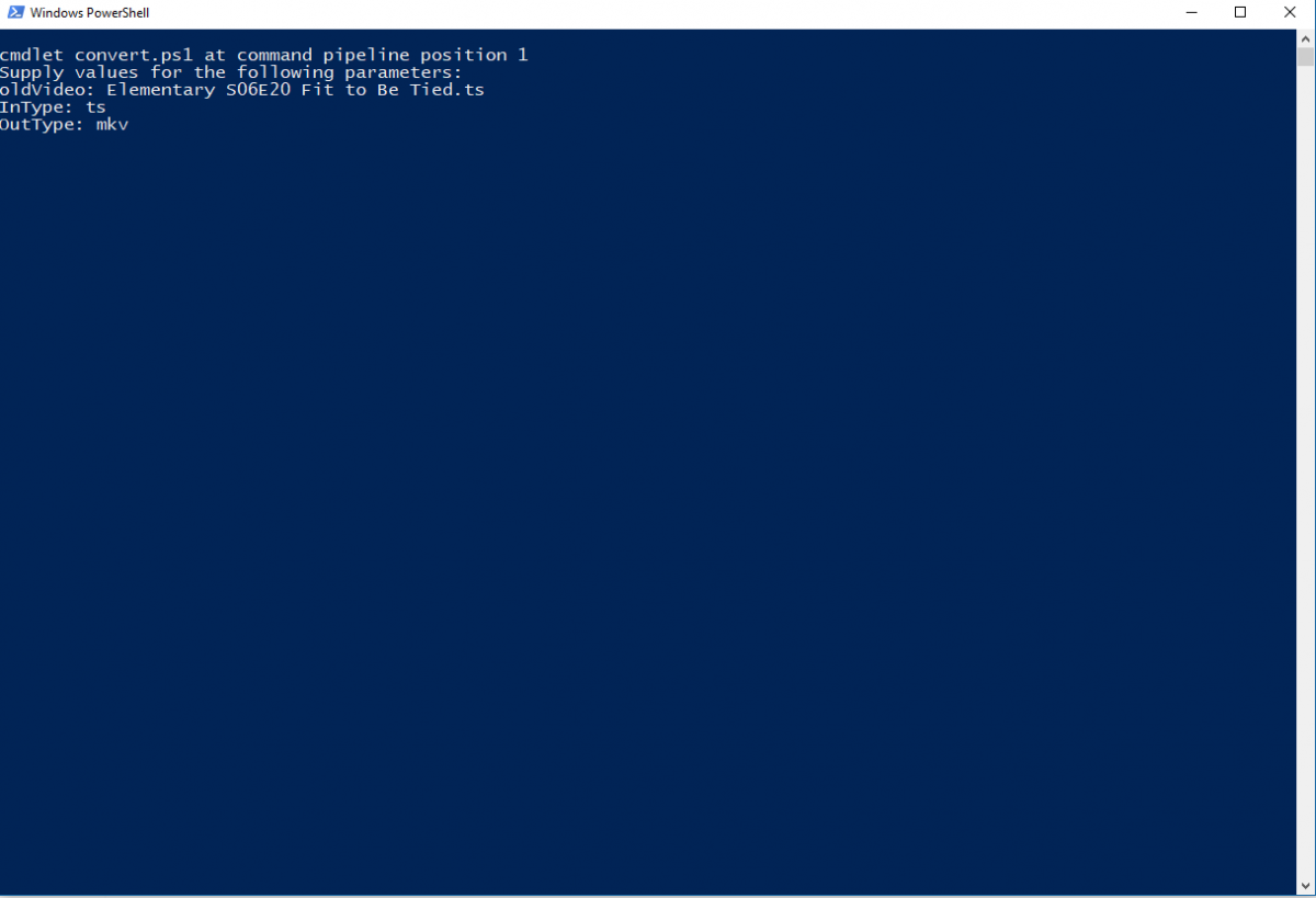

jasonmcroy 320 Posted September 25, 2018 Posted September 25, 2018 Ha. Now I feel even more confused! lol Here is what I did - I went by your instructions and created the ps1 script in the same folder where I have ffmpeg and copied your script into the ps1 file and changed the ffmpeg path. I then copied a test video file into that same folder. Then I right clicked on the ps1 script which then opens up powershell. Powershell then asks me to input the file name for the video so did and hit enter. Then it asked for the in type so I put ts and then it asked for out type and I put mkv and hit enter. It does something, closes then puts out that log file I uploaded to you. I hope your not laughing at me because I barely know what I am doing but I can follow directions normally. But outside of what you tell me to do I don't have any additional knowledge. Totally willing and excited to learn though! Here is a screen shot of the powershell window up to the last command it asks me for before it does it's thing:
PenkethBoy 2068 Posted September 25, 2018 Author Posted September 25, 2018 ok - you are not following what we said open a console window for powershell - its on your start menu - windows powershell > windows powershell with the window open (blue as in you screen shot) now change the directory to the directory that has the ps1 file in it - as you would in any command window as it will by default start in windows\system32 then you can do the following .\embyPP.ps1 -oldvideo "<full path to the video file inside double quotes>" -intype ts -outtype mkv 1
