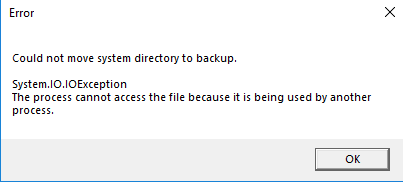

dravokivich 3 Posted September 9, 2018 Author Posted September 9, 2018 (edited) Hi, Seem to be having an issue installing the beta. Do you know which services I have to make sure are no longer running? I keep getting the following error: Edited September 9, 2018 by dravokivich
Luke 42213 Posted September 9, 2018 Posted September 9, 2018 Something must be holding a lock on your emby system folder. i would suggest rebooting and trying again. Thanks.

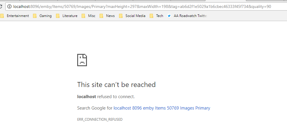

Luke 42213 Posted September 9, 2018 Posted September 9, 2018 Can you start the server and then do nothing expect put this url in a browser address bar: http://localhost:8096/emby/Items/50769/Images/Primary?maxHeight=297&maxWidth=198&tag=ab6d2f1e5029a1b6cbec46333f45f734&quality=90 Does this crash the server?
dravokivich 3 Posted September 9, 2018 Author Posted September 9, 2018 Im not sure if a failed response in this action, will support that the action led to the failure. I get the attached screen shot. Attached logfile, shows that link was the last thing the server tried to do. But there's no further entries. Can we see if a failure was as a result of that? embyserver.txt
Luke 42213 Posted September 9, 2018 Posted September 9, 2018 was it already crashed before you tried that?
dravokivich 3 Posted September 9, 2018 Author Posted September 9, 2018 Yeah, wasn't able to get to it. Then I killed the process that was in the task bar. Started it from the shortcut in the start menu. then after a few minutes,dashboard come up itself. I didn't select anything on the dashboard. Clicked through your link.
dravokivich 3 Posted September 10, 2018 Author Posted September 10, 2018 I get the error that's in post 14.
Luke 42213 Posted September 11, 2018 Posted September 11, 2018 So you can confirm that particular image url crashed the server? or was it already crashed before you had a chance to try?
dravokivich 3 Posted September 14, 2018 Author Posted September 14, 2018 That's a hard question to answer. There's no indication it has crashed. I couldn't use it. When I tried to get to it, it wouldn't work. Same issues still seem to be coming up. Ive even just rebooted now. Get a dashboard presenting MyMedia. couldn't select anything. all I can say is, it's non responsive. Whether i use it Locally or via LAN.
