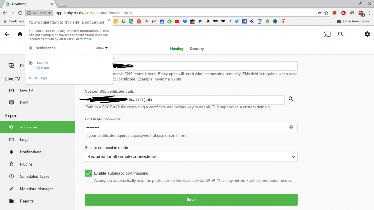

mattykellyuk 18 Posted September 6, 2018 Author Posted September 6, 2018 So to recap, I am able to connect with https but when I go through emby connect it looks to be http even though emby settings saying 'require for all remote connection'. I have also removed the ports for http from the 'services' section of the router, leaving only the ssl port. I do have uPnp enabled though, is this relevant? See screenshots attached

mattykellyuk 18 Posted September 6, 2018 Author Posted September 6, 2018 (edited) Is there any setting I should double check? Just to confirm the emby connect thing see attached screenshot done on works wifi Edited September 6, 2018 by mattykellyuk
Happy2Play 9802 Posted September 6, 2018 Posted September 6, 2018 Connect is a alternative to your DDNS/WAN address there is nothing you need to enable. Either use https://app.emby.media or use your WAN address. Connect plays by its own rules. I just logged in with http://app.emby.media and when adding my server I was forced to add my https://WAN address and port, http would not connect. But the browser will always show unsecure unless you sign into Connect on https address.
mattykellyuk 18 Posted September 6, 2018 Author Posted September 6, 2018 Connect is a alternative to your DDNS/WAN address there is nothing you need to enable. Either use https://app.emby.media or use your WAN address. Connect plays by its own rules. I just logged in with http://app.emby.media and when adding my server I was forced to add my https://WAN address and port, http would not connect. But the browser will always show unsecure unless you sign into Connect on https address. Right thats a bit annoying. I just tried to login via https://app.emby.media and it won't connect to my server, although my domain works fine. So i just need to login using my domain? What about devices like fire sticks?
