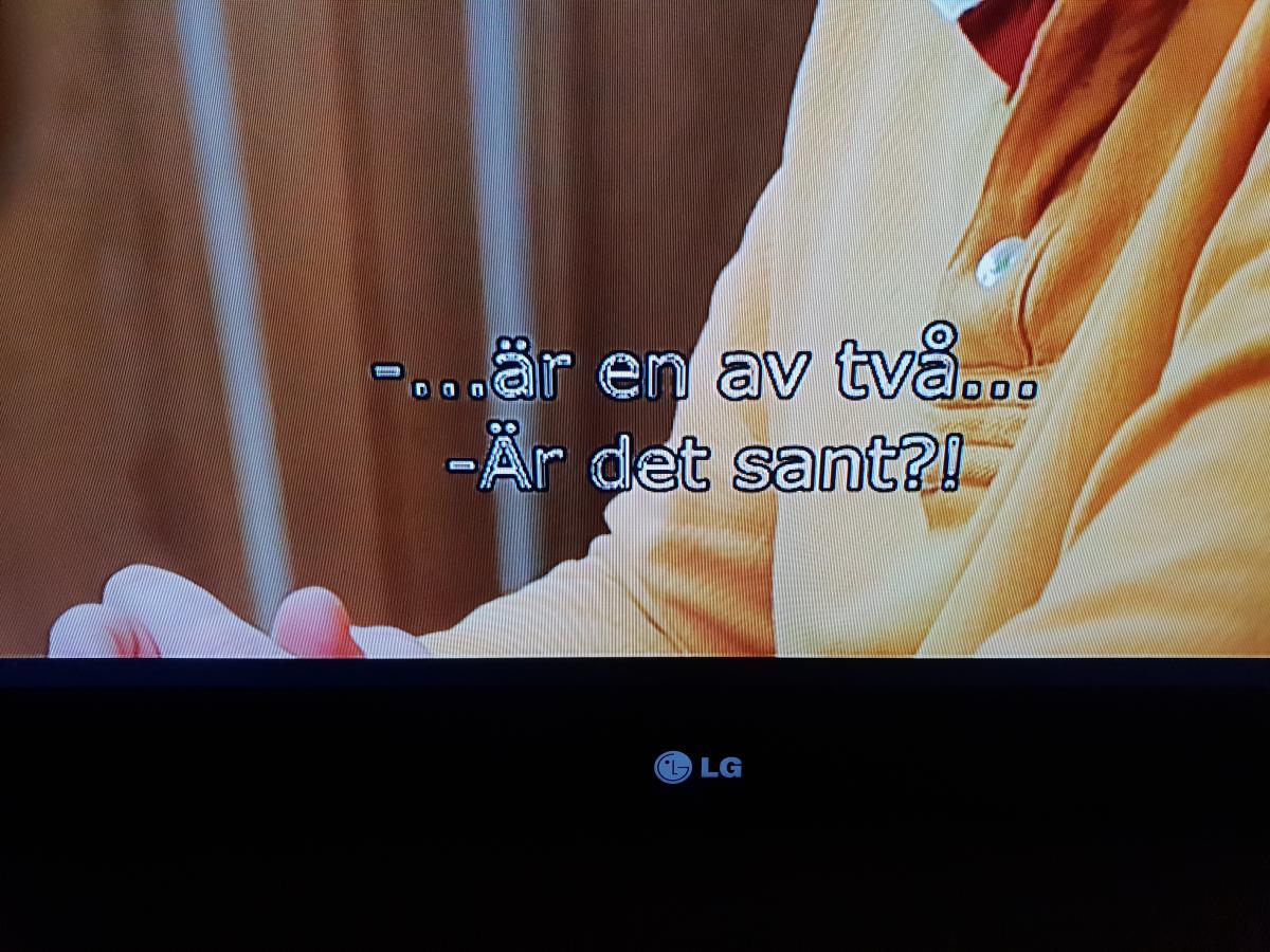

chali 11 Posted September 2, 2018 Author Posted September 2, 2018 (edited) Yes the new beta will be up shortly. To test just create the same conditions as before. Thanks. ok, it works but i found 2 smal bugs so far. 1 after setting Swedish system wide some movies are having some sub problems. (added imige of it, the subs are not solid as you can see) its not in every movie and its only like every 3-4 sub line. the movies are still playing without the need to transcode on mi box (very good) 2: using a samsung s9+ and latest android client. the first times you start the app and try to play a movie, the screen doesn't rotate making the app not start to play the file and the app to lockupp. after doing 2 restarts off the app it now rotate and plays the file fine. im going to test some more hardware in the morning EDIT: il tested on a samsung s7edge, s8 and a nvidia shield to. its basically same thing as above, the subs did look a bit worse then on the mi box, but that can have to do with the tv the shield is using is more sharp. //Regards Edited September 2, 2018 by chali
Luke 42245 Posted September 3, 2018 Posted September 3, 2018 Well on a shield i have not seen this. they look very sharp to me. what version of android are the samsungs on?
