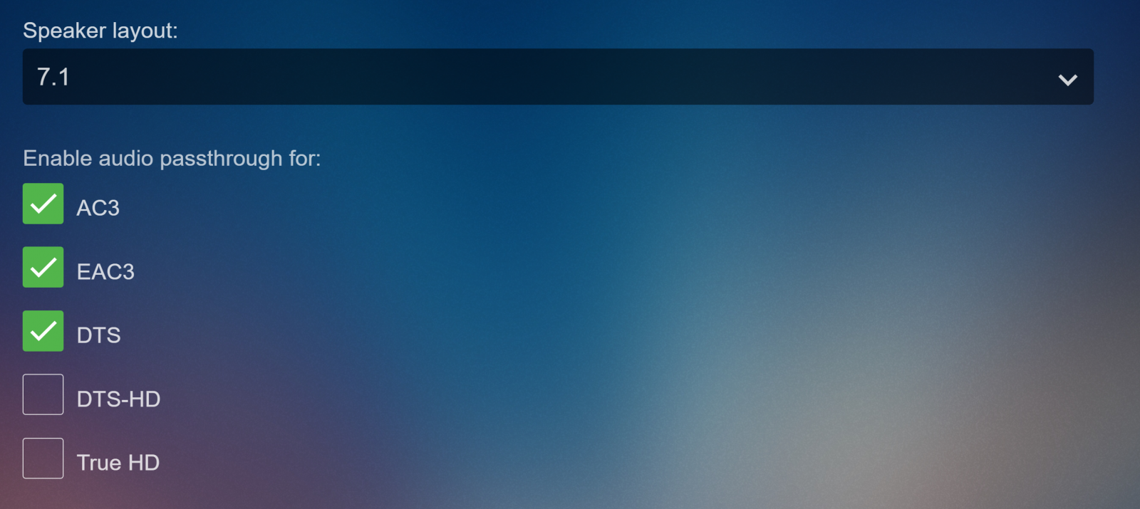

BurntTech 6 Posted August 26, 2018 Author Posted August 26, 2018 Interesting Update if I disable the problem encodings in Emby for bitstream as seen in the attachment. If I disable DTS-HD the receiver when playing a DTS-HD test file picks up its DTS stream but only 5.1. Now with TrueHD disabled and windows and the emby set 7.1. Testing Rampage or other TrueHD the stereo switches from the default PCM its normally sitting at to stereo.

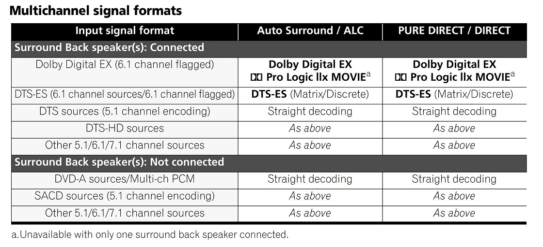

Guest asrequested Posted August 27, 2018 Posted August 27, 2018 (edited) If you haven't already, I'd suggest using 'Auto Surround'. https://www.pioneerelectronics.com/StaticFiles/Manuals/Home/VSX-30_OperatingInstructions0430.pdf (page 126) Edited August 27, 2018 by Doofus
