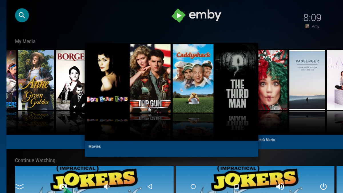

wedgekc 12 Posted August 24, 2018 Posted August 24, 2018 I have a cheap Chinese android box (a95x pro) that runs android tv version 7.1. For some reason posters and thumbs look larger than normal and my movie and tv libraries are only showing part of the poster images (attached images). Does any one know what might be causing this? Thanks.

ebr 16337 Posted August 24, 2018 Posted August 24, 2018 I don't think I've seen that exact issue before but it must be that the device is not reporting a proper pixel density for the display. That is clearly the mobile OS as you can see the touch icons on the bottom of the screen. Does it have the proper Android TV launcher as the device home screen?
wedgekc 12 Posted August 24, 2018 Author Posted August 24, 2018 Yes, It has the proper Android TV launcher on the home screen with Emby, Youtube recommendations, etc. I know I'm playing with fire with the cheap Chinese android boxes, just thought I would ask in case I was overlooking something. Other Android TV apps like Youtube look normal though. Videos play fine in Emby, so it's not a big inconvenience. Thanks
Solution ebr 16337 Posted August 24, 2018 Solution Posted August 24, 2018 Try changing the poster size with that cog wheel shown in the upper right and see if either of the other two display better. Also, look for any text or other scaling settings in the OS/device itself and make sure they are at 100% and not something greater. 1
wedgekc 12 Posted August 26, 2018 Author Posted August 26, 2018 (edited) Thanks for getting me on the right track! It was a dpi issue. Once I changed the density (adb shell wm density 320) to 320 (same as the shield) through adb everything looked normal. Edited August 26, 2018 by wedgekc
