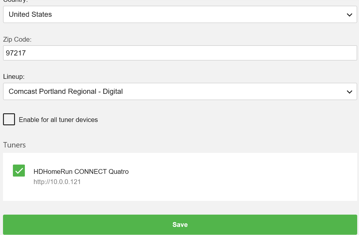

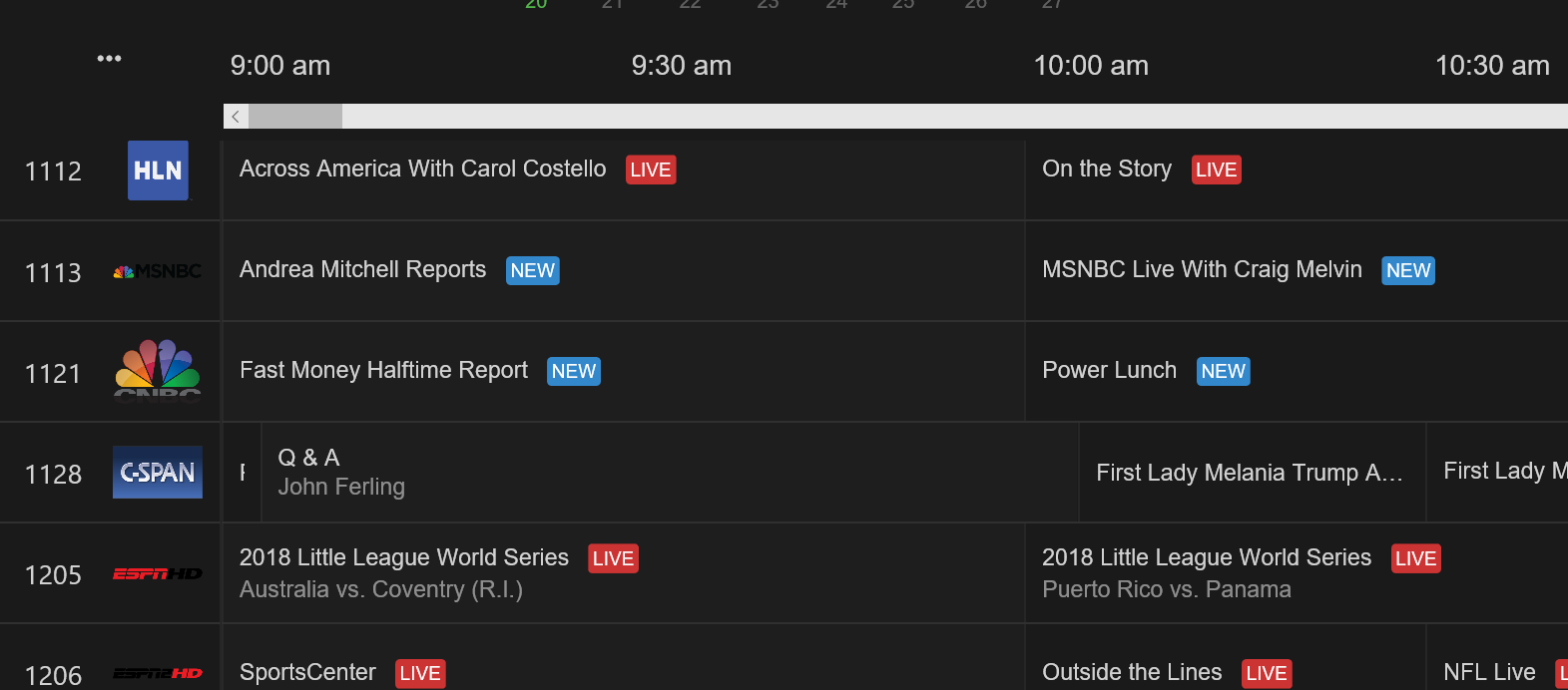

nyplayer 90 Posted August 20, 2018 Author Posted August 20, 2018 I also got this working in EMBY ... Removed all my tuners added the Quatro and Selected my Comcast Cable line up ... and it just works.
jasonmcroy 320 Posted August 20, 2018 Posted August 20, 2018 I also got this working in EMBY ... Removed all my tuners added the Quatro and Selected my Comcast Cable line up ... and it just works. Do your Comcast channel numbers match the SD line-up?
nyplayer 90 Posted August 20, 2018 Author Posted August 20, 2018 (edited) Do your Comcast channel numbers match the SD line-up? Yes only had to map the OTA. I have a recording going now. Edited August 20, 2018 by nyplayer 1
hstamas 179 Posted August 20, 2018 Posted August 20, 2018 Guys before you go too crazy deleting tuners and remapping channels note the issue here on the SD discussion forum that some of the feeds seem to be east and west cost. So until, for instance Schedules Direct has a proper lineup in place for this service air times are going to be off for some channels: https://forum.silicondust.com/forum/viewtopic.php?f=119&t=69230&start=225
nyplayer 90 Posted August 20, 2018 Author Posted August 20, 2018 Guys before you go too crazy deleting tuners and remapping channels note the issue here on the SD discussion forum that some of the feeds seem to be east and west cost. So until, for instance Schedules Direct has a proper lineup in place for this service air times are going to be off for some channels: https://forum.silicondust.com/forum/viewtopic.php?f=119&t=69230&start=225 In my case I do not have that problem so it is a case by case bases.
