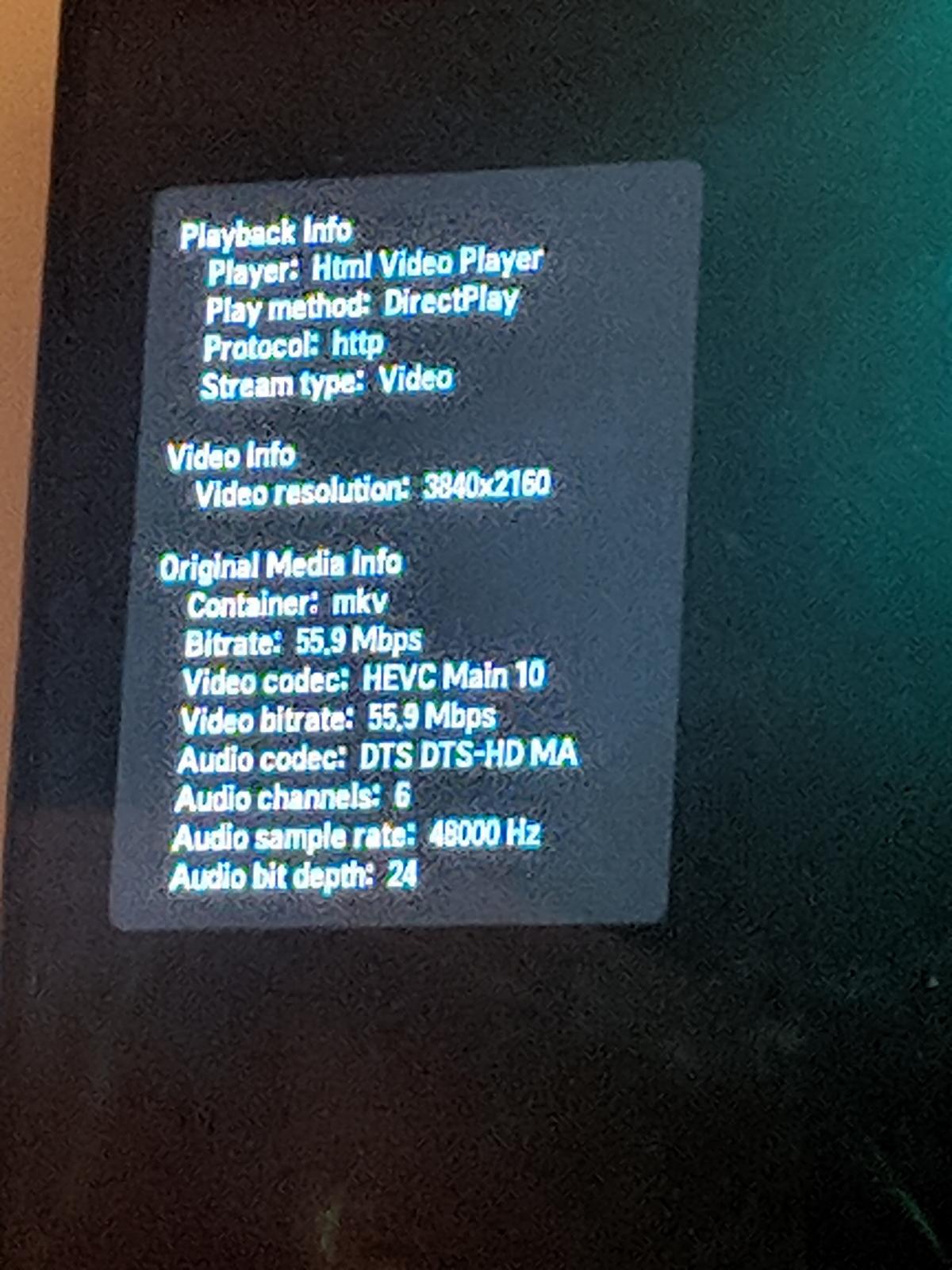

But with 1.08, I'm getting smooth playback of the video, and the HDR popup occurs, and I thought everything was good...but I had no audio at all...crap!
I have a LG 55c7 with Sonos playbar using optical.
You'll notice in my "stats for nerds" below that my file is direct streaming, but mentions DTS DTS-HD MA.
Of course, my TV supports DTS, but the Sonos just supports Dolby Digital.  So as mentioned in that post above, the requested fix was some way of flagging a need to force transcode the audio.
It appears a github ticket was created https://github.com/M...mby/issues/3388 here, but it's been closed, so not sure if that means it's submitted and just waiting for LG or what
In a nutshell, I just wanted to offer my logs in case it's helpful.
Shape of Water is the movie I was playing.
