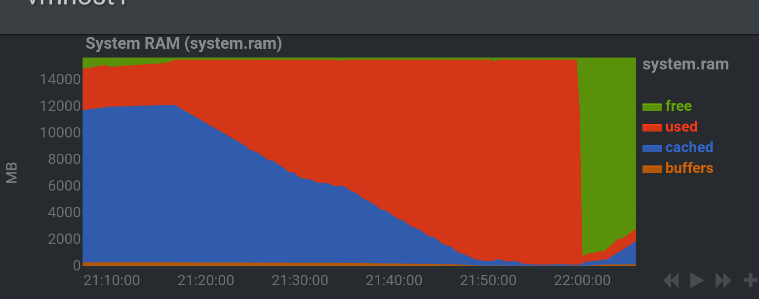

thynan 6 Posted August 19, 2018 Posted August 19, 2018 H! Around once a day my emby-server crashes after running out of memory and starting to swap. The memory consumption increases gradually over some minutes. I made a screenshot of the memory consumption graph of my server before such a crash: You can clearly see when i restarted the server (around 22:00) and the memory was freed up once again. The server doesn't really "crash", it just becomes unresponsive when it starts to swap memory. Before it starts swapping, emby runs just fine. I will not attach the whole log, because it''s pretty big, but i noticed that the following exception get's logged during the time the memory consumption increases: 2018-08-19 19:50:15.131 Error HttpServer: WebSocketException Success *** Error Report *** Version: 3.5.2.0 Command line: /opt/emby-server/system/EmbyServer.dll -programdata /var/lib/emby -ffmpeg /opt/emby-server/bin/ffmpeg -ffprobe /opt/emby-server/bin/ffprobe -restartexitcode 3 -updatepackage emby-server-deb_{version}_amd64.deb Operating system: Unix 4.15.0.32 64-Bit OS: True 64-Bit Process: True User Interactive: True Processor count: 8 Program data path: /var/lib/emby Application directory: /opt/emby-server/system System.Net.WebSockets.WebSocketException (0x80004005): net_WebSockets_InvalidState at SocketHttpListener.Net.WebSockets.WebSocketValidate.ThrowIfInvalidState(WebSocketState currentState, Boolean isDisposed, WebSocketState[] validStates) at SocketHttpListener.Net.WebSockets.ManagedWebSocket.ReceiveAsync(ArraySegment`1 buffer, CancellationToken cancellationToken) --- End of stack trace from previous location where exception was thrown --- at SocketHttpListener.Net.WebSockets.WebSocket.ReceiveAsync(Memory`1 buffer, CancellationToken cancellationToken) at EmbyServer.SocketSharp.SharpWebSocket.StartReceive() System.Net.WebSockets.WebSocketException at SocketHttpListener.Net.WebSockets.WebSocketValidate.ThrowIfInvalidState(WebSocketState currentState, Boolean isDisposed, WebSocketState[] validStates) at SocketHttpListener.Net.WebSockets.ManagedWebSocket.ReceiveAsync(ArraySegment`1 buffer, CancellationToken cancellationToken) --- End of stack trace from previous location where exception was thrown --- at SocketHttpListener.Net.WebSockets.WebSocket.ReceiveAsync(Memory`1 buffer, CancellationToken cancellationToken) at EmbyServer.SocketSharp.SharpWebSocket.StartReceive() This message gets logged around twice every milisecond - that's the reason why the logfiles are so big I guess. I will attach a small portion of the log, until the time I restarted the server. If you need the whole log, please tell me. embyserver-log.txt 1

thynan 6 Posted August 20, 2018 Author Posted August 20, 2018 Hi! Thanks for your reply. I don't think these errors are the problem. They happen the during the whole time the server is online, and the memory usage doesn't increase. As you can see in the above graphic, the memory usage starts increasing rapidly over around 30 minutes. I think it's more likely the error message I pasted in my first post is the culprint, because they start around the time when the memory consumption goes up. I don't know where that comes from however. PS: The Screenshot of the memory consumption is not from the same crash as the log - so don't get confused if the times don't match up exactly. 1
