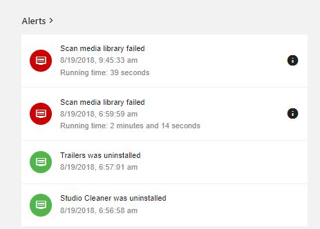

bocabill 1 Posted August 19, 2018 Posted August 19, 2018 I started getting this error a few days ago. No scan of the library would finish. I'm running Emby Server for Windows, version 3.5.2.0 on a Windows 10 rig, the libraries are on a Drive Bender pool. I tried stopping Emby, renaming the library db file, restarting and rescanning, but got the same outcome. So I decided to not go with any half-measures and "went nuclear". I removed Emby using Revo unistaller. Choose the "remove all traces" option in Emby's uninstaller, and let Revo scan for and delete any registry entries it found. I then removed any remaining folders/files that were left over. I don't mind re-configuring Emby from scratch (it's not all that time consuming and it lets me explore the settings) so I am willing to re-rebuild the libraries again in order to get it back into working order. I then did a Windows error check of my drives (it found and repairs some corrupt files) and ran a scan and repair on the files in the Drive Bender pool. After that, I reinstalled Emby Windows server, gave it a "simple" library to scan (my photos), and the error still occurs. Attached is the latest log. In case it was a matter of plug-ins, I have removed all of mine, restarted the server, and scans still fail. The timestamp on the log file after the removal of the plugins. Any advice, insight or assistance would be most appreciated. Thank you in advance. Bill Log.txt
