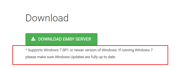

Hi, for Windows 7 you need to make sure Windows updates are fully up to date, otherwise this is exactly what will happen.
Please let us know if this helps. Thanks.

Worked fine after the updates were applied. Thanks Luke.
