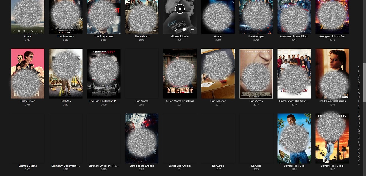

tillithz 1 Posted August 16, 2018 Author Posted August 16, 2018 (edited) Version 3.5.2.0 Emby Server is up to date I am navigating to my Movies library locally, the screen shows a grid of 9 x 2 1/2 cover art. If I scroll down to see content beyond 36 (9 x 3) artwork is missing and theres a blank box with the name of the movie under it. It is at this time that the server becomes unresponsive, navigating to any directory, movie, settings, or anywhere, the screen goes white and I get the loading circle indefinitely until I launch the Emby Server again. If I do not scroll and I select from first 36 movies, the server does not hang, movies will play if they are one of the 9 x 3. I can reproduce the hang by navigating to Movies and then scrolling down. I have no plugins. I've cleared browser cache. Installed latest windows server 2016 updates, restarted server and emby server. There are no logs in Windows Event Viewer at the time (within 20 minutes) this occurs. Attached you can see the screenshot of when this occurs: I rescanned the library, replacing everything. Any insight on this would be great. thank you embyserver.txt.8-16-2018-0937.txt embyserver-63670009058.txt.8-16-2018-0921.txt ffmpeg-remux-21841216-40b4-47aa-adc2-8f853b7a7f55.txt Edited August 16, 2018 by tillithz

tillithz 1 Posted August 18, 2018 Author Posted August 18, 2018 well it seems I tracked down the issue..... IF displaying as a "Poster" this problem occurs. ANY OTHER display(Banner, List, Poster Card, Thumb, or Thumb Card) the issue does not happen. It is frustrating since theres no mention in the logs of the error.
tillithz 1 Posted August 18, 2018 Author Posted August 18, 2018 now, how do I get the other 5 users to not display Posters? This is absolutely maddening. Come on Emby. Can we please get this working its the start of the weekend. Is there a way to disable Poster display? Is there a way to set the library default view? something? anything?
Luke 42213 Posted August 18, 2018 Posted August 18, 2018 There isn't a way to change the defaults but most screens have controls to allow you to change the image type that is shown.
