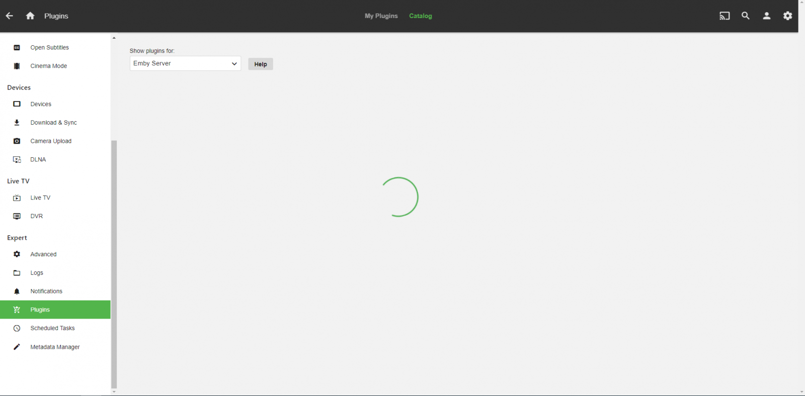

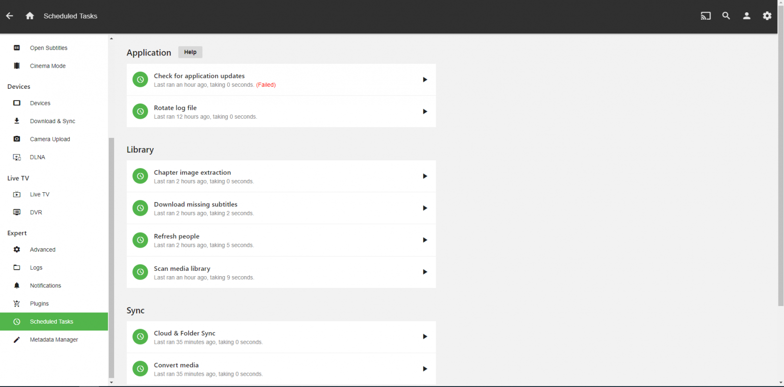

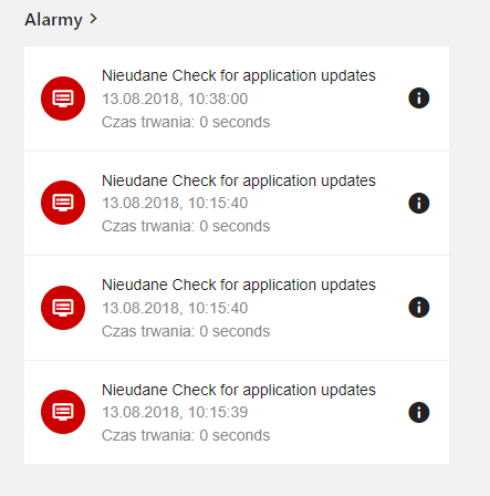

ZiemaF 0 Posted August 13, 2018 Posted August 13, 2018 Hi, I have a problem with the Emby server (docker on OMV), can not download any plugins, covers, content from IMDB. The standard server works in the internal and external network. Thanks.

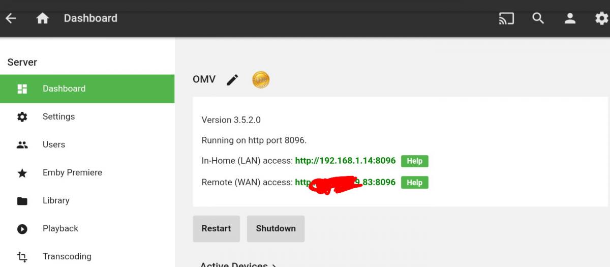

ZiemaF 0 Posted August 13, 2018 Author Posted August 13, 2018 @ZiemaF Had the same issue, check Bind to local network address: What you got there ? If you got 2 interfaces where sever you need specific ip to enter. I can easily log in to the server via LAN and WAN. I have access to Emby from anywhere, home, work, bus etc.

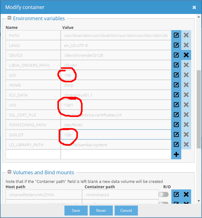

ZiemaF 0 Posted August 14, 2018 Author Posted August 14, 2018 I must admit, @@Luke that when I read your post, it turned on the lamp in my head I started looking for the cause in Docker, and found it. Values in circles have changed. But I do not know why they have changed. these are good settings in red circles. Instead of these values, there was a value of 2 everywhere.
