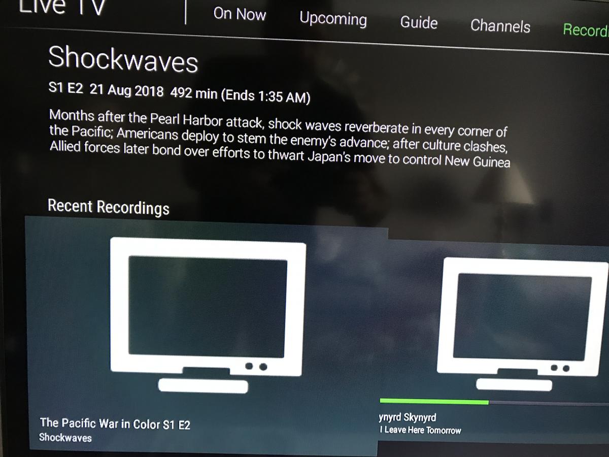

Hey Luke, Sorry for the late response.
Here's a recording example;
- The Pacific War in Color
- 21 Aug 2018
- 492 mins (ends at 3:03pm)
I have my recordings set to run an extra minute if possible.

According to the log it completed after 59 minutes like it was supposed to.
Interesting.
Maybe I need to read some of the wiki but unless the tiles in recordings are a summary of minutes, it is misreporting the recording length.
I’ll read up.

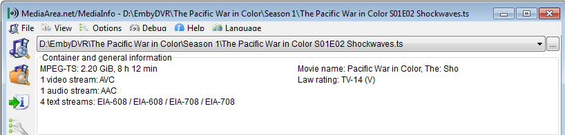

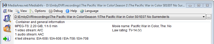

I used a utility called MediaInfo to look at 3 recordings of the same show.  All are approximately the same size, but the duration in MI as well as Emby shows vastly different run-times.
Screen Caps of MediaInfo on the 3 episodes attached.
That's just the duration that ffprobe is giving us. We may need to look at repairing the headers of the .ts file after completing the recording. thanks.
