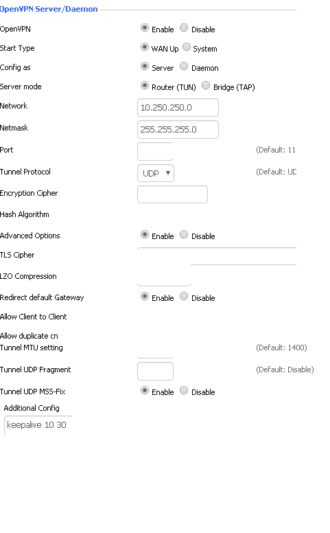

riothamus 53 Posted August 8, 2018 Posted August 8, 2018 That option would force all client traffic through your VPN tunnel, making it the default gateway on your clients. So, just to clarify, you want Emby to not see your VPN network (your 10.x.x.x range) as local to the Emby server, correct? If that is the case, then putting the rest of your network into Emby's configuration (Dashboard->Advanced->LAN Networks and enter in only your local subnet) will force Emby to see just the 192.160.1.0/24 network as local, and restrict bandwidth to anything else. As for your phone device showing up as a 192.168.1.0/24 device, that is likely happening due to how OpenVPN is configured on your router. Would you mind posting your OpenVPN server config? (You can leave out any sensitive bits, I'm mostly curious about the network assignment portions of the configuration).
tdiguy 99 Posted August 8, 2018 Author Posted August 8, 2018 That option would force all client traffic through your VPN tunnel, making it the default gateway on your clients. So, just to clarify, you want Emby to not see your VPN network (your 10.x.x.x range) as local to the Emby server, correct? If that is the case, then putting the rest of your network into Emby's configuration (Dashboard->Advanced->LAN Networks and enter in only your local subnet) will force Emby to see just the 192.160.1.0/24 network as local, and restrict bandwidth to anything else. As for your phone device showing up as a 192.168.1.0/24 device, that is likely happening due to how OpenVPN is configured on your router. Would you mind posting your OpenVPN server config? (You can leave out any sensitive bits, I'm mostly curious about the network assignment portions of the configuration). Ok, I already force all my vpn traffic over the vpn connection. The problem is that emby sees my vpn traffic as coming from 192.168.1.1 not 10. I dont really have issues with the vpn itself its working as i expect it to.
riothamus 53 Posted August 8, 2018 Posted August 8, 2018 The problem is that emby sees my vpn traffic as coming from 192.168.1.1 not 10. Which would make sense as your VPN server and router are on the same box, and that the router is going to be the last hop (192.168.1.1) before it reaches your server. So, if you connect your phone to the VPN, it should get one of your 10.x.x.x VPN addresses. Then, when it connects back to your VPN server, OpenVPN is going to route the traffic over to your default gateway (your router), which hands the traffic to your Emby server. The last bit of traffic that Emby sees is the IP of your router, hence your phone showing up as your router's IP.
