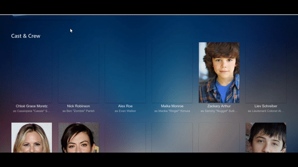

Guest asrequested Posted August 8, 2018 Posted August 8, 2018 (edited) I just started noticing that many of my actor images aren't downloaded, and when I go to the details page, there is an icon. I've tried refreshing and re-scanning, but nothing changes. If I click on the icon, I can click on the magnifying glass, and it finds images. But there are far too many to have to do this one at a time. Edited August 8, 2018 by Doofus

Luke 42212 Posted August 8, 2018 Posted August 8, 2018 Are there any errors in the browser console? try clearing browsing data.
Guest asrequested Posted August 8, 2018 Posted August 8, 2018 Are there any errors in the browser console? try clearing browsing data. This is what I'm seeing in the console GET http://10.1.1.14:8096/emby/Items/63533606ddc737c24b3c51d39511ce1a/Images/Primary?maxWidth=480&tag=6226ebe6d759280cd0c4dd6a7ef90d18&quality=90 404 (OK) Primary:1 GET http://10.1.1.14:8096/emby/Items/1b0da29f82b9c4f55db5f46e8aaef9e1/Images/Primary?maxWidth=480&tag=d7b9f0eb284745977519a4a81eabc0da&quality=90 404 (OK) Primary:1 GET http://10.1.1.14:8096/emby/Items/b313da33ac36cc45d77109dcdefada68/Images/Primary?maxWidth=480&tag=91cf180c5e82a543830e78347fd867c2&quality=90 404 (OK) Primary:1 GET http://10.1.1.14:8096/emby/Items/e8f6c3ba99806fc80be653b6abb8ffa6/Images/Primary?maxWidth=480&tag=e585a884f9f97ff43971e1703f76e35e&quality=90 404 (OK) Primary:1 GET http://10.1.1.14:8096/emby/Items/8797784d177bca4ea141a1d2fa4af199/Images/Primary?maxWidth=480&tag=0e22c004626b5c0bb1e42b71798431d4&quality=90 404 (OK) Primary:1 GET http://10.1.1.14:8096/emby/Items/3ae339ce6e7335cd47b5e6f160431728/Images/Primary?maxWidth=480&tag=2a719f9712326173b59accd670d72044&quality=90 404 (OK)
Luke 42212 Posted August 8, 2018 Posted August 8, 2018 Did you delete contents of your metadata folder recently, or parts of it? because if you did then that would result in the images you see above in your gif. Try running a library scan and a people refresh to make the server aware of any images that you might have deleted.

Happy2Play 9802 Posted August 9, 2018 Posted August 9, 2018 To me watching the gif it looks like a cache or metadata image issue as you see the broken image when you enter the actor detail page. Does a actor having this issue have a image in /metadata/people/x/actorname? Do you also have "Download images in advance" enabled per library? Yes deleting the people will create the same issue and force you to do a Refresh All with replace images or basically start from scratch. As I have had to do this while testing on a test machine. Emby can honor existing People folder but only on a initial build (from my experience).
Guest asrequested Posted August 9, 2018 Posted August 9, 2018 To me watching the gif it looks like a cache or metadata image issue as you see the broken image when you enter the actor detail page. Does a actor having this issue have a image in /metadata/people/x/actorname? Do you also have "Download images in advance" enabled per library? Yes deleting the people will create the same issue and force you to do a Refresh All with replace images or basically start from scratch. As I have had to do this while testing on a test machine. Emby can honor existing People folder but only on a initial build (from my experience). I don't have download in advance, enabled. I'll have to check the actor folder, later. But I also have this with trailer covers. So it seems as though there's something else going on.
