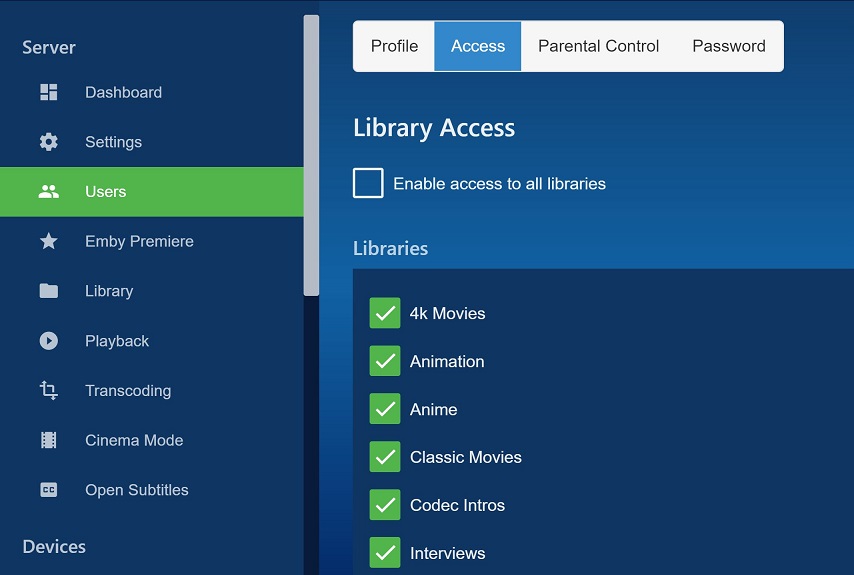

annisman 13 Posted August 4, 2018 Author Posted August 4, 2018 Doofus, how do you exclude certain libraries from reomte users ? Looked around in the server dashboard and saw nothing...
Guest asrequested Posted August 4, 2018 Posted August 4, 2018 Doofus, how do you exclude certain libraries from reomte users ? Looked around in the server dashboard and saw nothing...
annisman 13 Posted August 4, 2018 Author Posted August 4, 2018 Oh, that's why I couldn't find that screen, I don't have any users yet ! besides me
Guest asrequested Posted August 4, 2018 Posted August 4, 2018 Oh, that's why I couldn't find that screen, I don't have any users yet ! besides me So then you'll be able to choose which library to watch from.
