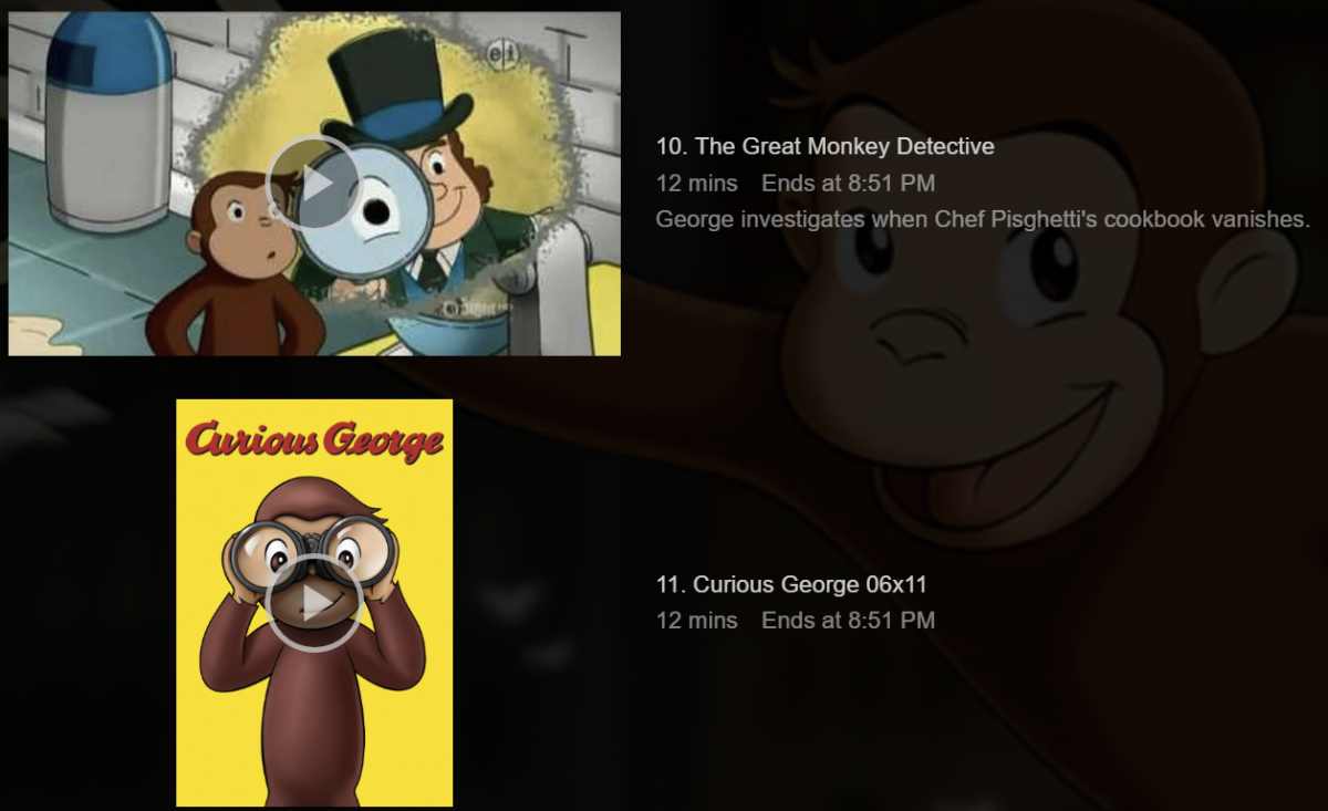

   I am running into an issue where the metadata for my TV Shows is no longer populating automatically after a Libray Refresh. Notice episode 10 has the image, title and description populated, however episode 11 does not.
I have been using the same file structure/naming conventions that I've always used, I've also checked the WIKI to ensure my naming was still correct and it is.

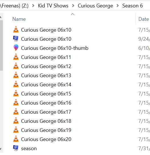

The structure is as follows.
/Kid TV Shows
   /Curious George
        /Season 6
            Curious George 06x11
            Curious George 06x12
            Curious George 06x13
Can ya'll give me some direction here? This used to work, albeit back in 2016, has the naming conventions changed since then? Possibly the file structure is wrong, although it seems to make sense and has worked before. Also, I tried renaming, Curious George 06x11, to S06E11 without success.
Is my file structure no longer supported? Show/Season/Episodes?

Sorry had no issue adding this series with your exact structure and naming convention.  You would need to post a server log when these items were added to see why the information was pulled down from provider.  Best guess would be a issue talking to provider site.
