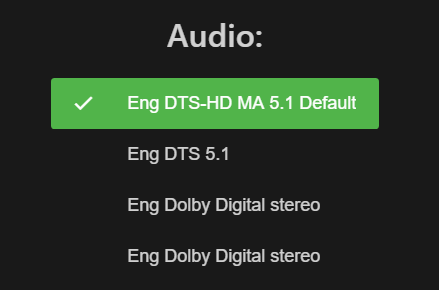

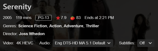

I've got the movie serenity that seems to get reported 5.1. While Using VLC Player or mkvinfo i'm able to see there is 7.1 on this mkv file. Is this something I did wrong with the mkv or emby might be using generic text?
Hi, try refreshing metadata on that title and see if our newer ffmpeg build detects it differently. Thanks.

The image got updated when I did a manual update but the audio reports the same. I'm also wondering if it might be 5.1? bluray.com reports it should be 7.1 and others talk about dts:x.  This is screen shot of what should be the same UHD copy of serenity.

Ok then I guess that's just how ffmpeg is detecting it. Future server releases will update ffmpeg again so we should probably re-evaluate at that time. I would not anticipate this causing you any problems other than the display of number of channels.

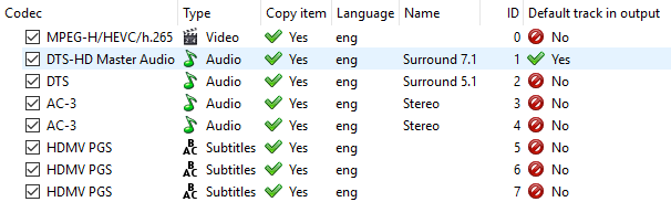

Any chance you can load the mkv in MKVToolNix again, scroll over to see the stream details, and post what it says under the "properties" heading?  It should say something like "48000Hz, 8 channels".  I only ask because the name on the track is "Surround 7.1", but that doesn't really mean anything (that's just a label likely based on the original stream detection, but may not be what was copied).  I just want to be sure that it didn't just copy the core (DTS 5.1) rather than the full DTS-HD Master Audio track (which would be 7.1).

BurntTech
Here is the property column which shows it has 8 channels. Would it work to test this and see what stats for nerds reports if it can see that stream correctly?
Huh, wacky, so it's definitely an 8-channel track.  Gladiator's showing 8 channels as well, although ffprobe definitely doesn't know about DTS:X yet and just reports the DTS-HD MA track info:

My guess is that there's stream info data from the old BRD copy left in the database for some reason.  A refresh should've taken care of that, but I have no idea why it didn't.  Probably the best thing to try is rotate the logs, do a refresh metadata on the movie, then post the log that includes the refresh so Luke can take a peek at what the server is doing (or thinks it's doing).

Yep.  Since they replaced an old BRD remux that had a 5.1 track, I'm guessing that data is still in the database.  The file clearly has 8 channels, though, so it's more about why the probe isn't happening or overwriting the info in the database.
