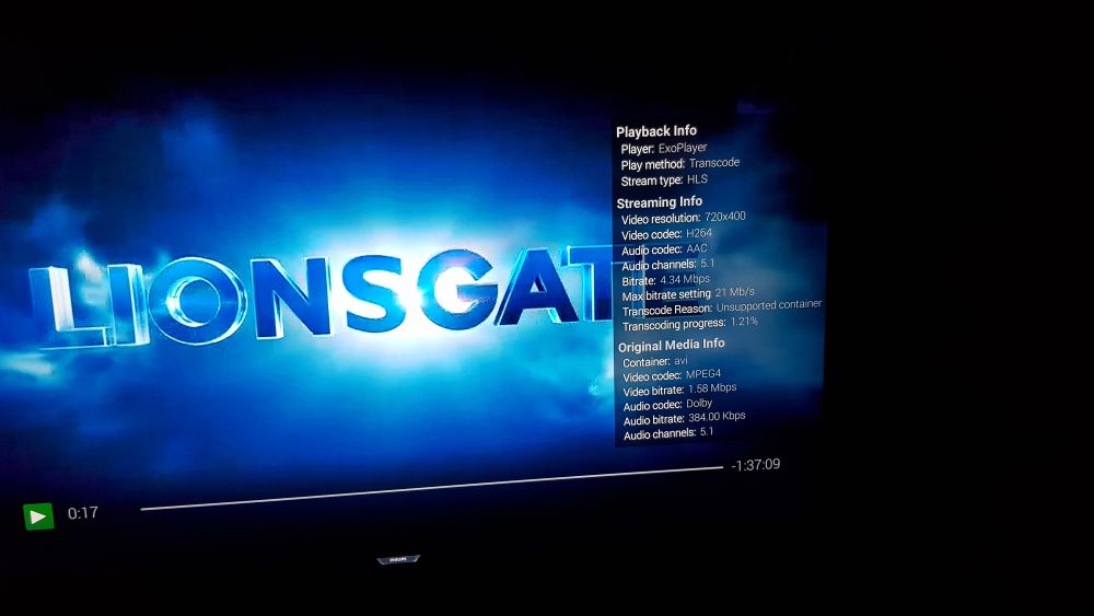

garegina 6 Posted July 30, 2018 Author Posted July 30, 2018 Hi Luke Thanks for answering. I have uploaded the logs via Android TV. I have included screenshots of TV & Emby playing and their respective outputs to Integra Emby Output. Thanks Luke . TV Output

ebr 16337 Posted July 30, 2018 Posted July 30, 2018 Hi. Can I please see the ffmpeg log that is generated on the server when you play that first item? Thanks. BTW - the app is sending 5.1 PCM but the TV is converting it to stereo because an optical connection cannot carry more than two channels of PCM.
garegina 6 Posted July 30, 2018 Author Posted July 30, 2018 Hi ebr Here is the ffmpeg txt file. Is there a way for the app to send DD rather than pcm ? 2018-07-31 09:03:35.065 Application version: 3.5.0.0 http://192.168.0.10:8096/emby/videos/7fa4942d2ca8f09a6c0a80b4c4d4315c/hls1/main/0.ts?DeviceId=69de36d4f5235295&MediaSourceId=7fa4942d2ca8f09a6c0a80b4c4d4315c&VideoCodec=h264,mpeg2video,hevc,h265&AudioCodec=aac,mp3&AudioStreamIndex=1&VideoBitrate=20616000&AudioBitrate=384000&PlaySessionId=3c52345ea6f24e96a3487a18bd467ce1&api_key=6f89636db8f24158a8bac2e8912be0b5&CopyTimestamps=true&RequireAvc=false&Tag=0fae93f91a0623c78658651b40d1855a&SegmentContainer=ts&MinSegments=2&BreakOnNonKeyFrames=True&h264-profile=high,main,baseline,constrainedbaseline&h264-level=51&mpeg2video-deinterlace=true&hevc-profile=Main,Main10&aac-audiochannels=8&mp3-audiochannels=8&TranscodeReasons=ContainerNotSupported,VideoCodecNotSupported,AudioCodecNotSupported {"Protocol":"File","Id":"7fa4942d2ca8f09a6c0a80b4c4d4315c","Path":"/share/CACHEDEV1_DATA/Movies July 2018/Affairs of State (2018)/Affairs of State (2018).avi","Type":"Default","Container":"avi","Name":"Affairs of State (2018)","IsRemote":false,"ETag":"0fae93f91a0623c78658651b40d1855a","RunTimeTicks":58468780000,"ReadAtNativeFramerate":false,"IgnoreDts":false,"IgnoreIndex":false,"GenPtsInput":false,"SupportsTranscoding":true,"SupportsDirectStream":true,"SupportsDirectPlay":true,"IsInfiniteStream":false,"RequiresOpening":false,"RequiresClosing":false,"RequiresLooping":false,"SupportsProbing":true,"VideoType":"VideoFile","MediaStreams":[{"Codec":"mpeg4","CodecTag":"XVID","TimeBase":"417083/10000000","CodecTimeBase":"417083/10000000","VideoRange":"SDR","DisplayTitle":"480P MPEG4","IsInterlaced":false,"BitRate":1583239,"RefFrames":1,"IsDefault":false,"IsForced":false,"Height":400,"Width":720,"AverageFrameRate":23.9760437,"RealFrameRate":23.9760437,"Profile":"Advanced Simple Profile","Type":"Video","AspectRatio":"16:9","Index":0,"IsExternal":false,"IsTextSubtitleStream":false,"SupportsExternalStream":false,"PixelFormat":"yuv420p","Level":5},{"Codec":"ac3","TimeBase":"4/125","CodecTimeBase":"1/48000","DisplayTitle":"Dolby Digital 5.1","IsInterlaced":false,"ChannelLayout":"5.1","BitRate":384000,"Channels":6,"SampleRate":48000,"IsDefault":false,"IsForced":false,"Type":"Audio","Index":1,"IsExternal":false,"IsTextSubtitleStream":false,"SupportsExternalStream":false,"Level":0}],"Formats":[],"Bitrate":1976573,"RequiredHttpHeaders":{}} User policy for Gary & Regina: EnablePlaybackRemuxing: True EnableVideoPlaybackTranscoding: True EnableAudioPlaybackTranscoding: True /share/CACHEDEV1_DATA/.qpkg/EmbyServer/bin/ffmpeg -i file:"/share/CACHEDEV1_DATA/Movies July 2018/Affairs of State (2018)/Affairs of State (2018).avi" -threads 0 -map 0:0 -map 0:1 -map -0:s -codec:v:0 libx264 -vf "scale=trunc(min(max(iw\,ih*dar)\,1280)/2)*2:trunc(ow/dar/2)*2" -pix_fmt yuv420p -preset veryfast -crf 23 -maxrate 3958098 -bufsize 7916196 -profile:v high -level 4.1 -x264opts:0 subme=0:me_range=4:rc_lookahead=10:me=dia:no_chroma_me:8x8dct=0:partitions=none -force_key_frames "expr:if(isnan(prev_forced_t),eq(t,t),gte(t,prev_forced_t+3))" -copyts -vsync -1 -codec:a:0 aac -strict experimental -ac 6 -ab 384000 -f segment -max_delay 5000000 -avoid_negative_ts disabled -map_metadata -1 -map_chapters -1 -start_at_zero -segment_time 3 -individual_header_trailer 0 -segment_format mpegts -segment_list_type m3u8 -segment_start_number 0 -segment_list "/share/CACHEDEV1_DATA/.qpkg/EmbyServer/programdata/transcoding-temp/e11e0ea4f6f72628a52074132c35efec.m3u8" -y "/share/CACHEDEV1_DATA/.qpkg/EmbyServer/programdata/transcoding-temp/e11e0ea4f6f72628a52074132c35efec%d.ts" ffmpeg version 4.0.1 Copyright © 2000-2018 the FFmpeg developers built with gcc 6.3.0 (crosstool-NG crosstool-ng-1.23.0) configuration: --enable-cross-compile --cross-prefix=x86_64-pc-linux-gnu- --cc=x86_64-pc-linux-gnu-gcc --cxx=x86_64-pc-linux-gnu-g++ --arch=x86_64 --prefix=/home/embybuilder/Buildbot-master/x64/ffmpeg-x64/staging --pkg-config=pkg-config --disable-doc --disable-ffplay --disable-xlib --enable-fontconfig --enable-gnutls --enable-gpl --enable-iconv --enable-libass --enable-libfreetype --enable-libfribidi --enable-libmp3lame --enable-libopus --enable-libtheora --enable-libvorbis --enable-libwebp --enable-libx264 --enable-libzvbi --enable-version3 --extra-libs='-ldl -lexpat -lfreetype -lfribidi -lfontconfig -liconv -lpng -luuid -lz -lvorbis -logg -lnettle -lhogweed -lgmp -laddns-samba4 -lasn1util-samba4 -lauthkrb5-samba4 -lCHARSET3-samba4 -lcliauth-samba4 -lcli-cldap-samba4 -lcli-ldap-common-samba4 -lcli-nbt-samba4 -lcli-smb-common-samba4 -lcom_err -lcommon-auth-samba4 -ldbwrap-samba4 -ldcerpc-binding -ldcerpc-samba-samba4 -lflag-mapping-samba4 -lgenrand-samba4 -lgensec-samba4 -lgse-samba4 -lgssapi_krb5 -llibcli-lsa3-samba4 -llibsmb-samba4 -linterfaces-samba4 -liov-buf-samba4 -lk5crypto -lkrb5 -lkrb5samba-samba4 -lkrb5support -lldb -lldbsamba-samba4 -lmessages-dgm-samba4 -lmessages-util-samba4 -lmsghdr-samba4 -lmsrpc3-samba4 -lndr -lndr-krb5pac -lndr-nbt -lndr-samba-samba4 -lndr-standard -lreplace-samba4 -lsamba-cluster-support-samba4 -lsamba-credentials -lsamba-debug-samba4 -lsamba-errors -lsamba-hostconfig -lsamba-modules-samba4 -lsamba-security-samba4 -lsamba-sockets-samba4 -lsamba-util -lsamba3-util-samba4 -lsamdb -lsamdb-common-samba4 -lsecrets3-samba4 -lserver-id-db-samba4 -lserver-role-samba4 -lsmbconf -lsmbd-shim-samba4 -lsmb-transport-samba4 -lsocket-blocking-samba4 -lsys-rw-samba4 -ltalloc -ltalloc-report-samba4 -ltdb -ltdb-wrap-samba4 -ltevent -ltevent-util -ltime-basic-samba4 -lutil-cmdline-samba4 -lutil-reg-samba4 -lutil-setid-samba4 -lutil-tdb-samba4 -lwbclient -lwinbind-client-samba4 -ldrm' --target-os=linux --enable-shared --disable-static --enable-libsmbclient --enable-cuda --enable-cuvid --enable-nvenc --enable-vaapi libavutil 56. 14.100 / 56. 14.100 libavcodec 58. 18.100 / 58. 18.100 libavformat 58. 12.100 / 58. 12.100 libavdevice 58. 3.100 / 58. 3.100 libavfilter 7. 16.100 / 7. 16.100 libswscale 5. 1.100 / 5. 1.100 libswresample 3. 1.100 / 3. 1.100 libpostproc 55. 1.100 / 55. 1.100 Input #0, avi, from 'file:/share/CACHEDEV1_DATA/Movies July 2018/Affairs of State (2018)/Affairs of State (2018).avi': Duration: 01:37:26.88, start: 0.000000, bitrate: 1976 kb/s Stream #0:0: Video: mpeg4 (Advanced Simple Profile) (XVID / 0x44495658), yuv420p, 720x400 [sAR 1:1 DAR 9:5], 1583 kb/s, 23.98 fps, 23.98 tbr, 23.98 tbn, 23.98 tbc Stream #0:1: Audio: ac3 ([0] [0][0] / 0x2000), 48000 Hz, 5.1(side), fltp, 384 kb/s Stream mapping: Stream #0:0 -> #0:0 (mpeg4 (native) -> h264 (libx264)) Stream #0:1 -> #0:1 (ac3 (native) -> aac (native)) Press [q] to stop, [?] for help [mpeg4 @ 0x1cc5740] Video uses a non-standard and wasteful way to store B-frames ('packed B-frames'). Consider using the mpeg4_unpack_bframes bitstream filter without encoding but stream copy to fix it. [libx264 @ 0x1cae000] using SAR=1/1 [libx264 @ 0x1cae000] using cpu capabilities: MMX2 SSE2Fast SSSE3 SSE4.2 [libx264 @ 0x1cae000] profile Main, level 4.1 [libx264 @ 0x1cae000] 264 - core 152 r2854 e9a5903 - H.264/MPEG-4 AVC codec - Copyleft 2003-2017 - http://www.videolan.org/x264.html - options: cabac=1 ref=1 deblock=1:0:0 analyse=0x1:0 me=dia subme=0 psy=1 psy_rd=1.00:0.00 mixed_ref=0 me_range=4 chroma_me=0 trellis=0 8x8dct=0 cqm=0 deadzone=21,11 fast_pskip=1 chroma_qp_offset=0 threads=6 lookahead_threads=1 sliced_threads=0 nr=0 decimate=1 interlaced=0 bluray_compat=0 constrained_intra=0 bframes=3 b_pyramid=2 b_adapt=1 b_bias=0 direct=1 weightb=1 open_gop=0 weightp=1 keyint=250 keyint_min=23 scenecut=40 intra_refresh=0 rc_lookahead=10 rc=crf mbtree=1 crf=23.0 qcomp=0.60 qpmin=0 qpmax=69 qpstep=4 vbv_maxrate=3958 vbv_bufsize=7916 crf_max=0.0 nal_hrd=none filler=0 ip_ratio=1.40 aq=1:1.00 [segment @ 0x1cc6b40] Opening '/share/CACHEDEV1_DATA/.qpkg/EmbyServer/programdata/transcoding-temp/e11e0ea4f6f72628a52074132c35efec0.ts' for writing Output #0, segment, to '/share/CACHEDEV1_DATA/.qpkg/EmbyServer/programdata/transcoding-temp/e11e0ea4f6f72628a52074132c35efec%d.ts': Metadata: encoder : Lavf58.12.100 Stream #0:0: Video: h264 (libx264), yuv420p, 720x400 [sAR 1:1 DAR 9:5], q=-1--1, 23.98 fps, 90k tbn, 23.98 tbc Metadata: encoder : Lavc58.18.100 libx264 Side data: cpb: bitrate max/min/avg: 3958000/0/0 buffer size: 7916000 vbv_delay: -1 Stream #0:1: Audio: aac (LC), 48000 Hz, 5.1, fltp, 384 kb/s Metadata: encoder : Lavc58.18.100 aac frame= 49 fps=0.0 q=28.0 size=N/A time=00:00:02.70 bitrate=N/A speed=5.41x [segment @ 0x1cc6b40] Opening '/share/CACHEDEV1_DATA/.qpkg/EmbyServer/programdata/transcoding-temp/e11e0ea4f6f72628a52074132c35efec.m3u8.tmp' for writing [segment @ 0x1cc6b40] Opening '/share/CACHEDEV1_DATA/.qpkg/EmbyServer/programdata/transcoding-temp/e11e0ea4f6f72628a52074132c35efec1.ts' for writing frame= 124 fps=124 q=28.0 size=N/A time=00:00:05.84 bitrate=N/A speed=5.82x [segment @ 0x1cc6b40] Opening '/share/CACHEDEV1_DATA/.qpkg/EmbyServer/programdata/transcoding-temp/e11e0ea4f6f72628a52074132c35efec.m3u8.tmp' for writing [segment @ 0x1cc6b40] Opening '/share/CACHEDEV1_DATA/.qpkg/EmbyServer/programdata/transcoding-temp/e11e0ea4f6f72628a52074132c35efec2.ts' for writing frame= 198 fps=132 q=28.0 size=N/A time=00:00:08.87 bitrate=N/A speed= 5.9x [segment @ 0x1cc6b40] Opening '/share/CACHEDEV1_DATA/.qpkg/EmbyServer/programdata/transcoding-temp/e11e0ea4f6f72628a52074132c35efec.m3u8.tmp' for writing [segment @ 0x1cc6b40] Opening '/share/CACHEDEV1_DATA/.qpkg/EmbyServer/programdata/transcoding-temp/e11e0ea4f6f72628a52074132c35efec3.ts' for writing frame= 270 fps=135 q=28.0 size=N/A time=00:00:11.92 bitrate=N/A speed=5.95x [segment @ 0x1cc6b40] Opening '/share/CACHEDEV1_DATA/.qpkg/EmbyServer/programdata/transcoding-temp/e11e0ea4f6f72628a52074132c35efec.m3u8.tmp' for writing [segment @ 0x1cc6b40] Opening '/share/CACHEDEV1_DATA/.qpkg/EmbyServer/programdata/transcoding-temp/e11e0ea4f6f72628a52074132c35efec4.ts' for writing frame= 344 fps=137 q=28.0 size=N/A time=00:00:14.99 bitrate=N/A speed=5.99x [segment @ 0x1cc6b40] Opening '/share/CACHEDEV1_DATA/.qpkg/EmbyServer/programdata/transcoding-temp/e11e0ea4f6f72628a52074132c35efec.m3u8.tmp' for writing [segment @ 0x1cc6b40] Opening '/share/CACHEDEV1_DATA/.qpkg/EmbyServer/programdata/transcoding-temp/e11e0ea4f6f72628a52074132c35efec5.ts' for writing frame= 420 fps=140 q=28.0 size=N/A time=00:00:18.13 bitrate=N/A speed=6.03x [segment @ 0x1cc6b40] Opening '/share/CACHEDEV1_DATA/.qpkg/EmbyServer/programdata/transcoding-temp/e11e0ea4f6f72628a52074132c35efec.m3u8.tmp' for writing [segment @ 0x1cc6b40] Opening '/share/CACHEDEV1_DATA/.qpkg/EmbyServer/programdata/transcoding-temp/e11e0ea4f6f72628a52074132c35efec6.ts' for writing frame= 495 fps=141 q=28.0 size=N/A time=00:00:21.29 bitrate=N/A speed=6.07x [segment @ 0x1cc6b40] Opening '/share/CACHEDEV1_DATA/.qpkg/EmbyServer/programdata/transcoding-temp/e11e0ea4f6f72628a52074132c35efec.m3u8.tmp' for writing [segment @ 0x1cc6b40] Opening '/share/CACHEDEV1_DATA/.qpkg/EmbyServer/programdata/transcoding-temp/e11e0ea4f6f72628a52074132c35efec7.ts' for writing frame= 570 fps=142 q=28.0 size=N/A time=00:00:24.40 bitrate=N/A speed=6.09x [segment @ 0x1cc6b40] Opening '/share/CACHEDEV1_DATA/.qpkg/EmbyServer/programdata/transcoding-temp/e11e0ea4f6f72628a52074132c35efec.m3u8.tmp' for writing [segment @ 0x1cc6b40] Opening '/share/CACHEDEV1_DATA/.qpkg/EmbyServer/programdata/transcoding-temp/e11e0ea4f6f72628a52074132c35efec8.ts' for writing frame= 642 fps=142 q=28.0 size=N/A time=00:00:27.41 bitrate=N/A speed=6.08x [segment @ 0x1cc6b40] Opening '/share/CACHEDEV1_DATA/.qpkg/EmbyServer/programdata/transcoding-temp/e11e0ea4f6f72628a52074132c35efec.m3u8.tmp' for writing [segment @ 0x1cc6b40] Opening '/share/CACHEDEV1_DATA/.qpkg/EmbyServer/programdata/transcoding-temp/e11e0ea4f6f72628a52074132c35efec9.ts' for writing frame= 714 fps=142 q=28.0 size=N/A time=00:00:30.44 bitrate=N/A speed=6.07x [segment @ 0x1cc6b40] Opening '/share/CACHEDEV1_DATA/.qpkg/EmbyServer/programdata/transcoding-temp/e11e0ea4f6f72628a52074132c35efec.m3u8.tmp' for writing [segment @ 0x1cc6b40] Opening '/share/CACHEDEV1_DATA/.qpkg/EmbyServer/programdata/transcoding-temp/e11e0ea4f6f72628a52074132c35efec10.ts' for writing frame= 790 fps=143 q=28.0 size=N/A time=00:00:33.55 bitrate=N/A speed=6.08x [segment @ 0x1cc6b40] Opening '/share/CACHEDEV1_DATA/.qpkg/EmbyServer/programdata/transcoding-temp/e11e0ea4f6f72628a52074132c35efec.m3u8.tmp' for writing [segment @ 0x1cc6b40] Opening '/share/CACHEDEV1_DATA/.qpkg/EmbyServer/programdata/transcoding-temp/e11e0ea4f6f72628a52074132c35efec11.ts' for writing frame= 862 fps=143 q=28.0 size=N/A time=00:00:36.56 bitrate=N/A speed=6.07x [segment @ 0x1cc6b40] Opening '/share/CACHEDEV1_DATA/.qpkg/EmbyServer/programdata/transcoding-temp/e11e0ea4f6f72628a52074132c35efec.m3u8.tmp' for writing [segment @ 0x1cc6b40] Opening '/share/CACHEDEV1_DATA/.qpkg/EmbyServer/programdata/transcoding-temp/e11e0ea4f6f72628a52074132c35efec12.ts' for writing frame= 935 fps=143 q=28.0 size=N/A time=00:00:39.59 bitrate=N/A speed=6.07x [segment @ 0x1cc6b40] Opening '/share/CACHEDEV1_DATA/.qpkg/EmbyServer/programdata/transcoding-temp/e11e0ea4f6f72628a52074132c35efec.m3u8.tmp' for writing [segment @ 0x1cc6b40] Opening '/share/CACHEDEV1_DATA/.qpkg/EmbyServer/programdata/transcoding-temp/e11e0ea4f6f72628a52074132c35efec13.ts' for writing frame= 1007 fps=143 q=28.0 size=N/A time=00:00:42.60 bitrate=N/A speed=6.07x [segment @ 0x1cc6b40] Opening '/share/CACHEDEV1_DATA/.qpkg/EmbyServer/programdata/transcoding-temp/e11e0ea4f6f72628a52074132c35efec.m3u8.tmp' for writing [segment @ 0x1cc6b40] Opening '/share/CACHEDEV1_DATA/.qpkg/EmbyServer/programdata/transcoding-temp/e11e0ea4f6f72628a52074132c35efec14.ts' for writing frame= 1084 fps=144 q=28.0 size=N/A time=00:00:45.84 bitrate=N/A speed=6.09x [segment @ 0x1cc6b40] Opening '/share/CACHEDEV1_DATA/.qpkg/EmbyServer/programdata/transcoding-temp/e11e0ea4f6f72628a52074132c35efec.m3u8.tmp' for writing [segment @ 0x1cc6b40] Opening '/share/CACHEDEV1_DATA/.qpkg/EmbyServer/programdata/transcoding-temp/e11e0ea4f6f72628a52074132c35efec15.ts' for writing frame= 1159 fps=144 q=28.0 size=N/A time=00:00:48.93 bitrate=N/A speed=6.09x [segment @ 0x1cc6b40] Opening '/share/CACHEDEV1_DATA/.qpkg/EmbyServer/programdata/transcoding-temp/e11e0ea4f6f72628a52074132c35efec.m3u8.tmp' for writing [segment @ 0x1cc6b40] Opening '/share/CACHEDEV1_DATA/.qpkg/EmbyServer/programdata/transcoding-temp/e11e0ea4f6f72628a52074132c35efec16.ts' for writing frame= 1236 fps=145 q=28.0 size=N/A time=00:00:52.18 bitrate=N/A speed=6.11x [segment @ 0x1cc6b40] Opening '/share/CACHEDEV1_DATA/.qpkg/EmbyServer/programdata/transcoding-temp/e11e0ea4f6f72628a52074132c35efec.m3u8.tmp' for writing [segment @ 0x1cc6b40] Opening '/share/CACHEDEV1_DATA/.qpkg/EmbyServer/programdata/transcoding-temp/e11e0ea4f6f72628a52074132c35efec17.ts' for writing frame= 1309 fps=145 q=28.0 size=N/A time=00:00:55.25 bitrate=N/A speed=6.12x [segment @ 0x1cc6b40] Opening '/share/CACHEDEV1_DATA/.qpkg/EmbyServer/programdata/transcoding-temp/e11e0ea4f6f72628a52074132c35efec.m3u8.tmp' for writing [segment @ 0x1cc6b40] Opening '/share/CACHEDEV1_DATA/.qpkg/EmbyServer/programdata/transcoding-temp/e11e0ea4f6f72628a52074132c35efec18.ts' for writing frame= 1382 fps=145 q=28.0 size=N/A time=00:00:58.26 bitrate=N/A speed=6.11x [segment @ 0x1cc6b40] Opening '/share/CACHEDEV1_DATA/.qpkg/EmbyServer/programdata/transcoding-temp/e11e0ea4f6f72628a52074132c35efec.m3u8.tmp' for writing [segment @ 0x1cc6b40] Opening '/share/CACHEDEV1_DATA/.qpkg/EmbyServer/programdata/transcoding-temp/e11e0ea4f6f72628a52074132c35efec19.ts' for writing frame= 1454 fps=145 q=28.0 size=N/A time=00:01:01.29 bitrate=N/A speed=6.11x [segment @ 0x1cc6b40] Opening '/share/CACHEDEV1_DATA/.qpkg/EmbyServer/programdata/transcoding-temp/e11e0ea4f6f72628a52074132c35efec.m3u8.tmp' for writing [segment @ 0x1cc6b40] Opening '/share/CACHEDEV1_DATA/.qpkg/EmbyServer/programdata/transcoding-temp/e11e0ea4f6f72628a52074132c35efec20.ts' for writing frame= 1529 fps=145 q=28.0 size=N/A time=00:01:04.40 bitrate=N/A speed=6.11x [segment @ 0x1cc6b40] Opening '/share/CACHEDEV1_DATA/.qpkg/EmbyServer/programdata/transcoding-temp/e11e0ea4f6f72628a52074132c35efec.m3u8.tmp' for writing [segment @ 0x1cc6b40] Opening '/share/CACHEDEV1_DATA/.qpkg/EmbyServer/programdata/transcoding-temp/e11e0ea4f6f72628a52074132c35efec21.ts' for writing [segment @ 0x1cc6b40] Opening '/share/CACHEDEV1_DATA/.qpkg/EmbyServer/programdata/transcoding-temp/e11e0ea4f6f72628a52074132c35efec.m3u8.tmp' for writing [segment @ 0x1cc6b40] Opening '/share/CACHEDEV1_DATA/.qpkg/EmbyServer/programdata/transcoding-temp/e11e0ea4f6f72628a52074132c35efec22.ts' for writing frame= 1605 fps=145 q=28.0 size=N/A time=00:01:07.56 bitrate=N/A speed=6.12x [segment @ 0x1cc6b40] Opening '/share/CACHEDEV1_DATA/.qpkg/EmbyServer/programdata/transcoding-temp/e11e0ea4f6f72628a52074132c35efec.m3u8.tmp' for writing [segment @ 0x1cc6b40] Opening '/share/CACHEDEV1_DATA/.qpkg/EmbyServer/programdata/transcoding-temp/e11e0ea4f6f72628a52074132c35efec23.ts' for writing frame= 1677 fps=145 q=28.0 size=N/A time=00:01:10.57 bitrate=N/A speed=6.11x [segment @ 0x1cc6b40] Opening '/share/CACHEDEV1_DATA/.qpkg/EmbyServer/programdata/transcoding-temp/e11e0ea4f6f72628a52074132c35efec.m3u8.tmp' for writing [segment @ 0x1cc6b40] Opening '/share/CACHEDEV1_DATA/.qpkg/EmbyServer/programdata/transcoding-temp/e11e0ea4f6f72628a52074132c35efec24.ts' for writing frame= 1749 fps=145 q=28.0 size=N/A time=00:01:13.57 bitrate=N/A speed= 6.1x [segment @ 0x1cc6b40] Opening '/share/CACHEDEV1_DATA/.qpkg/EmbyServer/programdata/transcoding-temp/e11e0ea4f6f72628a52074132c35efec.m3u8.tmp' for writing [segment @ 0x1cc6b40] Opening '/share/CACHEDEV1_DATA/.qpkg/EmbyServer/programdata/transcoding-temp/e11e0ea4f6f72628a52074132c35efec25.ts' for writing frame= 1830 fps=146 q=28.0 size=N/A time=00:01:16.94 bitrate=N/A speed=6.12x [segment @ 0x1cc6b40] Opening '/share/CACHEDEV1_DATA/.qpkg/EmbyServer/programdata/transcoding-temp/e11e0ea4f6f72628a52074132c35efec.m3u8.tmp' for writing [segment @ 0x1cc6b40] Opening '/share/CACHEDEV1_DATA/.qpkg/EmbyServer/programdata/transcoding-temp/e11e0ea4f6f72628a52074132c35efec26.ts' for writing frame= 1911 fps=146 q=28.0 size=N/A time=00:01:20.36 bitrate=N/A speed=6.15x [segment @ 0x1cc6b40] Opening '/share/CACHEDEV1_DATA/.qpkg/EmbyServer/programdata/transcoding-temp/e11e0ea4f6f72628a52074132c35efec.m3u8.tmp' for writing [segment @ 0x1cc6b40] Opening '/share/CACHEDEV1_DATA/.qpkg/EmbyServer/programdata/transcoding-temp/e11e0ea4f6f72628a52074132c35efec27.ts' for writing frame= 1989 fps=147 q=28.0 size=N/A time=00:01:23.56 bitrate=N/A speed=6.16x [segment @ 0x1cc6b40] Opening '/share/CACHEDEV1_DATA/.qpkg/EmbyServer/programdata/transcoding-temp/e11e0ea4f6f72628a52074132c35efec.m3u8.tmp' for writing [segment @ 0x1cc6b40] Opening '/share/CACHEDEV1_DATA/.qpkg/EmbyServer/programdata/transcoding-temp/e11e0ea4f6f72628a52074132c35efec28.ts' for writing frame= 2060 fps=146 q=28.0 size=N/A time=00:01:26.54 bitrate=N/A speed=6.15x [segment @ 0x1cc6b40] Opening '/share/CACHEDEV1_DATA/.qpkg/EmbyServer/programdata/transcoding-temp/e11e0ea4f6f72628a52074132c35efec.m3u8.tmp' for writing [segment @ 0x1cc6b40] Opening '/share/CACHEDEV1_DATA/.qpkg/EmbyServer/programdata/transcoding-temp/e11e0ea4f6f72628a52074132c35efec29.ts' for writing frame= 2137 fps=147 q=28.0 size=N/A time=00:01:29.74 bitrate=N/A speed=6.16x [segment @ 0x1cc6b40] Opening '/share/CACHEDEV1_DATA/.qpkg/EmbyServer/programdata/transcoding-temp/e11e0ea4f6f72628a52074132c35efec.m3u8.tmp' for writing [segment @ 0x1cc6b40] Opening '/share/CACHEDEV1_DATA/.qpkg/EmbyServer/programdata/transcoding-temp/e11e0ea4f6f72628a52074132c35efec30.ts' for writing frame= 2214 fps=147 q=28.0 size=N/A time=00:01:32.94 bitrate=N/A speed=6.17x [segment @ 0x1cc6b40] Opening '/share/CACHEDEV1_DATA/.qpkg/EmbyServer/programdata/transcoding-temp/e11e0ea4f6f72628a52074132c35efec.m3u8.tmp' for writing [segment @ 0x1cc6b40] Opening '/share/CACHEDEV1_DATA/.qpkg/EmbyServer/programdata/transcoding-temp/e11e0ea4f6f72628a52074132c35efec31.ts' for writing frame= 2286 fps=147 q=28.0 size=N/A time=00:01:35.95 bitrate=N/A speed=6.16x [segment @ 0x1cc6b40] Opening '/share/CACHEDEV1_DATA/.qpkg/EmbyServer/programdata/transcoding-temp/e11e0ea4f6f72628a52074132c35efec.m3u8.tmp' for writing [segment @ 0x1cc6b40] Opening '/share/CACHEDEV1_DATA/.qpkg/EmbyServer/programdata/transcoding-temp/e11e0ea4f6f72628a52074132c35efec32.ts' for writing frame= 2362 fps=147 q=28.0 size=N/A time=00:01:39.17 bitrate=N/A speed=6.17x [segment @ 0x1cc6b40] Opening '/share/CACHEDEV1_DATA/.qpkg/EmbyServer/programdata/transcoding-temp/e11e0ea4f6f72628a52074132c35efec.m3u8.tmp' for writing [segment @ 0x1cc6b40] Opening '/share/CACHEDEV1_DATA/.qpkg/EmbyServer/programdata/transcoding-temp/e11e0ea4f6f72628a52074132c35efec33.ts' for writing frame= 2437 fps=147 q=28.0 size=N/A time=00:01:42.29 bitrate=N/A speed=6.17x [segment @ 0x1cc6b40] Opening '/share/CACHEDEV1_DATA/.qpkg/EmbyServer/programdata/transcoding-temp/e11e0ea4f6f72628a52074132c35efec.m3u8.tmp' for writing [segment @ 0x1cc6b40] Opening '/share/CACHEDEV1_DATA/.qpkg/EmbyServer/programdata/transcoding-temp/e11e0ea4f6f72628a52074132c35efec34.ts' for writing frame= 2515 fps=147 q=28.0 size=N/A time=00:01:45.51 bitrate=N/A speed=6.18x [segment @ 0x1cc6b40] Opening '/share/CACHEDEV1_DATA/.qpkg/EmbyServer/programdata/transcoding-temp/e11e0ea4f6f72628a52074132c35efec.m3u8.tmp' for writing [segment @ 0x1cc6b40] Opening '/share/CACHEDEV1_DATA/.qpkg/EmbyServer/programdata/transcoding-temp/e11e0ea4f6f72628a52074132c35efec35.ts' for writing frame= 2596 fps=148 q=28.0 size=N/A time=00:01:48.88 bitrate=N/A speed=6.19x [segment @ 0x1cc6b40] Opening '/share/CACHEDEV1_DATA/.qpkg/EmbyServer/programdata/transcoding-temp/e11e0ea4f6f72628a52074132c35efec.m3u8.tmp' for writing [segment @ 0x1cc6b40] Opening '/share/CACHEDEV1_DATA/.qpkg/EmbyServer/programdata/transcoding-temp/e11e0ea4f6f72628a52074132c35efec36.ts' for writing frame= 2672 fps=148 q=28.0 size=N/A time=00:01:52.10 bitrate=N/A speed= 6.2x [segment @ 0x1cc6b40] Opening '/share/CACHEDEV1_DATA/.qpkg/EmbyServer/programdata/transcoding-temp/e11e0ea4f6f72628a52074132c35efec.m3u8.tmp' for writing [segment @ 0x1cc6b40] Opening '/share/CACHEDEV1_DATA/.qpkg/EmbyServer/programdata/transcoding-temp/e11e0ea4f6f72628a52074132c35efec37.ts' for writing frame= 2749 fps=148 q=28.0 size=N/A time=00:01:55.28 bitrate=N/A speed= 6.2x [segment @ 0x1cc6b40] Opening '/share/CACHEDEV1_DATA/.qpkg/EmbyServer/programdata/transcoding-temp/e11e0ea4f6f72628a52074132c35efec.m3u8.tmp' for writing [segment @ 0x1cc6b40] Opening '/share/CACHEDEV1_DATA/.qpkg/EmbyServer/programdata/transcoding-temp/e11e0ea4f6f72628a52074132c35efec38.ts' for writing frame= 2821 fps=148 q=28.0 size=N/A time=00:01:58.29 bitrate=N/A speed= 6.2x [segment @ 0x1cc6b40] Opening '/share/CACHEDEV1_DATA/.qpkg/EmbyServer/programdata/transcoding-temp/e11e0ea4f6f72628a52074132c35efec.m3u8.tmp' for writing [segment @ 0x1cc6b40] Opening '/share/CACHEDEV1_DATA/.qpkg/EmbyServer/programdata/transcoding-temp/e11e0ea4f6f72628a52074132c35efec39.ts' for writing frame= 2890 fps=148 q=28.0 size=N/A time=00:02:01.13 bitrate=N/A speed=6.18x [segment @ 0x1cc6b40] Opening '/share/CACHEDEV1_DATA/.qpkg/EmbyServer/programdata/transcoding-temp/e11e0ea4f6f72628a52074132c35efec.m3u8.tmp' for writing [segment @ 0x1cc6b40] Opening '/share/CACHEDEV1_DATA/.qpkg/EmbyServer/programdata/transcoding-temp/e11e0ea4f6f72628a52074132c35efec40.ts' for writing frame= 2964 fps=148 q=28.0 size=N/A time=00:02:04.24 bitrate=N/A speed=6.18x [segment @ 0x1cc6b40] Opening '/share/CACHEDEV1_DATA/.qpkg/EmbyServer/programdata/transcoding-temp/e11e0ea4f6f72628a52074132c35efec.m3u8.tmp' for writing [segment @ 0x1cc6b40] Opening '/share/CACHEDEV1_DATA/.qpkg/EmbyServer/programdata/transcoding-temp/e11e0ea4f6f72628a52074132c35efec41.ts' for writing frame= 3035 fps=147 q=28.0 size=N/A time=00:02:07.18 bitrate=N/A speed=6.18x [segment @ 0x1cc6b40] Opening '/share/CACHEDEV1_DATA/.qpkg/EmbyServer/programdata/transcoding-temp/e11e0ea4f6f72628a52074132c35efec.m3u8.tmp' for writing [segment @ 0x1cc6b40] Opening '/share/CACHEDEV1_DATA/.qpkg/EmbyServer/programdata/transcoding-temp/e11e0ea4f6f72628a52074132c35efec42.ts' for writing frame= 3100 fps=147 q=28.0 size=N/A time=00:02:09.96 bitrate=N/A speed=6.16x [segment @ 0x1cc6b40] Opening '/share/CACHEDEV1_DATA/.qpkg/EmbyServer/programdata/transcoding-temp/e11e0ea4f6f72628a52074132c35efec.m3u8.tmp' for writing [segment @ 0x1cc6b40] Opening '/share/CACHEDEV1_DATA/.qpkg/EmbyServer/programdata/transcoding-temp/e11e0ea4f6f72628a52074132c35efec43.ts' for writing frame= 3170 fps=147 q=28.0 size=N/A time=00:02:12.84 bitrate=N/A speed=6.15x [segment @ 0x1cc6b40] Opening '/share/CACHEDEV1_DATA/.qpkg/EmbyServer/programdata/transcoding-temp/e11e0ea4f6f72628a52074132c35efec.m3u8.tmp' for writing [segment @ 0x1cc6b40] Opening '/share/CACHEDEV1_DATA/.qpkg/EmbyServer/programdata/transcoding-temp/e11e0ea4f6f72628a52074132c35efec44.ts' for writing frame= 3236 fps=146 q=28.0 size=N/A time=00:02:15.63 bitrate=N/A speed=6.14x [segment @ 0x1cc6b40] Opening '/share/CACHEDEV1_DATA/.qpkg/EmbyServer/programdata/transcoding-temp/e11e0ea4f6f72628a52074132c35efec.m3u8.tmp' for writing [segment @ 0x1cc6b40] Opening '/share/CACHEDEV1_DATA/.qpkg/EmbyServer/programdata/transcoding-temp/e11e0ea4f6f72628a52074132c35efec45.ts' for writing frame= 3312 fps=147 q=28.0 size=N/A time=00:02:18.77 bitrate=N/A speed=6.14x [segment @ 0x1cc6b40] Opening '/share/CACHEDEV1_DATA/.qpkg/EmbyServer/programdata/transcoding-temp/e11e0ea4f6f72628a52074132c35efec.m3u8.tmp' for writing [segment @ 0x1cc6b40] Opening '/share/CACHEDEV1_DATA/.qpkg/EmbyServer/programdata/transcoding-temp/e11e0ea4f6f72628a52074132c35efec46.ts' for writing frame= 3384 fps=146 q=28.0 size=N/A time=00:02:21.78 bitrate=N/A speed=6.14x [segment @ 0x1cc6b40] Opening '/share/CACHEDEV1_DATA/.qpkg/EmbyServer/programdata/transcoding-temp/e11e0ea4f6f72628a52074132c35efec.m3u8.tmp' for writing [segment @ 0x1cc6b40] Opening '/share/CACHEDEV1_DATA/.qpkg/EmbyServer/programdata/transcoding-temp/e11e0ea4f6f72628a52074132c35efec47.ts' for writing frame= 3460 fps=147 q=28.0 size=N/A time=00:02:24.98 bitrate=N/A speed=6.14x [segment @ 0x1cc6b40] Opening '/share/CACHEDEV1_DATA/.qpkg/EmbyServer/programdata/transcoding-temp/e11e0ea4f6f72628a52074132c35efec.m3u8.tmp' for writing [segment @ 0x1cc6b40] Opening '/share/CACHEDEV1_DATA/.qpkg/EmbyServer/programdata/transcoding-temp/e11e0ea4f6f72628a52074132c35efec48.ts' for writing frame= 3534 fps=147 q=28.0 size=N/A time=00:02:28.01 bitrate=N/A speed=6.14x [segment @ 0x1cc6b40] Opening '/share/CACHEDEV1_DATA/.qpkg/EmbyServer/programdata/transcoding-temp/e11e0ea4f6f72628a52074132c35efec.m3u8.tmp' for writing [segment @ 0x1cc6b40] Opening '/share/CACHEDEV1_DATA/.qpkg/EmbyServer/programdata/transcoding-temp/e11e0ea4f6f72628a52074132c35efec49.ts' for writing frame= 3609 fps=147 q=28.0 size=N/A time=00:02:31.14 bitrate=N/A speed=6.14x [segment @ 0x1cc6b40] Opening '/share/CACHEDEV1_DATA/.qpkg/EmbyServer/programdata/transcoding-temp/e11e0ea4f6f72628a52074132c35efec.m3u8.tmp' for writing [segment @ 0x1cc6b40] Opening '/share/CACHEDEV1_DATA/.qpkg/EmbyServer/programdata/transcoding-temp/e11e0ea4f6f72628a52074132c35efec50.ts' for writing frame= 3681 fps=147 q=28.0 size=N/A time=00:02:34.13 bitrate=N/A speed=6.14x [segment @ 0x1cc6b40] Opening '/share/CACHEDEV1_DATA/.qpkg/EmbyServer/programdata/transcoding-temp/e11e0ea4f6f72628a52074132c35efec.m3u8.tmp' for writing [segment @ 0x1cc6b40] Opening '/share/CACHEDEV1_DATA/.qpkg/EmbyServer/programdata/transcoding-temp/e11e0ea4f6f72628a52074132c35efec51.ts' for writing frame= 3756 fps=147 q=28.0 size=N/A time=00:02:37.33 bitrate=N/A speed=6.14x [segment @ 0x1cc6b40] Opening '/share/CACHEDEV1_DATA/.qpkg/EmbyServer/programdata/transcoding-temp/e11e0ea4f6f72628a52074132c35efec.m3u8.tmp' for writing [segment @ 0x1cc6b40] Opening '/share/CACHEDEV1_DATA/.qpkg/EmbyServer/programdata/transcoding-temp/e11e0ea4f6f72628a52074132c35efec52.ts' for writing frame= 3832 fps=147 q=25.0 size=N/A time=00:02:40.42 bitrate=N/A speed=6.14x [segment @ 0x1cc6b40] Opening '/share/CACHEDEV1_DATA/.qpkg/EmbyServer/programdata/transcoding-temp/e11e0ea4f6f72628a52074132c35efec.m3u8.tmp' for writing [segment @ 0x1cc6b40] Opening '/share/CACHEDEV1_DATA/.qpkg/EmbyServer/programdata/transcoding-temp/e11e0ea4f6f72628a52074132c35efec53.ts' for writing frame= 3905 fps=147 q=28.0 size=N/A time=00:02:43.54 bitrate=N/A speed=6.14x [segment @ 0x1cc6b40] Opening '/share/CACHEDEV1_DATA/.qpkg/EmbyServer/programdata/transcoding-temp/e11e0ea4f6f72628a52074132c35efec.m3u8.tmp' for writing [segment @ 0x1cc6b40] Opening '/share/CACHEDEV1_DATA/.qpkg/EmbyServer/programdata/transcoding-temp/e11e0ea4f6f72628a52074132c35efec54.ts' for writing frame= 3977 fps=147 q=28.0 size=N/A time=00:02:46.48 bitrate=N/A speed=6.14x [segment @ 0x1cc6b40] Opening '/share/CACHEDEV1_DATA/.qpkg/EmbyServer/programdata/transcoding-temp/e11e0ea4f6f72628a52074132c35efec.m3u8.tmp' for writing [segment @ 0x1cc6b40] Opening '/share/CACHEDEV1_DATA/.qpkg/EmbyServer/programdata/transcoding-temp/e11e0ea4f6f72628a52074132c35efec55.ts' for writing frame= 4050 fps=147 q=28.0 size=N/A time=00:02:49.51 bitrate=N/A speed=6.14x [segment @ 0x1cc6b40] Opening '/share/CACHEDEV1_DATA/.qpkg/EmbyServer/programdata/transcoding-temp/e11e0ea4f6f72628a52074132c35efec.m3u8.tmp' for writing [segment @ 0x1cc6b40] Opening '/share/CACHEDEV1_DATA/.qpkg/EmbyServer/programdata/transcoding-temp/e11e0ea4f6f72628a52074132c35efec56.ts' for writing frame= 4121 fps=147 q=28.0 size=N/A time=00:02:52.50 bitrate=N/A speed=6.13x [segment @ 0x1cc6b40] Opening '/share/CACHEDEV1_DATA/.qpkg/EmbyServer/programdata/transcoding-temp/e11e0ea4f6f72628a52074132c35efec.m3u8.tmp' for writing [segment @ 0x1cc6b40] Opening '/share/CACHEDEV1_DATA/.qpkg/EmbyServer/programdata/transcoding-temp/e11e0ea4f6f72628a52074132c35efec57.ts' for writing [segment @ 0x1cc6b40] Opening '/share/CACHEDEV1_DATA/.qpkg/EmbyServer/programdata/transcoding-temp/e11e0ea4f6f72628a52074132c35efec.m3u8.tmp' for writing [segment @ 0x1cc6b40] Opening '/share/CACHEDEV1_DATA/.qpkg/EmbyServer/programdata/transcoding-temp/e11e0ea4f6f72628a52074132c35efec58.ts' for writing frame= 4197 fps=147 q=28.0 size=N/A time=00:02:55.70 bitrate=N/A speed=6.13x [segment @ 0x1cc6b40] Opening '/share/CACHEDEV1_DATA/.qpkg/EmbyServer/programdata/transcoding-temp/e11e0ea4f6f72628a52074132c35efec.m3u8.tmp' for writing [segment @ 0x1cc6b40] Opening '/share/CACHEDEV1_DATA/.qpkg/EmbyServer/programdata/transcoding-temp/e11e0ea4f6f72628a52074132c35efec59.ts' for writing frame= 4272 fps=147 q=28.0 size=N/A time=00:02:58.79 bitrate=N/A speed=6.13x [segment @ 0x1cc6b40] Opening '/share/CACHEDEV1_DATA/.qpkg/EmbyServer/programdata/transcoding-temp/e11e0ea4f6f72628a52074132c35efec.m3u8.tmp' for writing [segment @ 0x1cc6b40] Opening '/share/CACHEDEV1_DATA/.qpkg/EmbyServer/programdata/transcoding-temp/e11e0ea4f6f72628a52074132c35efec60.ts' for writing frame= 4348 fps=147 q=28.0 size=N/A time=00:03:01.97 bitrate=N/A speed=6.14x [segment @ 0x1cc6b40] Opening '/share/CACHEDEV1_DATA/.qpkg/EmbyServer/programdata/transcoding-temp/e11e0ea4f6f72628a52074132c35efec.m3u8.tmp' for writing [segment @ 0x1cc6b40] Opening '/share/CACHEDEV1_DATA/.qpkg/EmbyServer/programdata/transcoding-temp/e11e0ea4f6f72628a52074132c35efec61.ts' for writing frame= 4423 fps=147 q=28.0 size=N/A time=00:03:05.10 bitrate=N/A speed=6.14x [segment @ 0x1cc6b40] Opening '/share/CACHEDEV1_DATA/.qpkg/EmbyServer/programdata/transcoding-temp/e11e0ea4f6f72628a52074132c35efec.m3u8.tmp' for writing [segment @ 0x1cc6b40] Opening '/share/CACHEDEV1_DATA/.qpkg/EmbyServer/programdata/transcoding-temp/e11e0ea4f6f72628a52074132c35efec62.ts' for writing frame= 4501 fps=147 q=28.0 size=N/A time=00:03:08.37 bitrate=N/A speed=6.15x [segment @ 0x1cc6b40] Opening '/share/CACHEDEV1_DATA/.qpkg/EmbyServer/programdata/transcoding-temp/e11e0ea4f6f72628a52074132c35efec.m3u8.tmp' for writing [segment @ 0x1cc6b40] Opening '/share/CACHEDEV1_DATA/.qpkg/EmbyServer/programdata/transcoding-temp/e11e0ea4f6f72628a52074132c35efec63.ts' for writing frame= 4580 fps=147 q=28.0 size=N/A time=00:03:11.63 bitrate=N/A speed=6.15x [segment @ 0x1cc6b40] Opening '/share/CACHEDEV1_DATA/.qpkg/EmbyServer/programdata/transcoding-temp/e11e0ea4f6f72628a52074132c35efec.m3u8.tmp' for writing [segment @ 0x1cc6b40] Opening '/share/CACHEDEV1_DATA/.qpkg/EmbyServer/programdata/transcoding-temp/e11e0ea4f6f72628a52074132c35efec64.ts' for writing frame= 4646 fps=147 q=28.0 size=N/A time=00:03:14.38 bitrate=N/A speed=6.14x [segment @ 0x1cc6b40] Opening '/share/CACHEDEV1_DATA/.qpkg/EmbyServer/programdata/transcoding-temp/e11e0ea4f6f72628a52074132c35efec.m3u8.tmp' for writing [segment @ 0x1cc6b40] Opening '/share/CACHEDEV1_DATA/.qpkg/EmbyServer/programdata/transcoding-temp/e11e0ea4f6f72628a52074132c35efec65.ts' for writing frame= 4719 fps=147 q=28.0 size=N/A time=00:03:17.41 bitrate=N/A speed=6.14x [segment @ 0x1cc6b40] Opening '/share/CACHEDEV1_DATA/.qpkg/EmbyServer/programdata/transcoding-temp/e11e0ea4f6f72628a52074132c35efec.m3u8.tmp' for writing [segment @ 0x1cc6b40] Opening '/share/CACHEDEV1_DATA/.qpkg/EmbyServer/programdata/transcoding-temp/e11e0ea4f6f72628a52074132c35efec66.ts' for writing frame= 4795 fps=147 q=28.0 size=N/A time=00:03:20.61 bitrate=N/A speed=6.14x [segment @ 0x1cc6b40] Opening '/share/CACHEDEV1_DATA/.qpkg/EmbyServer/programdata/transcoding-temp/e11e0ea4f6f72628a52074132c35efec.m3u8.tmp' for writing [segment @ 0x1cc6b40] Opening '/share/CACHEDEV1_DATA/.qpkg/EmbyServer/programdata/transcoding-temp/e11e0ea4f6f72628a52074132c35efec67.ts' for writing frame= 4876 fps=147 q=28.0 size=N/A time=00:03:23.98 bitrate=N/A speed=6.15x [segment @ 0x1cc6b40] Opening '/share/CACHEDEV1_DATA/.qpkg/EmbyServer/programdata/transcoding-temp/e11e0ea4f6f72628a52074132c35efec.m3u8.tmp' for writing [segment @ 0x1cc6b40] Opening '/share/CACHEDEV1_DATA/.qpkg/EmbyServer/programdata/transcoding-temp/e11e0ea4f6f72628a52074132c35efec68.ts' for writing frame= 4951 fps=147 q=28.0 size=N/A time=00:03:27.12 bitrate=N/A speed=6.15x [segment @ 0x1cc6b40] Opening '/share/CACHEDEV1_DATA/.qpkg/EmbyServer/programdata/transcoding-temp/e11e0ea4f6f72628a52074132c35efec.m3u8.tmp' for writing [segment @ 0x1cc6b40] Opening '/share/CACHEDEV1_DATA/.qpkg/EmbyServer/programdata/transcoding-temp/e11e0ea4f6f72628a52074132c35efec69.ts' for writing frame= 5026 fps=147 q=28.0 size=N/A time=00:03:30.26 bitrate=N/A speed=6.15x [segment @ 0x1cc6b40] Opening '/share/CACHEDEV1_DATA/.qpkg/EmbyServer/programdata/transcoding-temp/e11e0ea4f6f72628a52074132c35efec.m3u8.tmp' for writing [segment @ 0x1cc6b40] Opening '/share/CACHEDEV1_DATA/.qpkg/EmbyServer/programdata/transcoding-temp/e11e0ea4f6f72628a52074132c35efec70.ts' for writing frame= 5101 fps=147 q=28.0 size=N/A time=00:03:33.41 bitrate=N/A speed=6.16x [segment @ 0x1cc6b40] Opening '/share/CACHEDEV1_DATA/.qpkg/EmbyServer/programdata/transcoding-temp/e11e0ea4f6f72628a52074132c35efec.m3u8.tmp' for writing [segment @ 0x1cc6b40] Opening '/share/CACHEDEV1_DATA/.qpkg/EmbyServer/programdata/transcoding-temp/e11e0ea4f6f72628a52074132c35efec71.ts' for writing frame= 5177 fps=147 q=28.0 size=N/A time=00:03:36.55 bitrate=N/A speed=6.16x [segment @ 0x1cc6b40] Opening '/share/CACHEDEV1_DATA/.qpkg/EmbyServer/programdata/transcoding-temp/e11e0ea4f6f72628a52074132c35efec.m3u8.tmp' for writing [segment @ 0x1cc6b40] Opening '/share/CACHEDEV1_DATA/.qpkg/EmbyServer/programdata/transcoding-temp/e11e0ea4f6f72628a52074132c35efec72.ts' for writing frame= 5253 fps=147 q=28.0 size=N/A time=00:03:39.75 bitrate=N/A speed=6.16x [segment @ 0x1cc6b40] Opening '/share/CACHEDEV1_DATA/.qpkg/EmbyServer/programdata/transcoding-temp/e11e0ea4f6f72628a52074132c35efec.m3u8.tmp' for writing [segment @ 0x1cc6b40] Opening '/share/CACHEDEV1_DATA/.qpkg/EmbyServer/programdata/transcoding-temp/e11e0ea4f6f72628a52074132c35efec73.ts' for writing frame= 5329 fps=147 q=28.0 size=N/A time=00:03:42.86 bitrate=N/A speed=6.16x [segment @ 0x1cc6b40] Opening '/share/CACHEDEV1_DATA/.qpkg/EmbyServer/programdata/transcoding-temp/e11e0ea4f6f72628a52074132c35efec.m3u8.tmp' for writing [segment @ 0x1cc6b40] Opening '/share/CACHEDEV1_DATA/.qpkg/EmbyServer/programdata/transcoding-temp/e11e0ea4f6f72628a52074132c35efec74.ts' for writing frame= 5404 fps=147 q=28.0 size=N/A time=00:03:46.02 bitrate=N/A speed=6.16x [segment @ 0x1cc6b40] Opening '/share/CACHEDEV1_DATA/.qpkg/EmbyServer/programdata/transcoding-temp/e11e0ea4f6f72628a52074132c35efec.m3u8.tmp' for writing [segment @ 0x1cc6b40] Opening '/share/CACHEDEV1_DATA/.qpkg/EmbyServer/programdata/transcoding-temp/e11e0ea4f6f72628a52074132c35efec75.ts' for writing frame= 5484 fps=147 q=28.0 size=N/A time=00:03:49.33 bitrate=N/A speed=6.17x [segment @ 0x1cc6b40] Opening '/share/CACHEDEV1_DATA/.qpkg/EmbyServer/programdata/transcoding-temp/e11e0ea4f6f72628a52074132c35efec.m3u8.tmp' for writing [segment @ 0x1cc6b40] Opening '/share/CACHEDEV1_DATA/.qpkg/EmbyServer/programdata/transcoding-temp/e11e0ea4f6f72628a52074132c35efec76.ts' for writing frame= 5561 fps=148 q=28.0 size=N/A time=00:03:52.55 bitrate=N/A speed=6.17x [segment @ 0x1cc6b40] Opening '/share/CACHEDEV1_DATA/.qpkg/EmbyServer/programdata/transcoding-temp/e11e0ea4f6f72628a52074132c35efec.m3u8.tmp' for writing [segment @ 0x1cc6b40] Opening '/share/CACHEDEV1_DATA/.qpkg/EmbyServer/programdata/transcoding-temp/e11e0ea4f6f72628a52074132c35efec77.ts' for writing frame= 5635 fps=148 q=28.0 size=N/A time=00:03:55.69 bitrate=N/A speed=6.17x [segment @ 0x1cc6b40] Opening '/share/CACHEDEV1_DATA/.qpkg/EmbyServer/programdata/transcoding-temp/e11e0ea4f6f72628a52074132c35efec.m3u8.tmp' for writing [segment @ 0x1cc6b40] Opening '/share/CACHEDEV1_DATA/.qpkg/EmbyServer/programdata/transcoding-temp/e11e0ea4f6f72628a52074132c35efec78.ts' for writing [segment @ 0x1cc6b40] Opening '/share/CACHEDEV1_DATA/.qpkg/EmbyServer/programdata/transcoding-temp/e11e0ea4f6f72628a52074132c35efec.m3u8.tmp' for writing [segment @ 0x1cc6b40] Opening '/share/CACHEDEV1_DATA/.qpkg/EmbyServer/programdata/transcoding-temp/e11e0ea4f6f72628a52074132c35efec79.ts' for writing frame= 5709 fps=147 q=28.0 size=N/A time=00:03:58.76 bitrate=N/A speed=6.17x [segment @ 0x1cc6b40] Opening '/share/CACHEDEV1_DATA/.qpkg/EmbyServer/programdata/transcoding-temp/e11e0ea4f6f72628a52074132c35efec.m3u8.tmp' for writing [segment @ 0x1cc6b40] Opening '/share/CACHEDEV1_DATA/.qpkg/EmbyServer/programdata/transcoding-temp/e11e0ea4f6f72628a52074132c35efec80.ts' for writing frame= 5784 fps=148 q=28.0 size=N/A time=00:04:01.89 bitrate=N/A speed=6.17x [segment @ 0x1cc6b40] Opening '/share/CACHEDEV1_DATA/.qpkg/EmbyServer/programdata/transcoding-temp/e11e0ea4f6f72628a52074132c35efec.m3u8.tmp' for writing [segment @ 0x1cc6b40] Opening '/share/CACHEDEV1_DATA/.qpkg/EmbyServer/programdata/transcoding-temp/e11e0ea4f6f72628a52074132c35efec81.ts' for writing frame= 5859 fps=148 q=28.0 size=N/A time=00:04:05.03 bitrate=N/A speed=6.17x [segment @ 0x1cc6b40] Opening '/share/CACHEDEV1_DATA/.qpkg/EmbyServer/programdata/transcoding-temp/e11e0ea4f6f72628a52074132c35efec.m3u8.tmp' for writing [segment @ 0x1cc6b40] Opening '/share/CACHEDEV1_DATA/.qpkg/EmbyServer/programdata/transcoding-temp/e11e0ea4f6f72628a52074132c35efec82.ts' for writing frame= 5934 fps=148 q=28.0 size=N/A time=00:04:08.10 bitrate=N/A speed=6.17x [segment @ 0x1cc6b40] Opening '/share/CACHEDEV1_DATA/.qpkg/EmbyServer/programdata/transcoding-temp/e11e0ea4f6f72628a52074132c35efec.m3u8.tmp' for writing [segment @ 0x1cc6b40] Opening '/share/CACHEDEV1_DATA/.qpkg/EmbyServer/programdata/transcoding-temp/e11e0ea4f6f72628a52074132c35efec83.ts' for writing frame= 6000 fps=147 q=28.0 size=N/A time=00:04:10.90 bitrate=N/A speed=6.16x [segment @ 0x1cc6b40] Opening '/share/CACHEDEV1_DATA/.qpkg/EmbyServer/programdata/transcoding-temp/e11e0ea4f6f72628a52074132c35efec.m3u8.tmp' for writing [segment @ 0x1cc6b40] Opening '/share/CACHEDEV1_DATA/.qpkg/EmbyServer/programdata/transcoding-temp/e11e0ea4f6f72628a52074132c35efec84.ts' for writing frame= 6071 fps=147 q=28.0 size=N/A time=00:04:13.84 bitrate=N/A speed=6.16x [segment @ 0x1cc6b40] Opening '/share/CACHEDEV1_DATA/.qpkg/EmbyServer/programdata/transcoding-temp/e11e0ea4f6f72628a52074132c35efec.m3u8.tmp' for writing [segment @ 0x1cc6b40] Opening '/share/CACHEDEV1_DATA/.qpkg/EmbyServer/programdata/transcoding-temp/e11e0ea4f6f72628a52074132c35efec85.ts' for writing frame= 6145 fps=147 q=28.0 size=N/A time=00:04:16.91 bitrate=N/A speed=6.16x [segment @ 0x1cc6b40] Opening '/share/CACHEDEV1_DATA/.qpkg/EmbyServer/programdata/transcoding-temp/e11e0ea4f6f72628a52074132c35efec.m3u8.tmp' for writing [segment @ 0x1cc6b40] Opening '/share/CACHEDEV1_DATA/.qpkg/EmbyServer/programdata/transcoding-temp/e11e0ea4f6f72628a52074132c35efec86.ts' for writing frame= 6215 fps=147 q=28.0 size=N/A time=00:04:19.81 bitrate=N/A speed=6.15x [segment @ 0x1cc6b40] Opening '/share/CACHEDEV1_DATA/.qpkg/EmbyServer/programdata/transcoding-temp/e11e0ea4f6f72628a52074132c35efec.m3u8.tmp' for writing [segment @ 0x1cc6b40] Opening '/share/CACHEDEV1_DATA/.qpkg/EmbyServer/programdata/transcoding-temp/e11e0ea4f6f72628a52074132c35efec87.ts' for writing frame= 6288 fps=147 q=28.0 size=N/A time=00:04:22.93 bitrate=N/A speed=6.15x [segment @ 0x1cc6b40] Opening '/share/CACHEDEV1_DATA/.qpkg/EmbyServer/programdata/transcoding-temp/e11e0ea4f6f72628a52074132c35efec.m3u8.tmp' for writing [segment @ 0x1cc6b40] Opening '/share/CACHEDEV1_DATA/.qpkg/EmbyServer/programdata/transcoding-temp/e11e0ea4f6f72628a52074132c35efec88.ts' for writing frame= 6361 fps=147 q=28.0 size=N/A time=00:04:25.94 bitrate=N/A speed=6.15x [segment @ 0x1cc6b40] Opening '/share/CACHEDEV1_DATA/.qpkg/EmbyServer/programdata/transcoding-temp/e11e0ea4f6f72628a52074132c35efec.m3u8.tmp' for writing [segment @ 0x1cc6b40] Opening '/share/CACHEDEV1_DATA/.qpkg/EmbyServer/programdata/transcoding-temp/e11e0ea4f6f72628a52074132c35efec89.ts' for writing frame= 6435 fps=147 q=28.0 size=N/A time=00:04:29.01 bitrate=N/A speed=6.15x [segment @ 0x1cc6b40] Opening '/share/CACHEDEV1_DATA/.qpkg/EmbyServer/programdata/transcoding-temp/e11e0ea4f6f72628a52074132c35efec.m3u8.tmp' for writing [segment @ 0x1cc6b40] Opening '/share/CACHEDEV1_DATA/.qpkg/EmbyServer/programdata/transcoding-temp/e11e0ea4f6f72628a52074132c35efec90.ts' for writing frame= 6510 fps=147 q=28.0 size=N/A time=00:04:32.14 bitrate=N/A speed=6.15x [segment @ 0x1cc6b40] Opening '/share/CACHEDEV1_DATA/.qpkg/EmbyServer/programdata/transcoding-temp/e11e0ea4f6f72628a52074132c35efec.m3u8.tmp' for writing [segment @ 0x1cc6b40] Opening '/share/CACHEDEV1_DATA/.qpkg/EmbyServer/programdata/transcoding-temp/e11e0ea4f6f72628a52074132c35efec91.ts' for writing frame= 6577 fps=147 q=28.0 size=N/A time=00:04:34.92 bitrate=N/A speed=6.14x [segment @ 0x1cc6b40] Opening '/share/CACHEDEV1_DATA/.qpkg/EmbyServer/programdata/transcoding-temp/e11e0ea4f6f72628a52074132c35efec.m3u8.tmp' for writing [segment @ 0x1cc6b40] Opening '/share/CACHEDEV1_DATA/.qpkg/EmbyServer/programdata/transcoding-temp/e11e0ea4f6f72628a52074132c35efec92.ts' for writing frame= 6650 fps=147 q=28.0 size=N/A time=00:04:38.03 bitrate=N/A speed=6.15x [segment @ 0x1cc6b40] Opening '/share/CACHEDEV1_DATA/.qpkg/EmbyServer/programdata/transcoding-temp/e11e0ea4f6f72628a52074132c35efec.m3u8.tmp' for writing [segment @ 0x1cc6b40] Opening '/share/CACHEDEV1_DATA/.qpkg/EmbyServer/programdata/transcoding-temp/e11e0ea4f6f72628a52074132c35efec93.ts' for writing frame= 6726 fps=147 q=28.0 size=N/A time=00:04:41.17 bitrate=N/A speed=6.15x [segment @ 0x1cc6b40] Opening '/share/CACHEDEV1_DATA/.qpkg/EmbyServer/programdata/transcoding-temp/e11e0ea4f6f72628a52074132c35efec.m3u8.tmp' for writing [segment @ 0x1cc6b40] Opening '/share/CACHEDEV1_DATA/.qpkg/EmbyServer/programdata/transcoding-temp/e11e0ea4f6f72628a52074132c35efec94.ts' for writing frame= 6802 fps=147 q=28.0 size=N/A time=00:04:44.30 bitrate=N/A speed=6.15x [segment @ 0x1cc6b40] Opening '/share/CACHEDEV1_DATA/.qpkg/EmbyServer/programdata/transcoding-temp/e11e0ea4f6f72628a52074132c35efec.m3u8.tmp' for writing [segment @ 0x1cc6b40] Opening '/share/CACHEDEV1_DATA/.qpkg/EmbyServer/programdata/transcoding-temp/e11e0ea4f6f72628a52074132c35efec95.ts' for writing frame= 6874 fps=147 q=28.0 size=N/A time=00:04:47.31 bitrate=N/A speed=6.15x [segment @ 0x1cc6b40] Opening '/share/CACHEDEV1_DATA/.qpkg/EmbyServer/programdata/transcoding-temp/e11e0ea4f6f72628a52074132c35efec.m3u8.tmp' for writing [segment @ 0x1cc6b40] Opening '/share/CACHEDEV1_DATA/.qpkg/EmbyServer/programdata/transcoding-temp/e11e0ea4f6f72628a52074132c35efec96.ts' for writing frame= 6948 fps=147 q=28.0 size=N/A time=00:04:50.41 bitrate=N/A speed=6.15x [segment @ 0x1cc6b40] Opening '/share/CACHEDEV1_DATA/.qpkg/EmbyServer/programdata/transcoding-temp/e11e0ea4f6f72628a52074132c35efec.m3u8.tmp' for writing [segment @ 0x1cc6b40] Opening '/share/CACHEDEV1_DATA/.qpkg/EmbyServer/programdata/transcoding-temp/e11e0ea4f6f72628a52074132c35efec97.ts' for writing frame= 7026 fps=147 q=28.0 size=N/A time=00:04:53.67 bitrate=N/A speed=6.15x [segment @ 0x1cc6b40] Opening '/share/CACHEDEV1_DATA/.qpkg/EmbyServer/programdata/transcoding-temp/e11e0ea4f6f72628a52074132c35efec.m3u8.tmp' for writing [segment @ 0x1cc6b40] Opening '/share/CACHEDEV1_DATA/.qpkg/EmbyServer/programdata/transcoding-temp/e11e0ea4f6f72628a52074132c35efec98.ts' for writing frame= 7101 fps=147 q=28.0 size=N/A time=00:04:56.78 bitrate=N/A speed=6.15x [segment @ 0x1cc6b40] Opening '/share/CACHEDEV1_DATA/.qpkg/EmbyServer/programdata/transcoding-temp/e11e0ea4f6f72628a52074132c35efec.m3u8.tmp' for writing [segment @ 0x1cc6b40] Opening '/share/CACHEDEV1_DATA/.qpkg/EmbyServer/programdata/transcoding-temp/e11e0ea4f6f72628a52074132c35efec99.ts' for writing frame= 7176 fps=147 q=28.0 size=N/A time=00:04:59.94 bitrate=N/A speed=6.15x [segment @ 0x1cc6b40] Opening '/share/CACHEDEV1_DATA/.qpkg/EmbyServer/programdata/transcoding-temp/e11e0ea4f6f72628a52074132c35efec.m3u8.tmp' for writing [segment @ 0x1cc6b40] Opening '/share/CACHEDEV1_DATA/.qpkg/EmbyServer/programdata/transcoding-temp/e11e0ea4f6f72628a52074132c35efec100.ts' for writing frame= 7250 fps=147 q=28.0 size=N/A time=00:05:03.06 bitrate=N/A speed=6.15x [segment @ 0x1cc6b40] Opening '/share/CACHEDEV1_DATA/.qpkg/EmbyServer/programdata/transcoding-temp/e11e0ea4f6f72628a52074132c35efec.m3u8.tmp' for writing [segment @ 0x1cc6b40] Opening '/share/CACHEDEV1_DATA/.qpkg/EmbyServer/programdata/transcoding-temp/e11e0ea4f6f72628a52074132c35efec101.ts' for writing frame= 7326 fps=147 q=28.0 size=N/A time=00:05:06.21 bitrate=N/A speed=6.15x [segment @ 0x1cc6b40] Opening '/share/CACHEDEV1_DATA/.qpkg/EmbyServer/programdata/transcoding-temp/e11e0ea4f6f72628a52074132c35efec.m3u8.tmp' for writing [segment @ 0x1cc6b40] Opening '/share/CACHEDEV1_DATA/.qpkg/EmbyServer/programdata/transcoding-temp/e11e0ea4f6f72628a52074132c35efec102.ts' for writing frame= 7403 fps=147 q=28.0 size=N/A time=00:05:09.39 bitrate=N/A speed=6.16x [segment @ 0x1cc6b40] Opening '/share/CACHEDEV1_DATA/.qpkg/EmbyServer/programdata/transcoding-temp/e11e0ea4f6f72628a52074132c35efec.m3u8.tmp' for writing [segment @ 0x1cc6b40] Opening '/share/CACHEDEV1_DATA/.qpkg/EmbyServer/programdata/transcoding-temp/e11e0ea4f6f72628a52074132c35efec103.ts' for writing frame= 7480 fps=147 q=28.0 size=N/A time=00:05:12.59 bitrate=N/A speed=6.16x [segment @ 0x1cc6b40] Opening '/share/CACHEDEV1_DATA/.qpkg/EmbyServer/programdata/transcoding-temp/e11e0ea4f6f72628a52074132c35efec.m3u8.tmp' for writing [segment @ 0x1cc6b40] Opening '/share/CACHEDEV1_DATA/.qpkg/EmbyServer/programdata/transcoding-temp/e11e0ea4f6f72628a52074132c35efec104.ts' for writing frame= 7557 fps=147 q=28.0 size=N/A time=00:05:15.79 bitrate=N/A speed=6.16x [segment @ 0x1cc6b40] Opening '/share/CACHEDEV1_DATA/.qpkg/EmbyServer/programdata/transcoding-temp/e11e0ea4f6f72628a52074132c35efec.m3u8.tmp' for writing [segment @ 0x1cc6b40] Opening '/share/CACHEDEV1_DATA/.qpkg/EmbyServer/programdata/transcoding-temp/e11e0ea4f6f72628a52074132c35efec105.ts' for writing frame= 7626 fps=147 q=28.0 size=N/A time=00:05:18.67 bitrate=N/A speed=6.16x [segment @ 0x1cc6b40] Opening '/share/CACHEDEV1_DATA/.qpkg/EmbyServer/programdata/transcoding-temp/e11e0ea4f6f72628a52074132c35efec.m3u8.tmp' for writing [segment @ 0x1cc6b40] Opening '/share/CACHEDEV1_DATA/.qpkg/EmbyServer/programdata/transcoding-temp/e11e0ea4f6f72628a52074132c35efec106.ts' for writing frame= 7696 fps=147 q=28.0 size=N/A time=00:05:21.62 bitrate=N/A speed=6.15x [segment @ 0x1cc6b40] Opening '/share/CACHEDEV1_DATA/.qpkg/EmbyServer/programdata/transcoding-temp/e11e0ea4f6f72628a52074132c35efec.m3u8.tmp' for writing [segment @ 0x1cc6b40] Opening '/share/CACHEDEV1_DATA/.qpkg/EmbyServer/programdata/transcoding-temp/e11e0ea4f6f72628a52074132c35efec107.ts' for writing frame= 7773 fps=147 q=28.0 size=N/A time=00:05:24.82 bitrate=N/A speed=6.16x [segment @ 0x1cc6b40] Opening '/share/CACHEDEV1_DATA/.qpkg/EmbyServer/programdata/transcoding-temp/e11e0ea4f6f72628a52074132c35efec.m3u8.tmp' for writing [segment @ 0x1cc6b40] Opening '/share/CACHEDEV1_DATA/.qpkg/EmbyServer/programdata/transcoding-temp/e11e0ea4f6f72628a52074132c35efec108.ts' for writing frame= 7844 fps=147 q=28.0 size=N/A time=00:05:27.82 bitrate=N/A speed=6.15x [segment @ 0x1cc6b40] Opening '/share/CACHEDEV1_DATA/.qpkg/EmbyServer/programdata/transcoding-temp/e11e0ea4f6f72628a52074132c35efec.m3u8.tmp' for writing [segment @ 0x1cc6b40] Opening '/share/CACHEDEV1_DATA/.qpkg/EmbyServer/programdata/transcoding-temp/e11e0ea4f6f72628a52074132c35efec109.ts' for writing frame= 7917 fps=147 q=28.0 size=N/A time=00:05:30.83 bitrate=N/A speed=6.15x [segment @ 0x1cc6b40] Opening '/share/CACHEDEV1_DATA/.qpkg/EmbyServer/programdata/transcoding-temp/e11e0ea4f6f72628a52074132c35efec.m3u8.tmp' for writing [segment @ 0x1cc6b40] Opening '/share/CACHEDEV1_DATA/.qpkg/EmbyServer/programdata/transcoding-temp/e11e0ea4f6f72628a52074132c35efec110.ts' for writing frame= 7993 fps=147 q=28.0 size=N/A time=00:05:33.99 bitrate=N/A speed=6.15x [segment @ 0x1cc6b40] Opening '/share/CACHEDEV1_DATA/.qpkg/EmbyServer/programdata/transcoding-temp/e11e0ea4f6f72628a52074132c35efec.m3u8.tmp' for writing [segment @ 0x1cc6b40] Opening '/share/CACHEDEV1_DATA/.qpkg/EmbyServer/programdata/transcoding-temp/e11e0ea4f6f72628a52074132c35efec111.ts' for writing frame= 8069 fps=147 q=28.0 size=N/A time=00:05:37.17 bitrate=N/A speed=6.16x [segment @ 0x1cc6b40] Opening '/share/CACHEDEV1_DATA/.qpkg/EmbyServer/programdata/transcoding-temp/e11e0ea4f6f72628a52074132c35efec.m3u8.tmp' for writing [segment @ 0x1cc6b40] Opening '/share/CACHEDEV1_DATA/.qpkg/EmbyServer/programdata/transcoding-temp/e11e0ea4f6f72628a52074132c35efec112.ts' for writing frame= 8144 fps=147 q=28.0 size=N/A time=00:05:40.26 bitrate=N/A speed=6.16x [segment @ 0x1cc6b40] Opening '/share/CACHEDEV1_DATA/.qpkg/EmbyServer/programdata/transcoding-temp/e11e0ea4f6f72628a52074132c35efec.m3u8.tmp' for writing [segment @ 0x1cc6b40] Opening '/share/CACHEDEV1_DATA/.qpkg/EmbyServer/programdata/transcoding-temp/e11e0ea4f6f72628a52074132c35efec113.ts' for writing frame= 8212 fps=147 q=28.0 size=N/A time=00:05:43.12 bitrate=N/A speed=6.15x [segment @ 0x1cc6b40] Opening '/share/CACHEDEV1_DATA/.qpkg/EmbyServer/programdata/transcoding-temp/e11e0ea4f6f72628a52074132c35efec.m3u8.tmp' for writing [segment @ 0x1cc6b40] Opening '/share/CACHEDEV1_DATA/.qpkg/EmbyServer/programdata/transcoding-temp/e11e0ea4f6f72628a52074132c35efec114.ts' for writing frame= 8282 fps=147 q=28.0 size=N/A time=00:05:46.02 bitrate=N/A speed=6.15x [segment @ 0x1cc6b40] Opening '/share/CACHEDEV1_DATA/.qpkg/EmbyServer/programdata/transcoding-temp/e11e0ea4f6f72628a52074132c35efec.m3u8.tmp' for writing [segment @ 0x1cc6b40] Opening '/share/CACHEDEV1_DATA/.qpkg/EmbyServer/programdata/transcoding-temp/e11e0ea4f6f72628a52074132c35efec115.ts' for writing frame= 8355 fps=147 q=28.0 size=N/A time=00:05:49.07 bitrate=N/A speed=6.15x [segment @ 0x1cc6b40] Opening '/share/CACHEDEV1_DATA/.qpkg/EmbyServer/programdata/transcoding-temp/e11e0ea4f6f72628a52074132c35efec.m3u8.tmp' for writing [segment @ 0x1cc6b40] Opening '/share/CACHEDEV1_DATA/.qpkg/EmbyServer/programdata/transcoding-temp/e11e0ea4f6f72628a52074132c35efec116.ts' for writing frame= 8430 fps=147 q=28.0 size=N/A time=00:05:52.23 bitrate=N/A speed=6.15x [segment @ 0x1cc6b40] Opening '/share/CACHEDEV1_DATA/.qpkg/EmbyServer/programdata/transcoding-temp/e11e0ea4f6f72628a52074132c35efec.m3u8.tmp' for writing [segment @ 0x1cc6b40] Opening '/share/CACHEDEV1_DATA/.qpkg/EmbyServer/programdata/transcoding-temp/e11e0ea4f6f72628a52074132c35efec117.ts' for writing frame= 8508 fps=147 q=28.0 size=N/A time=00:05:55.49 bitrate=N/A speed=6.15x [segment @ 0x1cc6b40] Opening '/share/CACHEDEV1_DATA/.qpkg/EmbyServer/programdata/transcoding-temp/e11e0ea4f6f72628a52074132c35efec.m3u8.tmp' for writing [segment @ 0x1cc6b40] Opening '/share/CACHEDEV1_DATA/.qpkg/EmbyServer/programdata/transcoding-temp/e11e0ea4f6f72628a52074132c35efec118.ts' for writing frame= 8586 fps=147 q=28.0 size=N/A time=00:05:58.74 bitrate=N/A speed=6.15x [segment @ 0x1cc6b40] Opening '/share/CACHEDEV1_DATA/.qpkg/EmbyServer/programdata/transcoding-temp/e11e0ea4f6f72628a52074132c35efec.m3u8.tmp' for writing [segment @ 0x1cc6b40] Opening '/share/CACHEDEV1_DATA/.qpkg/EmbyServer/programdata/transcoding-temp/e11e0ea4f6f72628a52074132c35efec119.ts' for writing frame= 8658 fps=147 q=28.0 size=N/A time=00:06:01.77 bitrate=N/A speed=6.15x [segment @ 0x1cc6b40] Opening '/share/CACHEDEV1_DATA/.qpkg/EmbyServer/programdata/transcoding-temp/e11e0ea4f6f72628a52074132c35efec.m3u8.tmp' for writing [segment @ 0x1cc6b40] Opening '/share/CACHEDEV1_DATA/.qpkg/EmbyServer/programdata/transcoding-temp/e11e0ea4f6f72628a52074132c35efec120.ts' for writing [segment @ 0x1cc6b40] Opening '/share/CACHEDEV1_DATA/.qpkg/EmbyServer/programdata/transcoding-temp/e11e0ea4f6f72628a52074132c35efec.m3u8.tmp' for writing [segment @ 0x1cc6b40] Opening '/share/CACHEDEV1_DATA/.qpkg/EmbyServer/programdata/transcoding-temp/e11e0ea4f6f72628a52074132c35efec121.ts' for writing frame= 8733 fps=147 q=28.0 size=N/A time=00:06:04.88 bitrate=N/A speed=6.15x [segment @ 0x1cc6b40] Opening '/share/CACHEDEV1_DATA/.qpkg/EmbyServer/programdata/transcoding-temp/e11e0ea4f6f72628a52074132c35efec.m3u8.tmp' for writing [segment @ 0x1cc6b40] Opening '/share/CACHEDEV1_DATA/.qpkg/EmbyServer/programdata/transcoding-temp/e11e0ea4f6f72628a52074132c35efec122.ts' for writing frame= 8809 fps=147 q=28.0 size=N/A time=00:06:08.02 bitrate=N/A speed=6.15x [segment @ 0x1cc6b40] Opening '/share/CACHEDEV1_DATA/.qpkg/EmbyServer/programdata/transcoding-temp/e11e0ea4f6f72628a52074132c35efec.m3u8.tmp' for writing [segment @ 0x1cc6b40] Opening '/share/CACHEDEV1_DATA/.qpkg/EmbyServer/programdata/transcoding-temp/e11e0ea4f6f72628a52074132c35efec123.ts' for writing frame= 8884 fps=147 q=28.0 size=N/A time=00:06:11.15 bitrate=N/A speed=6.15x [segment @ 0x1cc6b40] Opening '/share/CACHEDEV1_DATA/.qpkg/EmbyServer/programdata/transcoding-temp/e11e0ea4f6f72628a52074132c35efec.m3u8.tmp' for writing [segment @ 0x1cc6b40] Opening '/share/CACHEDEV1_DATA/.qpkg/EmbyServer/programdata/transcoding-temp/e11e0ea4f6f72628a52074132c35efec124.ts' for writing frame= 8961 fps=147 q=28.0 size=N/A time=00:06:14.42 bitrate=N/A speed=6.16x [segment @ 0x1cc6b40] Opening '/share/CACHEDEV1_DATA/.qpkg/EmbyServer/programdata/transcoding-temp/e11e0ea4f6f72628a52074132c35efec.m3u8.tmp' for writing [segment @ 0x1cc6b40] Opening '/share/CACHEDEV1_DATA/.qpkg/EmbyServer/programdata/transcoding-temp/e11e0ea4f6f72628a52074132c35efec125.ts' for writing frame= 9040 fps=147 q=28.0 size=N/A time=00:06:17.64 bitrate=N/A speed=6.16x [segment @ 0x1cc6b40] Opening '/share/CACHEDEV1_DATA/.qpkg/EmbyServer/programdata/transcoding-temp/e11e0ea4f6f72628a52074132c35efec.m3u8.tmp' for writing [segment @ 0x1cc6b40] Opening '/share/CACHEDEV1_DATA/.qpkg/EmbyServer/programdata/transcoding-temp/e11e0ea4f6f72628a52074132c35efec126.ts' for writing frame= 9116 fps=147 q=28.0 size=N/A time=00:06:20.82 bitrate=N/A speed=6.16x [segment @ 0x1cc6b40] Opening '/share/CACHEDEV1_DATA/.qpkg/EmbyServer/programdata/transcoding-temp/e11e0ea4f6f72628a52074132c35efec.m3u8.tmp' for writing [segment @ 0x1cc6b40] Opening '/share/CACHEDEV1_DATA/.qpkg/EmbyServer/programdata/transcoding-temp/e11e0ea4f6f72628a52074132c35efec127.ts' for writing frame= 9192 fps=148 q=28.0 size=N/A time=00:06:23.97 bitrate=N/A speed=6.16x [segment @ 0x1cc6b40] Opening '/share/CACHEDEV1_DATA/.qpkg/EmbyServer/programdata/transcoding-temp/e11e0ea4f6f72628a52074132c35efec.m3u8.tmp' for writing [segment @ 0x1cc6b40] Opening '/share/CACHEDEV1_DATA/.qpkg/EmbyServer/programdata/transcoding-temp/e11e0ea4f6f72628a52074132c35efec128.ts' for writing frame= 9266 fps=148 q=28.0 size=N/A time=00:06:27.09 bitrate=N/A speed=6.16x [segment @ 0x1cc6b40] Opening '/share/CACHEDEV1_DATA/.qpkg/EmbyServer/programdata/transcoding-temp/e11e0ea4f6f72628a52074132c35efec.m3u8.tmp' for writing [segment @ 0x1cc6b40] Opening '/share/CACHEDEV1_DATA/.qpkg/EmbyServer/programdata/transcoding-temp/e11e0ea4f6f72628a52074132c35efec129.ts' for writing frame= 9344 fps=148 q=28.0 size=N/A time=00:06:30.35 bitrate=N/A speed=6.17x [segment @ 0x1cc6b40] Opening '/share/CACHEDEV1_DATA/.qpkg/EmbyServer/programdata/transcoding-temp/e11e0ea4f6f72628a52074132c35efec.m3u8.tmp' for writing [segment @ 0x1cc6b40] Opening '/share/CACHEDEV1_DATA/.qpkg/EmbyServer/programdata/transcoding-temp/e11e0ea4f6f72628a52074132c35efec130.ts' for writing frame= 9421 fps=148 q=28.0 size=N/A time=00:06:33.55 bitrate=N/A speed=6.17x [segment @ 0x1cc6b40] Opening '/share/CACHEDEV1_DATA/.qpkg/EmbyServer/programdata/transcoding-temp/e11e0ea4f6f72628a52074132c35efec.m3u8.tmp' for writing [segment @ 0x1cc6b40] Opening '/share/CACHEDEV1_DATA/.qpkg/EmbyServer/programdata/transcoding-temp/e11e0ea4f6f72628a52074132c35efec131.ts' for writing frame= 9497 fps=148 q=28.0 size=N/A time=00:06:36.71 bitrate=N/A speed=6.17x [segment @ 0x1cc6b40] Opening '/share/CACHEDEV1_DATA/.qpkg/EmbyServer/programdata/transcoding-temp/e11e0ea4f6f72628a52074132c35efec.m3u8.tmp' for writing [segment @ 0x1cc6b40] Opening '/share/CACHEDEV1_DATA/.qpkg/EmbyServer/programdata/transcoding-temp/e11e0ea4f6f72628a52074132c35efec132.ts' for writing frame= 9570 fps=148 q=28.0 size=N/A time=00:06:39.76 bitrate=N/A speed=6.17x [segment @ 0x1cc6b40] Opening '/share/CACHEDEV1_DATA/.qpkg/EmbyServer/programdata/transcoding-temp/e11e0ea4f6f72628a52074132c35efec.m3u8.tmp' for writing [segment @ 0x1cc6b40] Opening '/share/CACHEDEV1_DATA/.qpkg/EmbyServer/programdata/transcoding-temp/e11e0ea4f6f72628a52074132c35efec133.ts' for writing frame= 9642 fps=148 q=28.0 size=N/A time=00:06:42.79 bitrate=N/A speed=6.17x [segment @ 0x1cc6b40] Opening '/share/CACHEDEV1_DATA/.qpkg/EmbyServer/programdata/transcoding-temp/e11e0ea4f6f72628a52074132c35efec.m3u8.tmp' for writing [segment @ 0x1cc6b40] Opening '/share/CACHEDEV1_DATA/.qpkg/EmbyServer/programdata/transcoding-temp/e11e0ea4f6f72628a52074132c35efec134.ts' for writing frame= 9718 fps=148 q=28.0 size=N/A time=00:06:45.93 bitrate=N/A speed=6.17x [segment @ 0x1cc6b40] Opening '/share/CACHEDEV1_DATA/.qpkg/EmbyServer/programdata/transcoding-temp/e11e0ea4f6f72628a52074132c35efec.m3u8.tmp' for writing [segment @ 0x1cc6b40] Opening '/share/CACHEDEV1_DATA/.qpkg/EmbyServer/programdata/transcoding-temp/e11e0ea4f6f72628a52074132c35efec135.ts' for writing frame= 9789 fps=148 q=28.0 size=N/A time=00:06:48.93 bitrate=N/A speed=6.17x [segment @ 0x1cc6b40] Opening '/share/CACHEDEV1_DATA/.qpkg/EmbyServer/programdata/transcoding-temp/e11e0ea4f6f72628a52074132c35efec.m3u8.tmp' for writing [segment @ 0x1cc6b40] Opening '/share/CACHEDEV1_DATA/.qpkg/EmbyServer/programdata/transcoding-temp/e11e0ea4f6f72628a52074132c35efec136.ts' for writing frame= 9860 fps=148 q=28.0 size=N/A time=00:06:51.86 bitrate=N/A speed=6.16x
