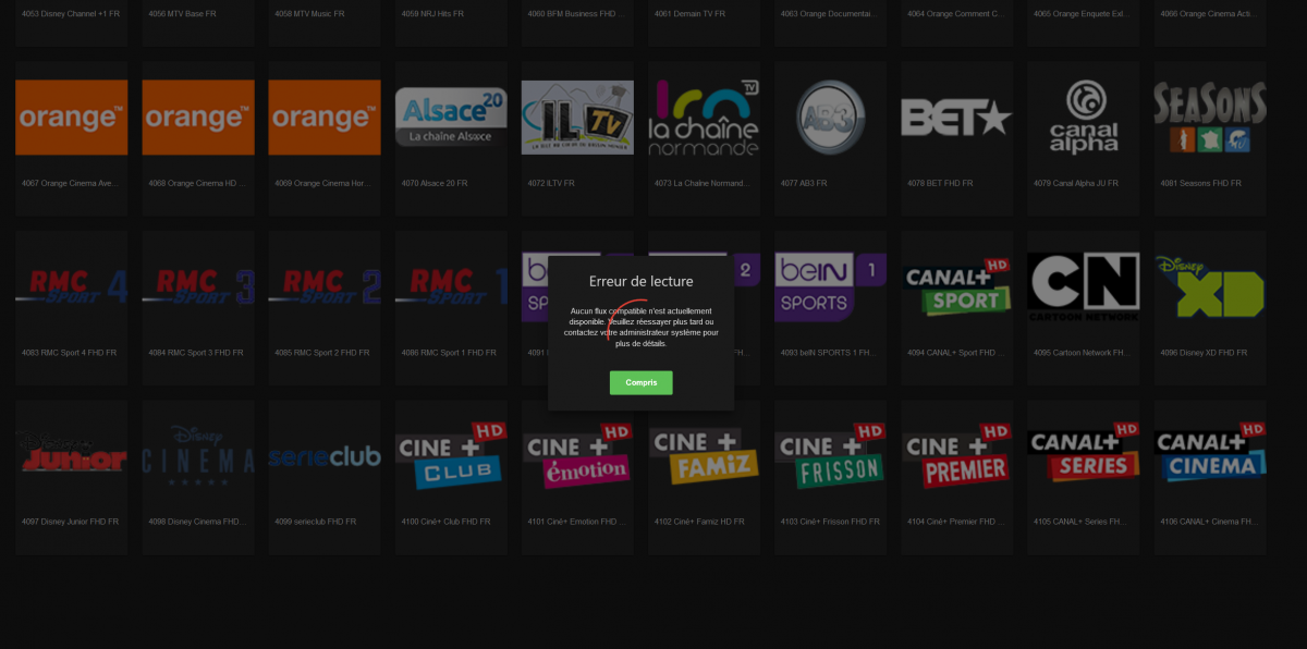

bidikman 0 Posted July 30, 2018 Author Posted July 30, 2018 Instructions on how to do that are in post #6. Thanks. and according to my video I'm doing well?
bidikman 0 Posted July 30, 2018 Author Posted July 30, 2018 (edited) Ok Cant see you are doing anything wrong. Can you please PM/post the complete logs for the time that you last tried to play 424.ts in the video. Krs Mark 2018-07-30 23:19:14.813 Info HttpClient: GET http://seedtk.eu.streamtv.to:8080/live/test24h/zXG4pCcegR/1388.ts 2018-07-30 23:19:14.876 Info HttpClient: Http response 401 from http://seedtk.eu.streamtv.to:8080/live/test24h/zXG4pCcegR/1388.ts after 62ms. HeadersServer=VPZ, Date=Mon, 30 Jul 2018 21:19:14 GMT, Transfer-Encoding=chunked, Connection=keep-alive, Access-Control-Allow-Origin=* 2018-07-30 23:19:14.879 Error App: Error opening tuner 2018-07-30 23:19:14.885 Error HttpServer: Error processing request *** Error Report *** Version: 3.5.2.0 Command line: /opt/emby-server/system/EmbyServer.dll -programdata /var/lib/emby -ffmpeg /opt/emby-server/bin/ffmpeg -ffprobe /opt/emby-server/bin/ffprobe -restartexitcode 3 -updatepackage emby-server-deb_{version}_amd64.deb Operating system: Unix 4.15.0.24 ""018-07-30 23:19:14.879 Error App: Error opening tuner 2018-07-30 23:19:14.885 Error HttpServer: Error processing request *** Error Report ***"" and pouting my video link and good ,,hummm humm Edited July 30, 2018 by bidikman
bidikman 0 Posted July 30, 2018 Author Posted July 30, 2018 (edited) ""Application directory: /opt/emby-server/system System.Exception: ffprobe failed for "http://seedtk.eu.streamtv.to:8080/live/test24h/zXG4pCcegR/424.ts"- streams and format are both null."" it would not come from a problem of video format that would return my stream? streams and format are both null ffprobe failed??? Edited July 30, 2018 by bidikman

bidikman 0 Posted July 31, 2018 Author Posted July 31, 2018 (edited) Bjr I subscribed to an iptv and I would like to watch my channel on Emby but the problem it is impossible to read my m3u8, m3u iptv and the like for my feed link or there is all my bouquet of chain of the same server, I pass by the Plug in on Emby called ip tv nothing happens and the same on the live tv Emby I find it and very capricious Emby on the other hand on VLC everything works nickel. MPEGTS : http://seedtk.eu.streamtv.to:8080/get.php?username=removed&password=removed&type=m3u&output=ts HLS: http://seedtk.eu.streamtv.to:8080/get.php?username=removed&password=removed&type=m3u&output=m3u8 RTMP: http://seedtk.eu.streamtv.to:8080/get.php?username=removed&password=removedtype=m3u&output=rtmp https://youtu.be/xHkpXeoXdl8 log.txt Edited July 31, 2018 by CBers Removed username and password from post.

bidikman 0 Posted July 31, 2018 Author Posted July 31, 2018 ok So windows works but Ubuntu install does not? Weird. Krs Mark The installation of Emby on ubunto works well no problem on it, it is only the iptv and tv-live functions that are not well recognized it generates me errors Stream, more when I put the video on YouTube I was doing the manipulation from the ubunto server.
