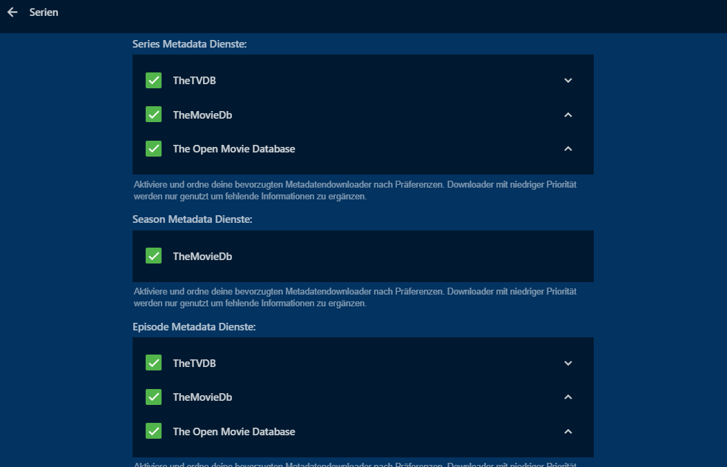

neik 874 Posted July 29, 2018 Author Posted July 29, 2018 Yes, I do have it enabled, see attached screenshot.
