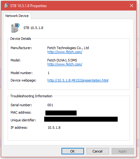

Riples 3 Posted July 24, 2018 Author Posted July 24, 2018 I thought I did. I just used the details from the device properties. I'm not sure how much detail I need to specify in order for Emby to pick up the device. At the moment I have removed everything but the manufacturer URL as Emby states it only requires one property. It would be nice if Emby could detect the device by MAC address. But I have also added model details and serial numbers and it still wasn't detected.
Luke 42238 Posted July 25, 2018 Posted July 25, 2018 Well the dlna profile editor needs a revamp, rather, it needs to be completed. but if you are browsing from the fetch tv, then you will need to also enter identification criteria that uses the http headers.
