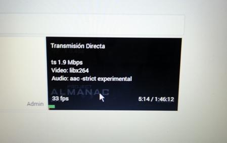

AM S1 1 Posted June 3, 2015 Posted June 3, 2015 (edited) Hi I have this picture from a fire tv stick client, that means video playback is directstreaming(transmision Directa in spanish) with no transcoding at all?? because i concern about the rest of the text: "ts 1.9 Mbps Video: libx264 Audio: aac -strict experimental" If the playback were from my android client, the text just will say "directstreaming" no more Thnks Edited June 3, 2015 by AM S1
