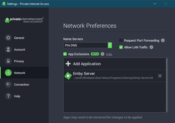

skidmarks 199 Posted October 10, 2019 Posted October 10, 2019 (edited) PIA Now supports split tunneling in version 1.5.1 Verified that i can connect from my cell phone to the server while it is running PIA. Also tested for IP leaks. All looks good. Verify and test to confirm. Its currently a beta addition. Edited October 10, 2019 by skidmarks
