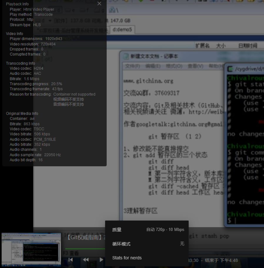

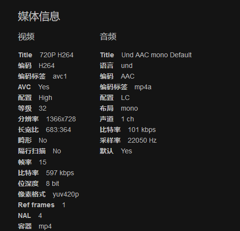

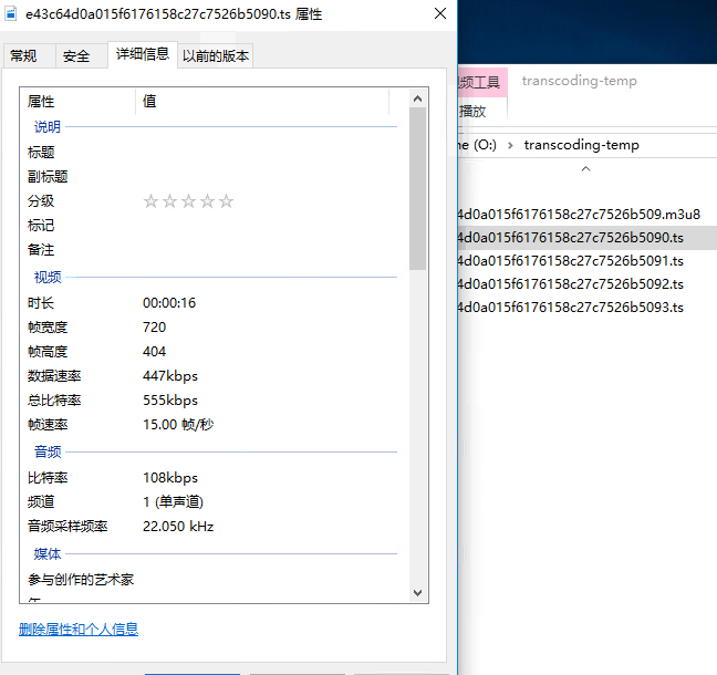

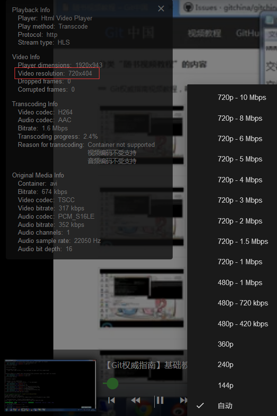

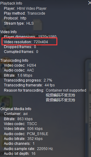

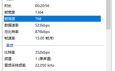

juebanlin 1 Posted July 12, 2018 Posted July 12, 2018 (edited) #############Original information: #################Play information: ############Information after transcoding: #############compare: tscc avi: H264 MP4: Question: 1364x768 ==> 720x404 why???? After the transcoding, the video resolution is correct and clear, but the resolution of the playback process is reduced by half. All the settings I have adjusted, all did not achieve the effect after the transcoding, how to solve this problem, thank you. Video examples in this formathttps://cloud.jueb.net:50006/s/cc7Zd45DAZ2QDNB Edited July 12, 2018 by juebanlin
Luke 42212 Posted July 12, 2018 Posted July 12, 2018 Hi, can you try setting the quality in the video player back to Auto? Thanks.

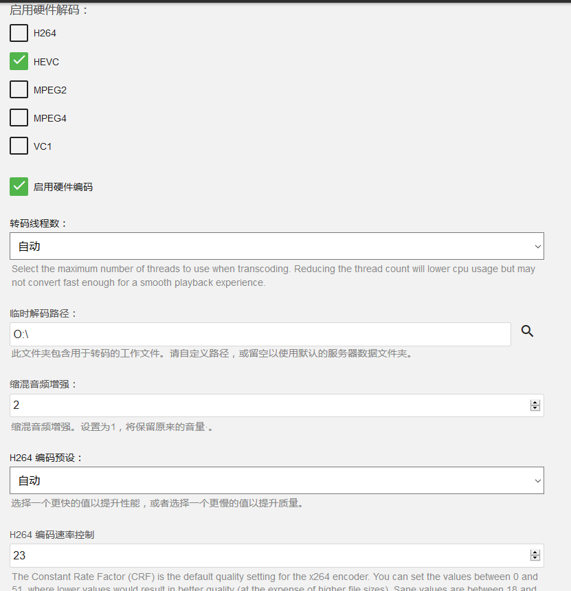

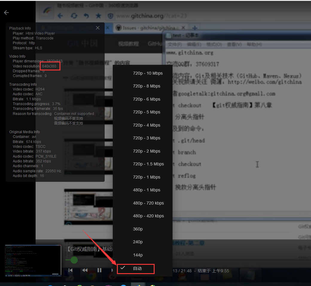

juebanlin 1 Posted July 13, 2018 Author Posted July 13, 2018 (edited) Hi, can you try setting the quality in the video player back to Auto? Thanks. Still do not work,this is my config: I tried all the possible adjustment schemes, which are still vague, and the resolution is still problematic. My browser is Firefox. My server is win10+Quadro P400。 I think the possible reason is that there is something wrong with the resolution of my browser client. But this is limited to TSCC encoding format, the same server configuration, h265 transcoding, the client resolution is no problem. Edited July 13, 2018 by juebanlin

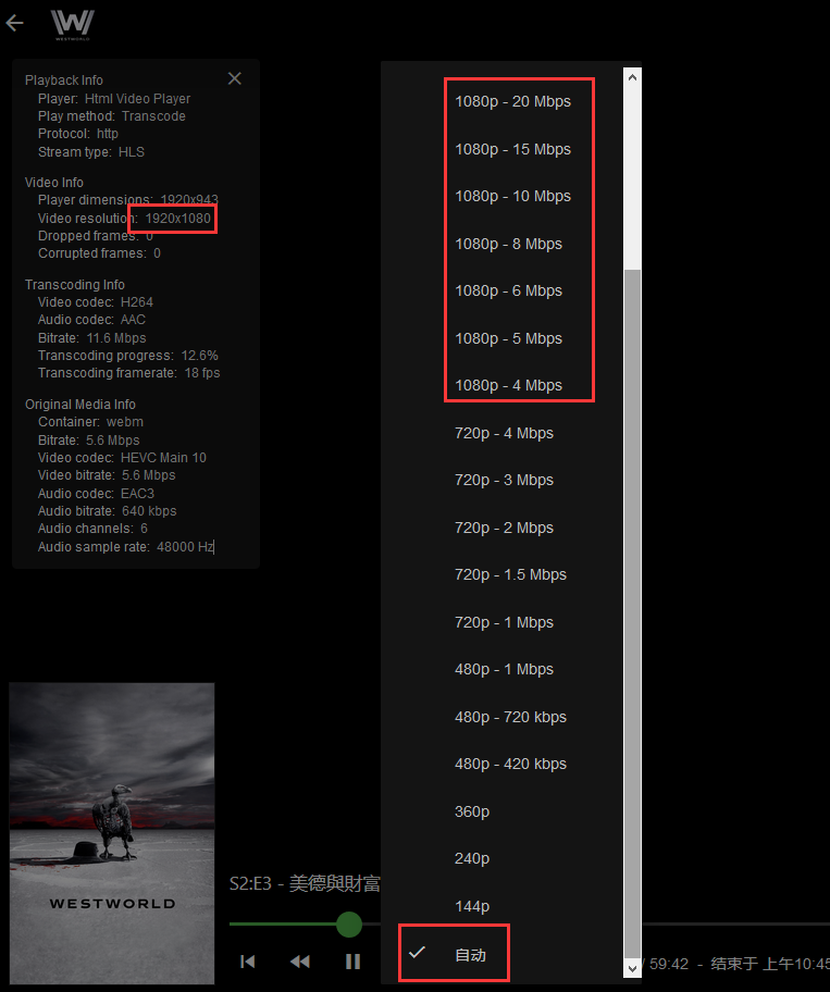

juebanlin 1 Posted July 13, 2018 Author Posted July 13, 2018 (edited) Hi, can you try setting the quality in the video player back to Auto? Thanks. This is the resolution of the client when playing in h265 MKV format.In the same configuration, only TSCC resolution has problems. This is my TSCC coded video: https://cloud.jueb.net:50006/s/cc7Zd45DAZ2QDNB Edited July 13, 2018 by juebanlin

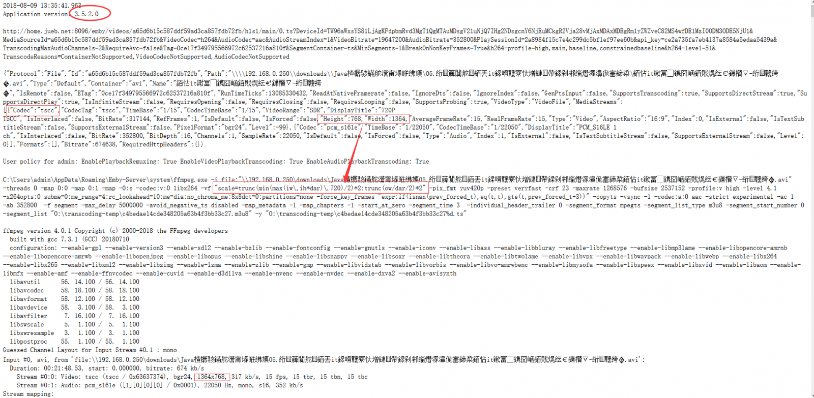

juebanlin 1 Posted August 9, 2018 Author Posted August 9, 2018 Please try again with the next release. Thanks. Did you seriously test the video files I provided? The problem still exists. Please look at the log carefully:
Luke 42212 Posted August 9, 2018 Posted August 9, 2018 Yes i did, but 3.5.2 is the current release. That's not the next release. Please try again with the next major release (3.6+). Thanks.
