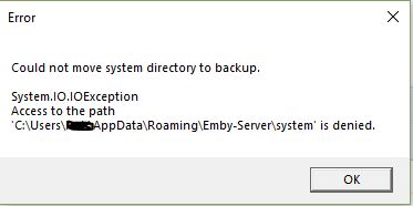

Cybergy 4 Posted July 11, 2018 Posted July 11, 2018 I think I have lost my server that I only just got working yesterday. After having a lot of trouble setting up my m3u channels for some reason, I unstalled and started fresh yesterday. Got all my live TV channels mapped to the Schedules Direct EPG and wanted to make a backup before something went south. So today I installed the backup plugin, restarted the server and that was the last I saw of my server; I could not connect to the dashboard or do anything with the server. So I renamed the Backup plugin.dll assuming that was the culprit and tried to reinstall Emby. Reinstall pops up this error; I assume I have to uninstall completely again. Emby is starting to look like an awful lot of work to maintain after only 2 days...
ebr 16310 Posted July 11, 2018 Posted July 11, 2018 Hi. It looks like you either have a permissions problem in the OS or something is open/running and holding a lock on that folder. Try rebooting the machine.
Cybergy 4 Posted July 11, 2018 Author Posted July 11, 2018 (edited) Thanks for the advice (before I uninstalled again). Seems to be running ok now after a reboot. I still need to backup as I am considering relocating my server to another machine. Is the "Server Configuration Backup" plugin a solid option for config backup? I really only want to save my channel mapping as that is a long and painful process. The wiki suggests the "Emby Backup Plugin" but I see no such plugin in the catalog. Edited July 11, 2018 by Cybergy

Happy2Play 9802 Posted July 11, 2018 Posted July 11, 2018 That message references a Server Update not a plugin update. What server version number are you on.
Cybergy 4 Posted July 11, 2018 Author Posted July 11, 2018 @@Happy2Play - I'm on the current version - just installed it yesterday (3.4.1.0) @maegibbons - Thanks, I found your post already today and was quite happy the way the mapping worked once I edited the channel numbers. I'm not sure what to do when the stream/channel I want to add to Emby is not offered by the schedule provider I have chosen, but this is a minor issue for me right now.
