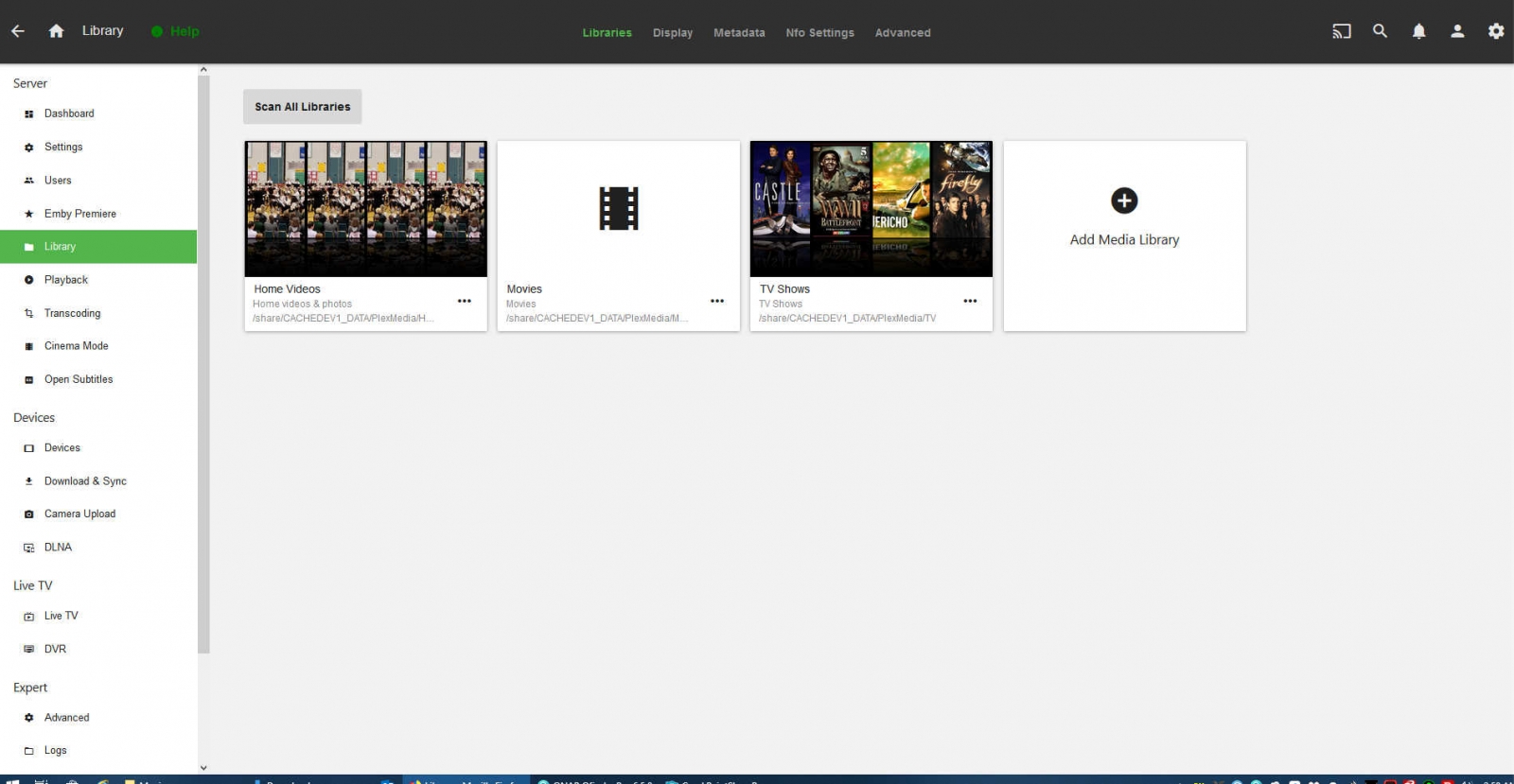

Luke 42240 Posted July 8, 2018 Posted July 8, 2018 Can you show screenshots of what your emby library setup screen looks like? i'd like to see all of the libraries. thanks.
Chuck_IV 1 Posted July 8, 2018 Author Posted July 8, 2018 This? At the time of the screenshot, the movie library was readded and being rebuilt(thus no poster yet for the library)...
