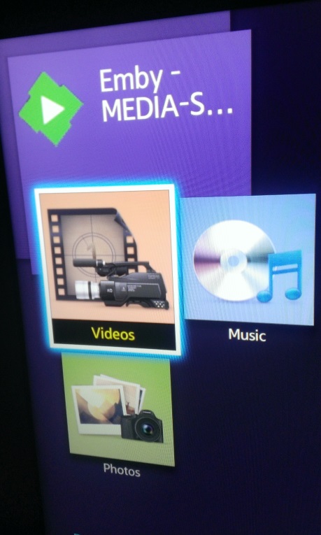

FrostByte 5437 Posted July 12, 2018 Posted July 12, 2018 (edited) I'm seeing the same thing as @Vlada on my 2014. I can see three folders But when I click on any of them I see something like this: My settings are: This has worked in the past, it's just been a very long time since I tried because of course I prefer the app. Edited July 12, 2018 by FrostByte 1
FrostByte 5437 Posted July 12, 2018 Posted July 12, 2018 (edited) FYI it's just my Orsay TV which no longer works with DLNA. My 2018 Tizen works fine. Edited July 12, 2018 by FrostByte 1
Luke 42212 Posted July 12, 2018 Posted July 12, 2018 Yea i think there is an issue on older Samsungs. Thanks.
Vlada 1 Posted July 16, 2018 Author Posted July 16, 2018 @@FrostByte - Yes, this is the situation I get on my Samsung TV. And it seems there is really a problem inside the TV and not Emby, because the DLNA browsing through Emby server files is working perfectly on my OPPO Bluray player. Dammed Samsung. It was working a few months ago. Thanks for help.
