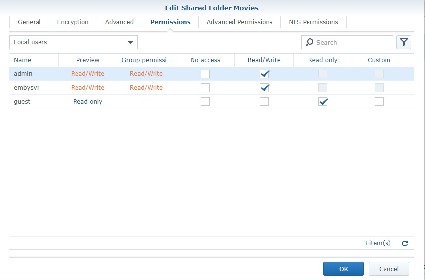

rouq 23 Posted July 5, 2018 Posted July 5, 2018 Did you give read access to embysvr user? This user own emby server process and need at least read permission to your share folders.
scouser1023 0 Posted July 5, 2018 Author Posted July 5, 2018 Hi Rouq, Yes the shared folder on the nas has read/write access for admin and embysvr. Thanks, Simon

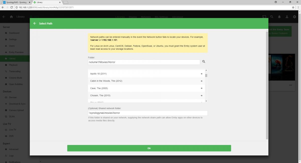

scouser1023 0 Posted July 5, 2018 Author Posted July 5, 2018 When making the libraries in the emby server I can browse to the local directory and it populates all the movie folders, the issue seems to be on the client side gaining access. I thought this was a function of the path substitution which is why I tried UNC pathing for both the directory and path substitution. I am wondering if I need something set in my router like port forwarding or something.
scouser1023 0 Posted July 5, 2018 Author Posted July 5, 2018 I forgot to mention I did try: \\synologynas\videos\horror\ and \\synologynas\videos\horror with the same result

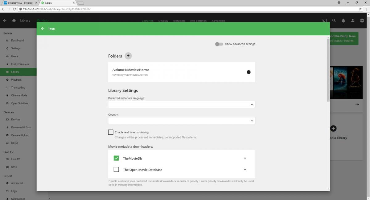

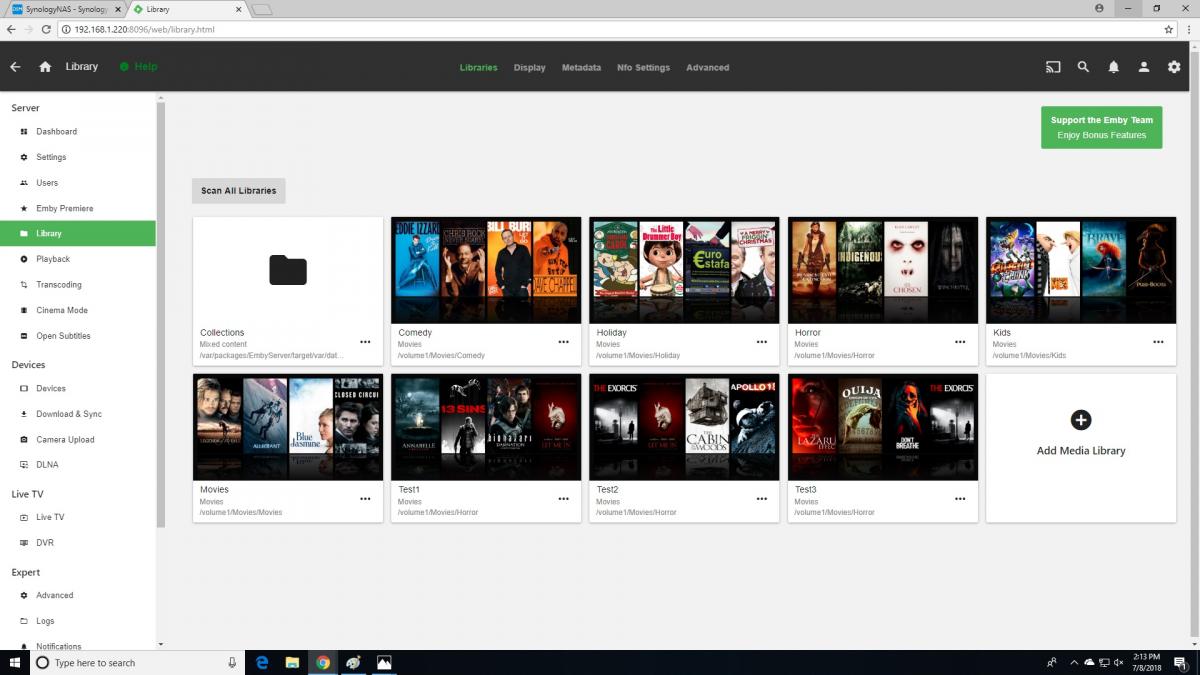

Luke 42241 Posted July 8, 2018 Posted July 8, 2018 hi @@scouser1023, can you show us what your emby library setup looks like, perhaps a screenshot? thanks.
scouser1023 0 Posted July 8, 2018 Author Posted July 8, 2018 Hi Luke, Thank you for the help. I have attached some screen shots. All of the libraries seem to be acting the same, it basically hangs as I don't think the transcoding can handle bluray content. I do have it set up for and external player VLC, VLC is not opening which lead me to the logs and concluding direct play is not working. The same windows client was working fine with a windows VM emby server. On the client I have removed emby and tried both the beta and stable versions without any success. Everything other than direct play looks normal on the client. Share folders - Synology permissions Shares - Permissions in subfolders, same as admin permissions Test1 - Normal suggested pathing Test2 - Remove the final \ from the unc pathing and used IP address Test3 - Removal of the \ from the unc pathing File explorer - showing DNS resolution and IP pathing in windows Lib set up - Creating a lib Lib - Screen shot of the completed scan and libaries Dashboard - Showing everything looking normal...I think I will grab some screenshots from the client shortly. Did you see anything in the logs that did not look right? And is there anything specific you would like a screenshot of? Thank you! Simon

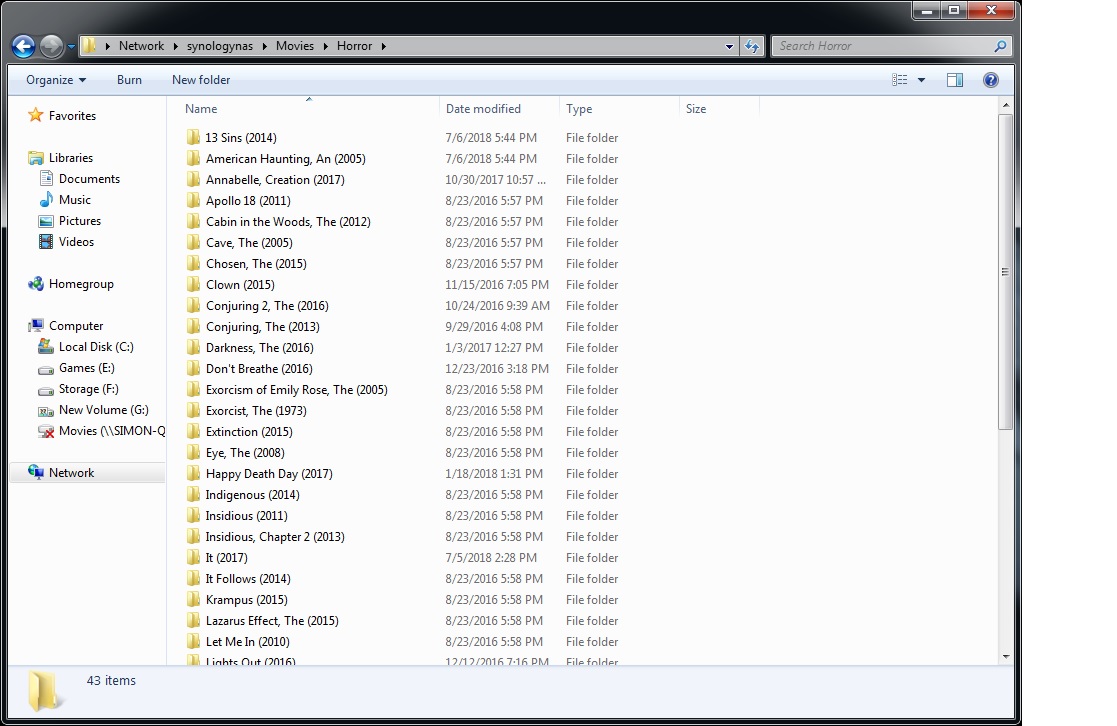

scouser1023 0 Posted July 8, 2018 Author Posted July 8, 2018 (edited) Hi Luke, Apparently I can not take a screen shot of the WMC Emby client. When I open it, it allows me to log in, then the libraries match whats on the server. I can click on a library and see all the content of which loads quickly. When i click on play on any of the test libraries it throws an error saying it can not locate the media... If I close the client and log back in and choose any movie from the 3 test libraries all give the same error message, can not locate the media. Attached is a screenshot of file explorer on the client. How does emby access the network media? And why can it access it to stream but not for direct play? Seems like I am missing access or permissions on a protocol. I tool a look through the windows services on the client but I did not see anything that emby would be using. Thank you! P.S. I downloaded the ios client yesterday and paid for the steaming option, that is quite impressive. Edited July 8, 2018 by scouser1023
Luke 42241 Posted July 8, 2018 Posted July 8, 2018 when you browsed with the file explorer on the client, did you have to enter network credentials in order to do that?
scouser1023 0 Posted July 8, 2018 Author Posted July 8, 2018 Yes, and selected it to save credentials. The account user name and password on my win pc and symbology nas are the same. However I am not sure hiw this plays with the Emby bad account. What is the typical? Thank you.
Luke 42241 Posted July 8, 2018 Posted July 8, 2018 Ok so that's going to be the problem. You need to make sure the network share is accessible anonymously. Emby for WMC doesn't have these credentials and there's no configuration for you to enter them. So the only way it will be able to reach folder is via anonymous share. If you don't want to do that, then yes, content will stream through emby server and not over the lan file interface but that should work just fine.
