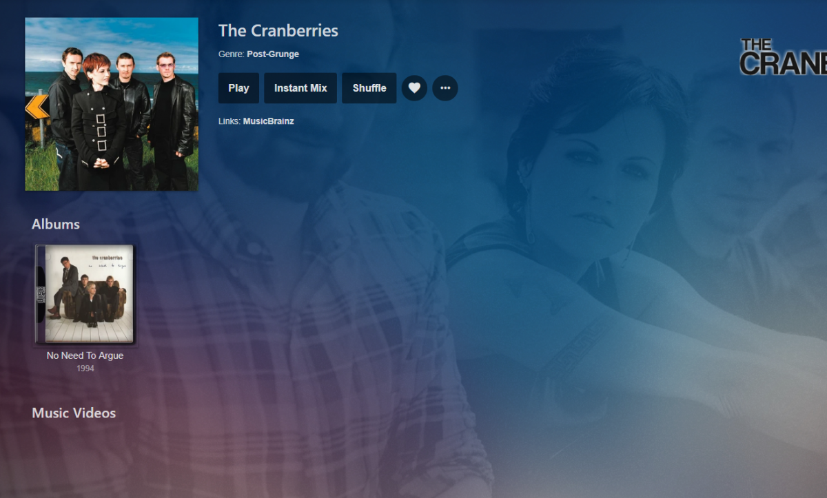

aahmyu 9 Posted July 5, 2018 Posted July 5, 2018 Hello, I'm trying to add some music videos to the library and i'm facing 2 problems. the first one the music video is not appearing in the artist page even when having the same artist. I only see the heading Music Videos and nothing under it. the second issue is identifying the music video is not working even when adding the imvdb id there are no search results at all.

aahmyu 9 Posted July 6, 2018 Author Posted July 6, 2018 Logs and screenshot attached. and for imvdb you can try searching for anything and there will be no results at all. Log.txt

aahmyu 9 Posted July 6, 2018 Author Posted July 6, 2018 I have the same issue - and from what I can tell it all comes down to the metadata - It seems that unless the music video file has the correct artist name in the metadata, it will not be associated with the artist. For me, I thought my metadata was fine - but if I go to the Emby metadata editor for the music video - the artist name is blank - put that in and then save and then navigate to the artist under music and the video appears there... I already checked the artist name and its fine. the thing is if the video has the wrong artist name the "Music Videos" section in the artist page wont be there. but as you can see from the screenshot its there but empty.
aspdend 177 Posted July 6, 2018 Posted July 6, 2018 I already checked the artist name and its fine. the thing is if the video has the wrong artist name the "Music Videos" section in the artist page wont be there. but as you can see from the screenshot its there but empty. That's what I had - the Music Videos section was there but empty - not until I added the name to the metadata did it then appear

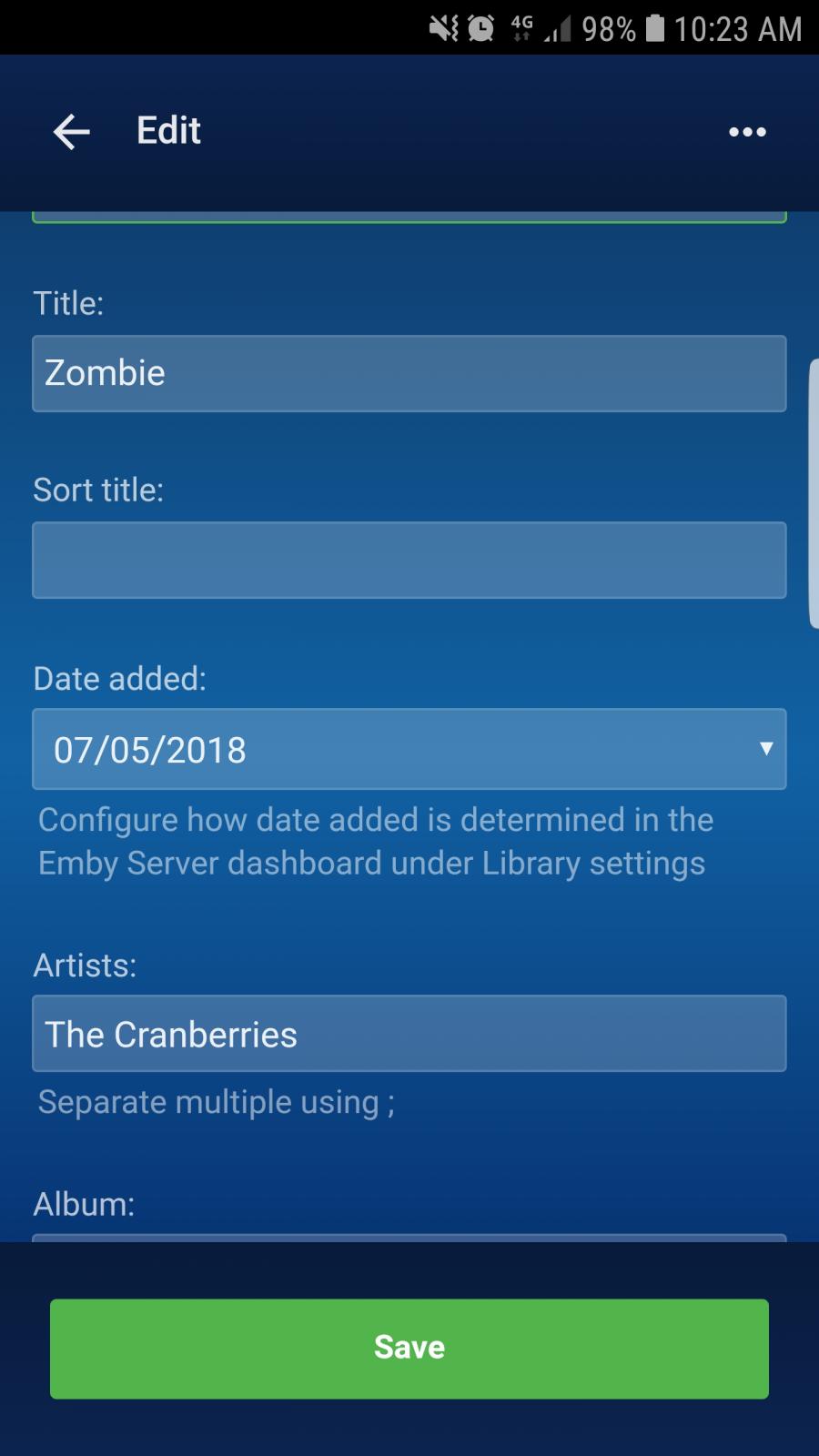

aahmyu 9 Posted July 6, 2018 Author Posted July 6, 2018 There you go, it has the same artist name as the artist. But I still can't see it there.
PenkethBoy 2068 Posted July 6, 2018 Posted July 6, 2018 Music Video - Artist names metadata are correct for me and they dont show - so i see the same as s/s in post #4

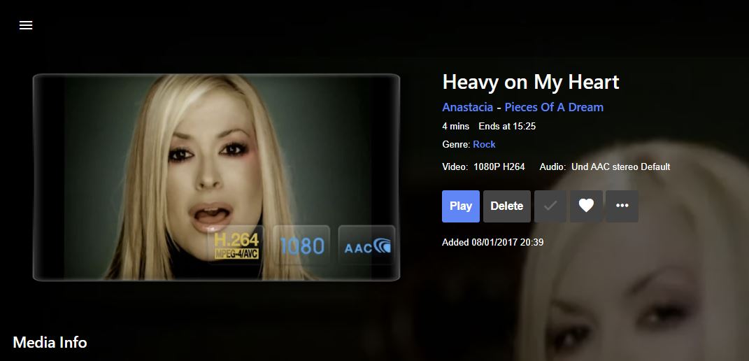

PenkethBoy 2068 Posted July 6, 2018 Posted July 6, 2018 (edited) @@Luke - Just spotted something that might explain the issue Using Anastacia as an example - you can see i have added metadata and filled in Artist and Album for this video what i noticed was that clicking on Anastatic (Artist) - works as it goes to her artist page BUT if you click on the "Pieces Of a Dream" the url generated by Emby is partly undefined /itemdetails.html?id=undefined&serverId=5fc81c140c6946c7b79f4f95f0594dc5 I have check this with several videos and different artists and its the same And i have checked the spelling of the album - its the same even down to the case of the letters - not that that should matter. If the "Album" metadata is "undefined" and does not have an ID - that might be why the Album page has no Music Videos displayed This is on the Stable Server - On BETA the Album name is not a clickable link - so essentially the same result Sorry forgot i did not have Anastacia music on my Beta server just the Music Videos Adding the Music to BETA made the Music Video Album link clickable (so its finding the music album via the metadata) but the url has "undefined" in it like Stable - so its the same result Edited July 6, 2018 by PenkethBoy
Luke 42213 Posted July 8, 2018 Posted July 8, 2018 Logs and screenshot attached. and for imvdb you can try searching for anything and there will be no results at all. It doesn't look like imvdb was ever searched. Did you check your settings for that emby library to make sure that imvdb is enabled?
Luke 42213 Posted July 8, 2018 Posted July 8, 2018 @@PenkethBoy, thanks, so we'll remove the album link in that situation.
PenkethBoy 2068 Posted July 8, 2018 Posted July 8, 2018 (edited) No dont do that - you have already created a lookup to match the name of the album within emby Just get it to link to the album page as was intended whenyou added this originally Removing stuff is not the way to go!!! I and i assume others want my MusicVideos linked to the Albums and vice versa Checking the server data - the Album exists and emby will return the correct ID - you are just not putting into the url - SO ITS a BUG Edited July 8, 2018 by PenkethBoy 1
Spaceboy 2573 Posted July 8, 2018 Posted July 8, 2018 @@PenkethBoy, thanks, so we'll remove the album link in that situation.please don’t do that Luke
Luke 42213 Posted July 8, 2018 Posted July 8, 2018 Nothing is being removed, i'm only saying that it should only display a link if there is a linked AlbumId in the database. Otherwise it should just be plain text with the album name.
PenkethBoy 2068 Posted July 8, 2018 Posted July 8, 2018 Good But the data (ID) is in the database (i checked) - its the internal lookup that appears to be failing
