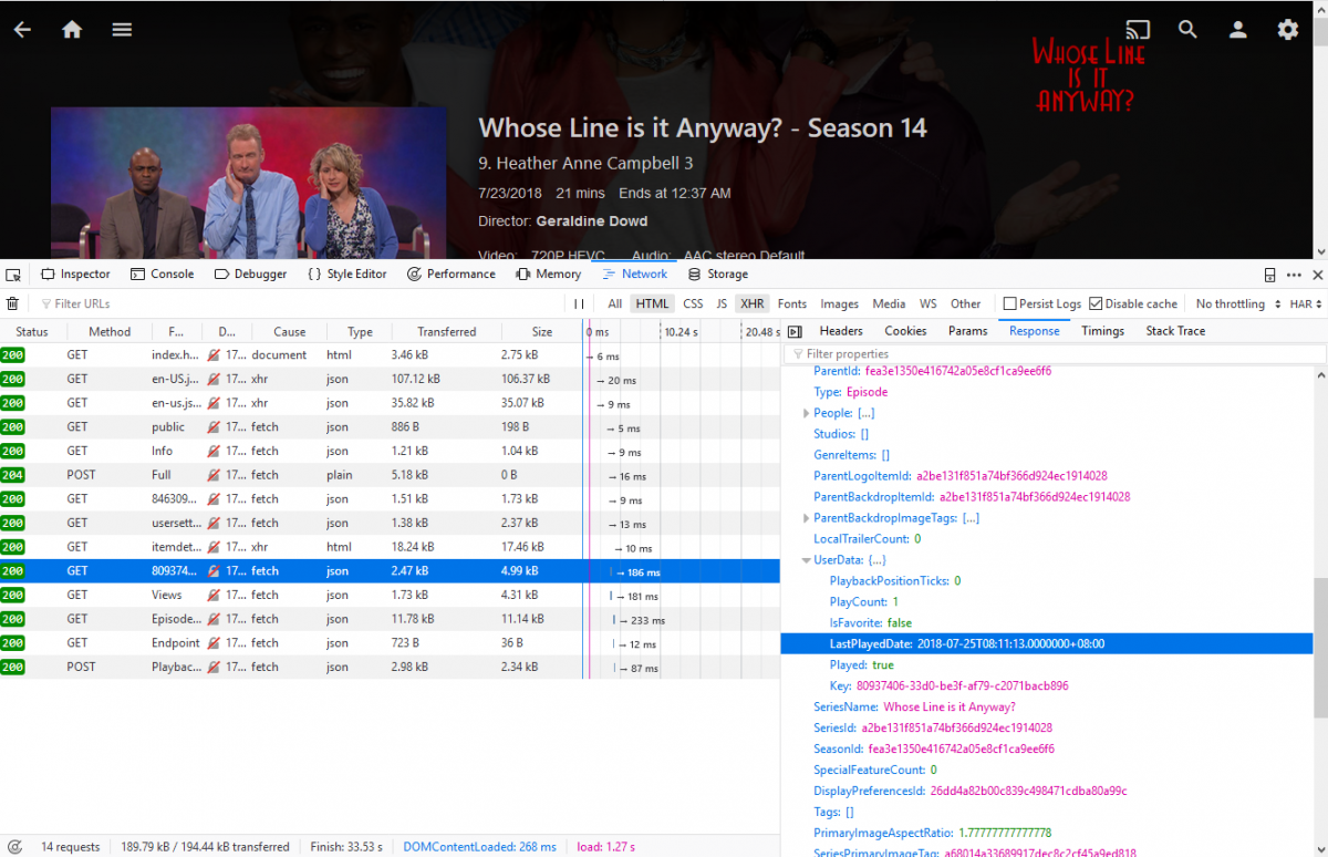

quekky 0 Posted July 5, 2018 Posted July 5, 2018 When I manually mark a movie/episode as watched, I notice that trakt reports the wrong timing. My guess is the UTC timing is off, I stay in UTC+8. Eg I manually mark an episode at 5-Jul 10:32pm, but at trakt it shows that I watched it at 6-Jul 6:32am. Seems to me the DB could be updated wrongly. When I do a query to http://emby_ip:8096/mediabrowser/Users/xxxx/Items?parentId=yyyy (where yyyy is the show season id), I got this: .... }, { "Name": "Greg Proops 1", "ServerId": "004081ff8ade482b86d51d60bf61330c", "Id": "6bc8d08df90c49d315f6bbb5cbea04d3", "HasSubtitles": true, "Container": "mkv,webm", "PremiereDate": "2018-07-01T16:00:00.0000000Z", "RunTimeTicks": 12508680192, "ProductionYear": 2018, "IndexNumber": 6, "ParentIndexNumber": 14, "IsHD": true, "IsFolder": false, "Type": "Episode", "ParentLogoItemId": "a2be131f851a74bf366d924ec1914028", "ParentBackdropItemId": "a2be131f851a74bf366d924ec1914028", "ParentBackdropImageTags": ["b6120fb29fe5bb10dd888d79c61d9dcb"], "LocalTrailerCount": 0, "UserData": { "PlaybackPositionTicks": 0, "PlayCount": 1, "IsFavorite": false, "LastPlayedDate": "2018-07-06T06:32:38.0000000+08:00", "Played": true, "Key": "76808014006" }, "SeriesName": "Whose Line is it Anyway?", "SeriesId": "a2be131f851a74bf366d924ec1914028", "SeasonId": "fea3e1350e416742a05e8cf1ca9ee6f6", "SeriesPrimaryImageTag": "a68014a33689917dec8c2cf45a9ed818", "SeasonName": "Season 14", "VideoType": "VideoFile", "ImageTags": { "Primary": "1b239f433824dcc60fc5dc373c2140cd" }, "BackdropImageTags": [], "ParentLogoImageTag": "c20b93360e8f8564b27420545fa536e2", "ParentThumbItemId": "a2be131f851a74bf366d924ec1914028", "ParentThumbImageTag": "587f2cf5cffe7d8e1412900719be7d1d", "LocationType": "FileSystem", "MediaType": "Video" }], ....

quekky 0 Posted July 24, 2018 Author Posted July 24, 2018 (edited) same for series: 2018-07-25 00:11:15.708 Info HttpServer: HTTP POST http://172.23.217.61:8096/emby/Users/846309c5b13a47b6894ec08286160f83/PlayedItems/8093740633d0be3faf79c2071bacb896?DatePlayed=20180725001113. UserAgent: Mozilla/5.0 (Windows NT 10.0; Win64; x64; rv:61.0) Gecko/20100101 Firefox/61.0 2018-07-25 00:11:15.715 Info HttpServer: HTTP Response 200 to 172.23.217.56. Time: 7ms. http://172.23.217.61:8096/emby/Users/846309c5b13a47b6894ec08286160f83/PlayedItems/8093740633d0be3faf79c2071bacb896?DatePlayed=20180725001113 2018-07-25 00:11:17.672 Info HttpServer: HTTP GET http://172.23.217.61:8096/emby/System/Logs/Log?name=server.txt. UserAgent: Mozilla/5.0 (Windows NT 10.0; Win64; x64; rv:61.0) Gecko/20100101 Firefox/61.0 2018-07-25 00:11:17.677 Debug HttpResultFactory: Transmit file /var/packages/EmbyServer/target/var/logs/server.txt 2018-07-25 00:11:17.679 Info HttpServer: HTTP Response 200 to 172.23.217.56. Time: 7ms. http://172.23.217.61:8096/emby/System/Logs/Log?name=server.txt 2018-07-25 00:11:17.954 Info HttpServer: HTTP GET http://172.23.217.61:8096/favicon.ico. UserAgent: Mozilla/5.0 (Windows NT 10.0; Win64; x64; rv:61.0) Gecko/20100101 Firefox/61.0 2018-07-25 00:11:17.956 Info HttpServer: HTTP Response 304 to 172.23.217.56. Time: 1ms. http://172.23.217.61:8096/favicon.ico 2018-07-25 00:11:20.789 Debug Trakt: {"shows":[],"episodes":[{"watched_at":"2018-07-25T08:11:13Z","ids":{"tvdb":6754141}}]} you can see that I clicked it at 00:11AM (+8), yet it's sent to trakt that it's 08:11AM UTC. That's 16 hours ahead Edited July 24, 2018 by quekky
quekky 0 Posted July 24, 2018 Author Posted July 24, 2018 lastplayeddate in the database is also showing as 8AM
