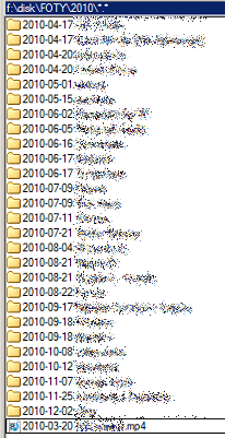

  3. the "2010" folder contains folders and a single video. It is reported as path: F:\disk\FOTY\2010\2010-03-20 xxxxxx.mp4 and type: Video
Note: the "2010" folder also contained a file "2010-03-20 xxxxxx.nfo" but I deleted it and restarted emby server and nothing changed when listing the top folder via rest or webapp.

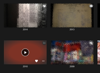

This is part of the screen:
The "2010" is now red because I've just added a jpg to that folder and started reindexing. But five minutes ago there was a thumbnail of the video and there was (and still is) a play button (I have the folder hovered with mouse) that just started the video.
Update: Emby is now at 95% of the reindexing and the red changed to some thumbnail. The play button is still there but after clicking I can finally browse the "2010" folder, yippiiey :D

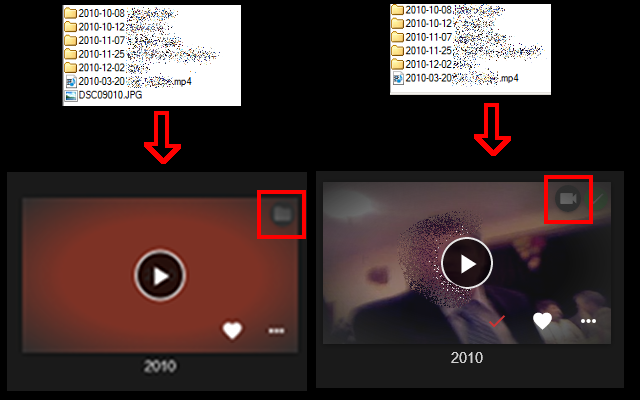

No, I only found a workaround for a "video instead of folder" problem. Both web app and rest api work the same depending if there is a video or video+sth else in the folder:
It looks like there is a bugged feature in emby:
  1. the feature is that when emby detects that a folder contains a video only and no images (but perhaps subtitles?) then it replaces the folder with direct link to the video. This saves the user an additional click and a bit of waiting time.
  2. the bug is that this feature does not detect if there are folders on the same level as the video.
