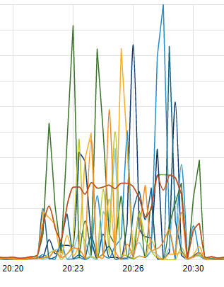

During a library scan, playback on my Fire Tv will pause - not actually pause, meaning there is no OSD pop up, it just stops and sits there for 30 seconds or more.
During that time, the web UI will not load.
If I am watching everything, this happens at around 69% of the library scan.
I've seen this on direct play, direct stream and transcoding.
CPU usage does jack up to 50% during the can at points for most CPUs (8 total cores running) and a few spike to 100% but not all... maybe 2 or 3.
Attached is my log from right now.
the time to look at is in-between 20:25 and 20:27 on 6/29/2018 while I was watching GLOW S2E3. The title is direct playing according to the dashboard.

last edit to include CPU graph during the time of the scan
