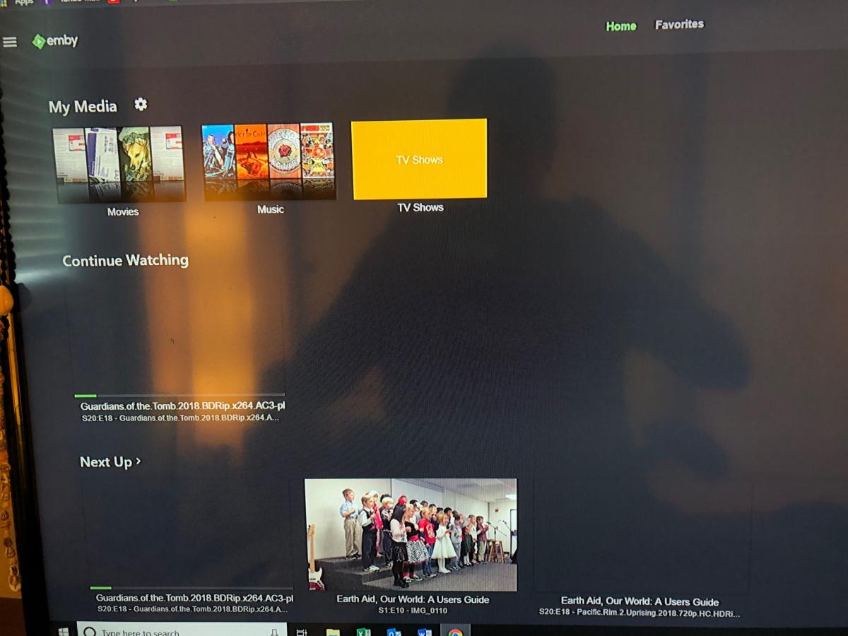

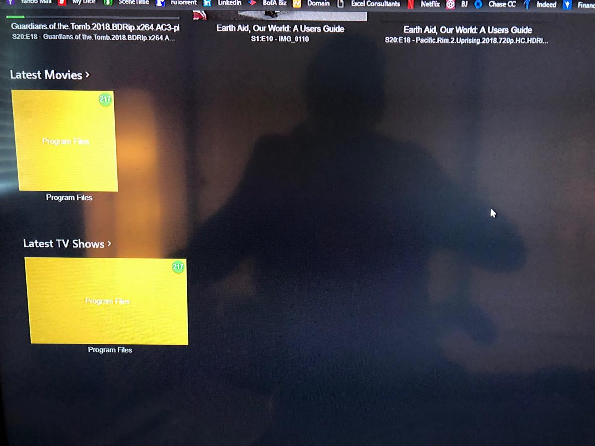

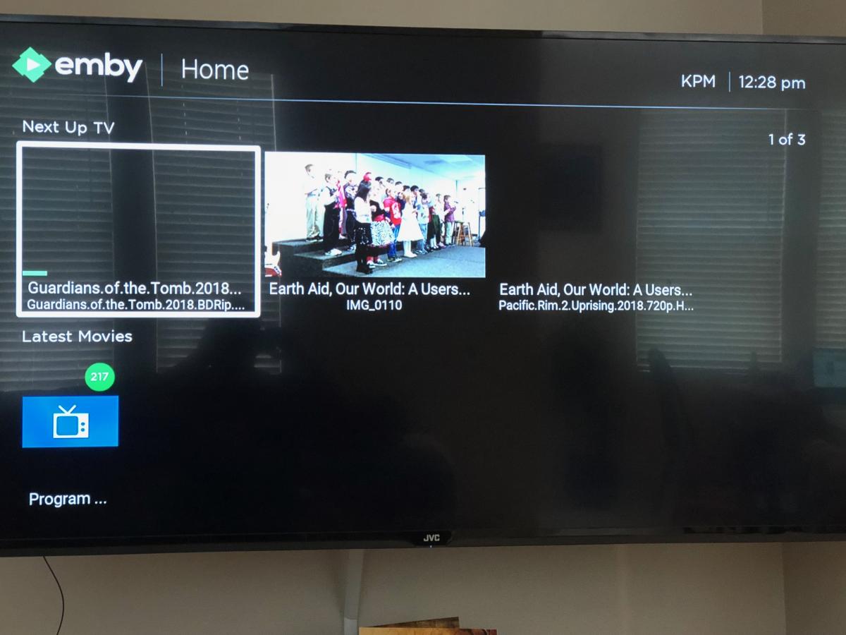

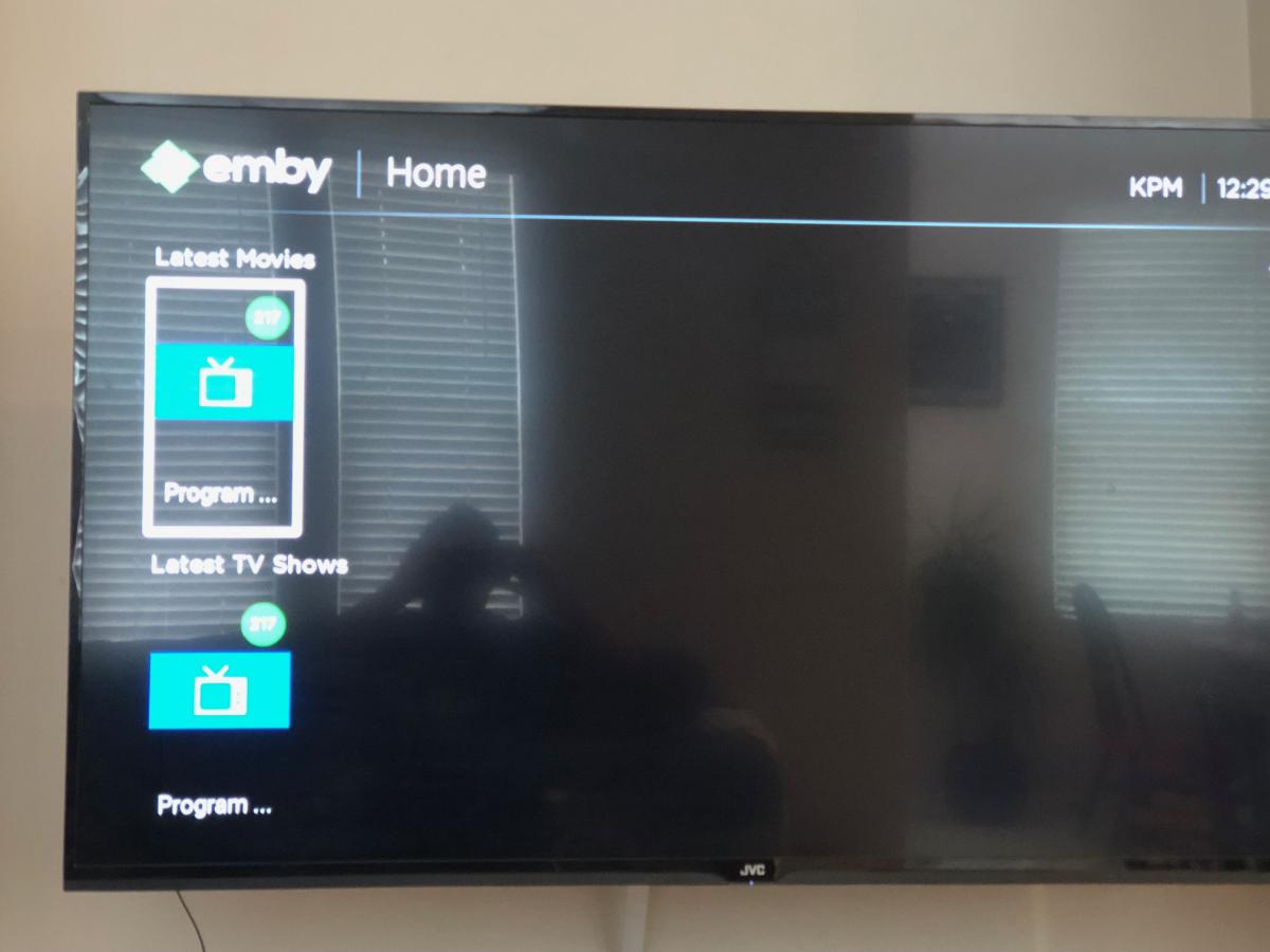

nofx2017 0 Posted June 21, 2018 Posted June 21, 2018 (edited) I still have not been able to figure out how to make my emby/roku work correctly... On my pc, it shows paths correctly: c/videos (for movies) and f/media for more movies... On tv emby app, it shows nothing relevant... On my tv, it shows program files... as in my pc sys files. Here are a couple pics of what my pc displays as well what my tv roku emby app displays if that would help. Thank you for your input! just noticed that i forgot to mention - if i click on movies or tv shows, etc, it's just blank Edited June 21, 2018 by nofx2017
Luke 42243 Posted June 21, 2018 Posted June 21, 2018 Hi there can you show us a screenshot of your emby library setup? thanks !

Luke 42243 Posted June 21, 2018 Posted June 21, 2018 The problem is you added your entire c: drive as a music library. Please try removing that, then add back your actual music folders, and let the library scan. Once it has completed, then try restarting the roku app. thanks.
