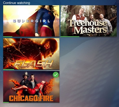

Diedrich 380 Posted June 20, 2018 Posted June 20, 2018 (edited) Why have we recently been getting a Watched status at low percentages? It should be at least 90%, in my opinion. Edited June 20, 2018 by Diedrich

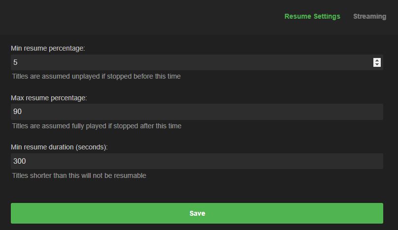

CBers 7544 Posted June 20, 2018 Posted June 20, 2018 Why have we recently been getting a Watched status at low percentages? It should be at least 90%, in my opinion. Change the settings in the PlayBack page in the Dashboard.
Diedrich 380 Posted June 20, 2018 Author Posted June 20, 2018 Change the settings in the PlayBack page in the Dashboard. Yup, I'm showing the same numbers as you 5/90/300, still got the Watched icon as pictured above.

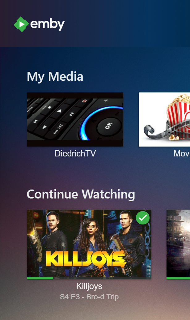

Diedrich 380 Posted October 4, 2018 Author Posted October 4, 2018 (edited) Did the episode appear in Next Up before you started it? Was there a check on it at that point? Does it show exactly the same in the web app? Forgot to answer your first question. I only have Latest TV, not Next Up showing No. No check mark when showing as Next Up. Yes. I checked that too to see if it was propagating to other apps. My suspicion is that it's an issue with ET marking it as watched and sending that signal to Server. It's showing in my Android app too. Edited October 4, 2018 by Diedrich
